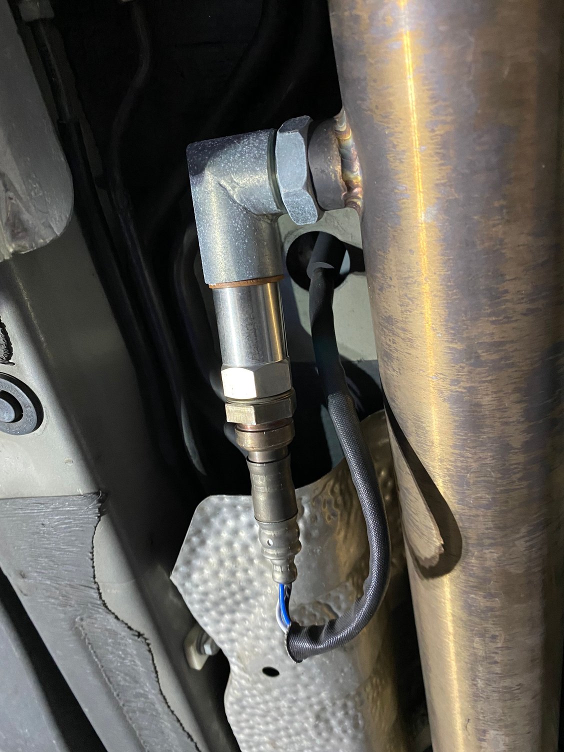

Open the ECU box to see if an O2 simulator is installed. I had this same issue. There was one poorly wired in. They don’t work great regardless. If there is one… Get rid of it, order some PPE O2 simulator extensions. They are L shaped spacers that go in the exhaust. Clear the codes and enjoy.

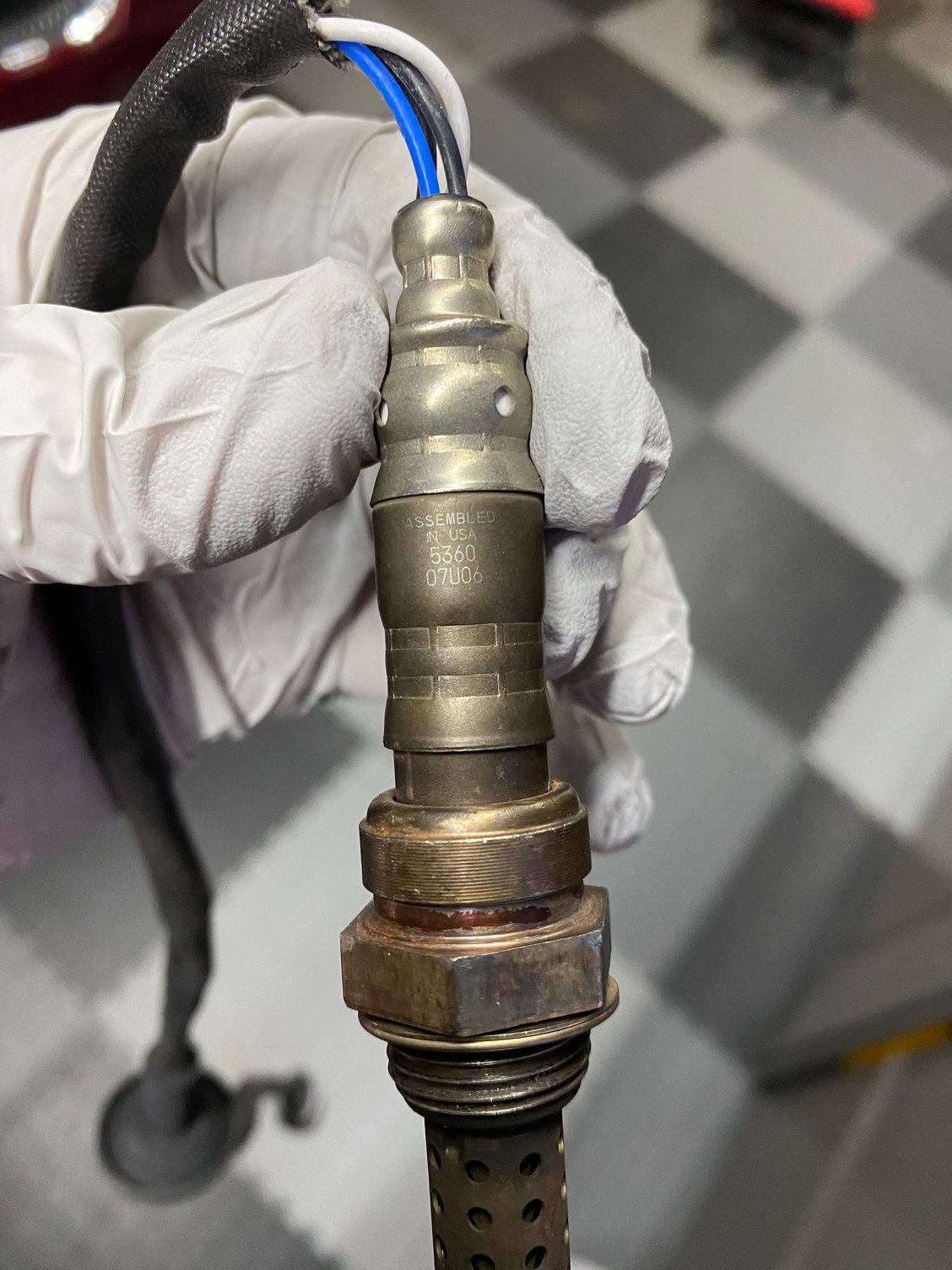

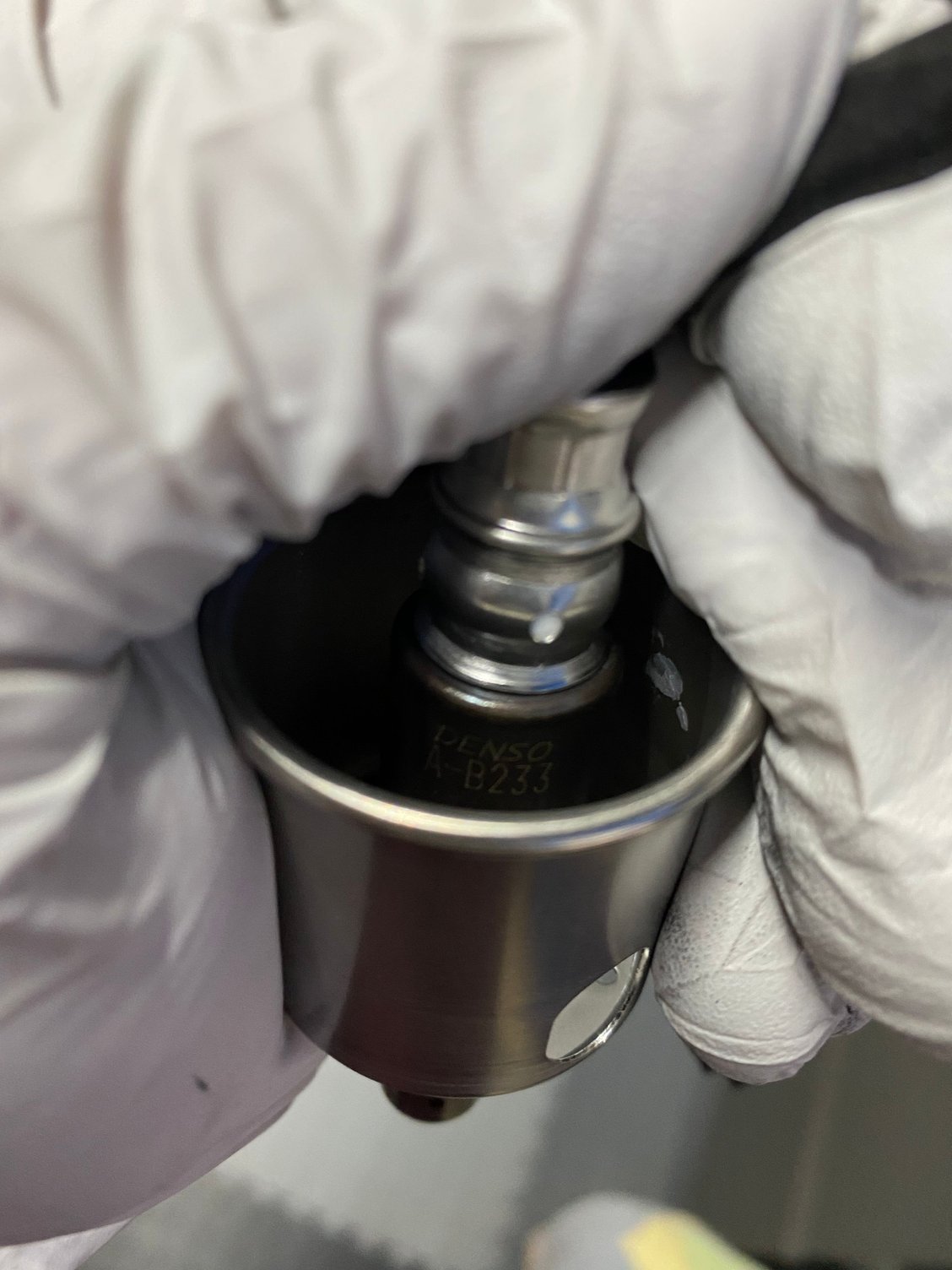

My car originally had a P0159 when I bought it (unbeknownst to me, randomly came on), indicating a delayed signal. We traced that back to a bad wiring job on a CEL eliminator. During that process, I went in to autozone and ordered an oem O2 sensor and installed it. I thought it was odd that it didn’t have a little heat shield on it.

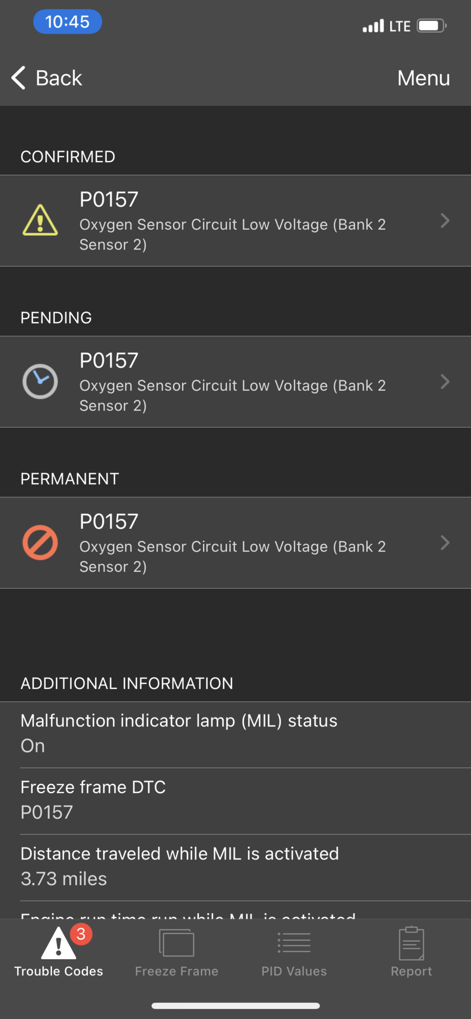

Every thousand miles are so, I’d get a P0157, which means the voltage was low. Then it started happening all the time. I parked my car due to a remodel and busy life.
I finally addressed this today. It doesn’t look like I had the correct sensor. I can’t tell what unit it is via internet searches. But the Denso unit looks different and says Denso right on the side.
Oem Denso unit from Rock Auto
Autozone unit. No shield. Part 5360 07U06.
Any ideas what brand this sensor is?

So my P0157 fun continues today. I made it about 200 miles. So far I’ve replaced the sensor, made sure there were no twists in the wires, and replaced the header to mid pipe gasket. Any ideas what else the issue could be? This has been a bit of a frustration.
