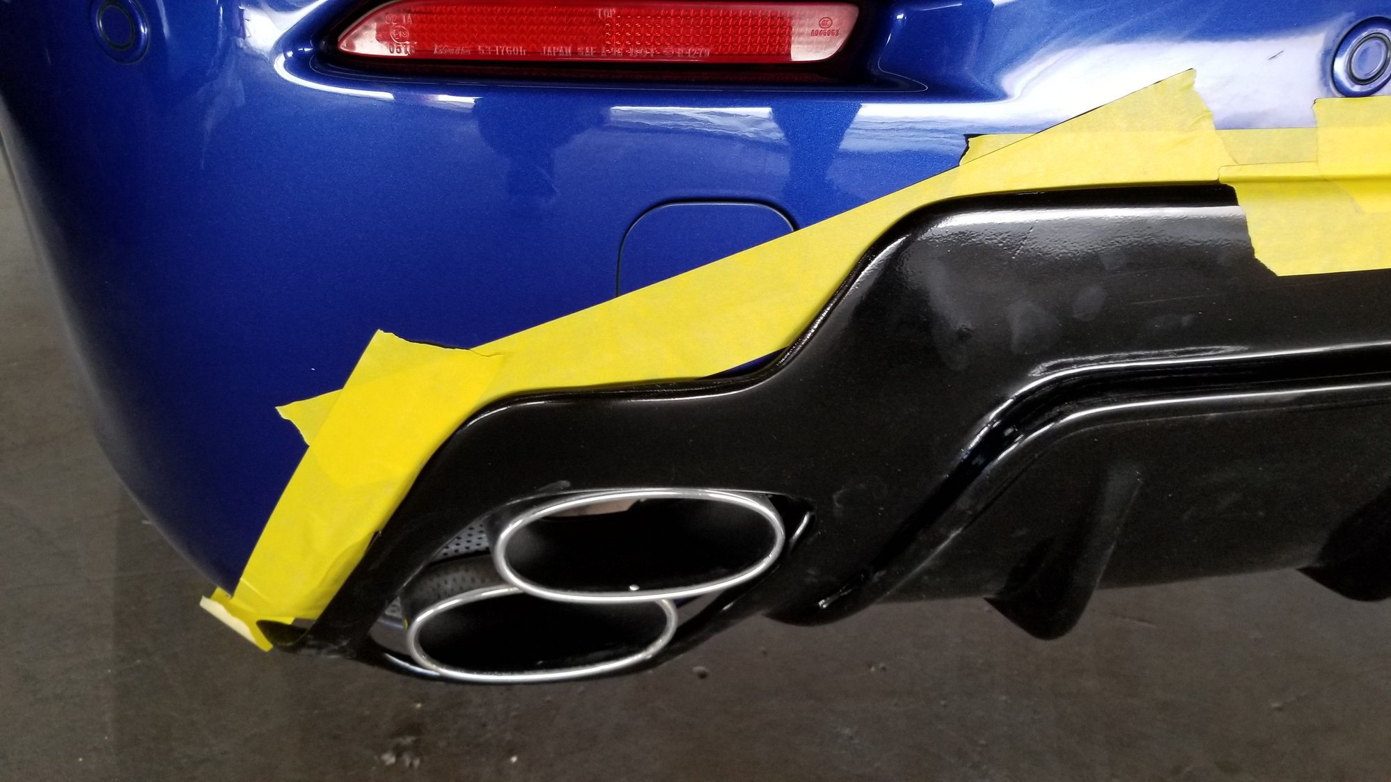

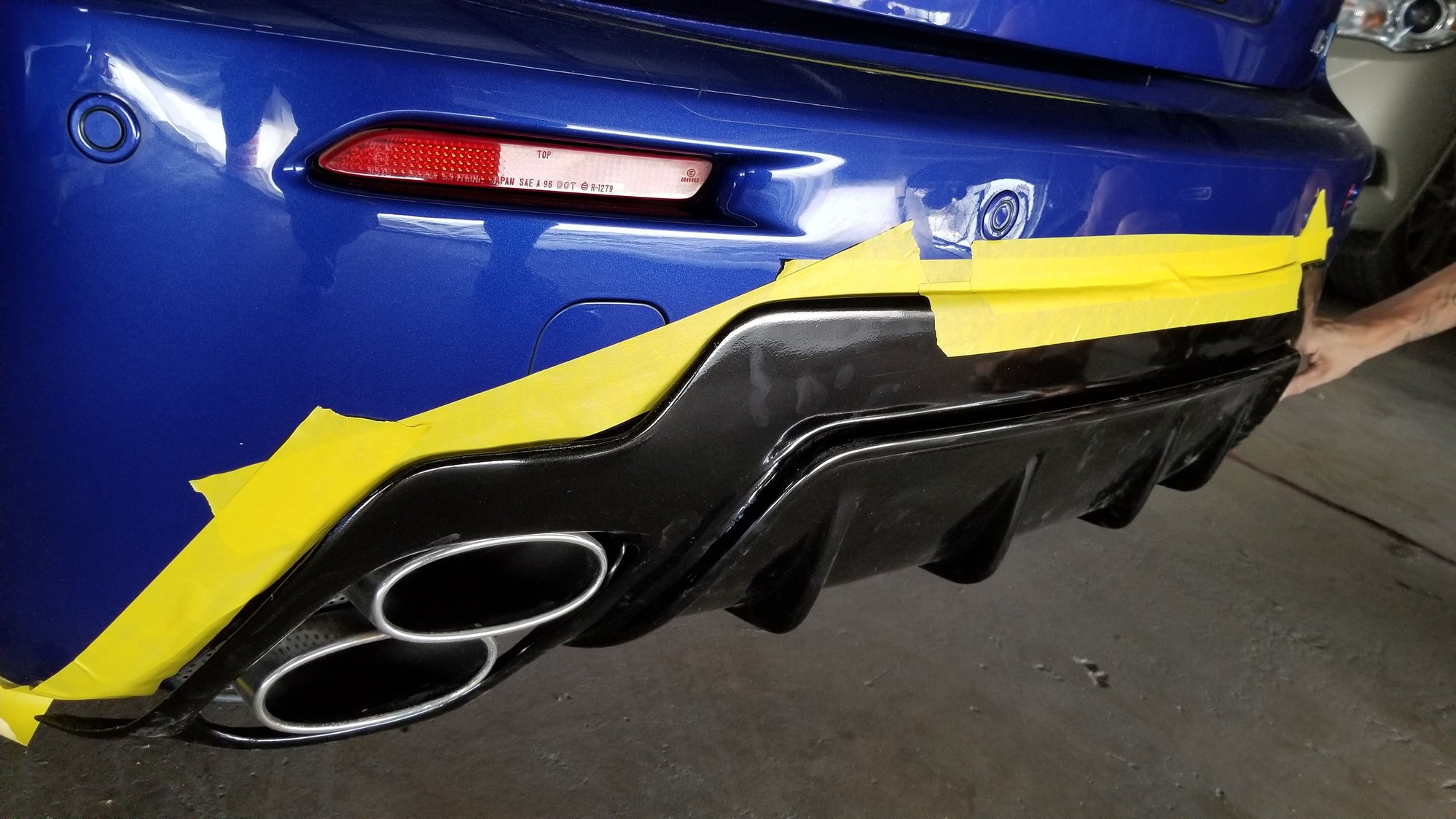

Like the saying goes, "you get what you pay for". It's not always the case but it was for me. I bought a rep WALD diffuser in a winning bid. I figure it wasn't going to be that bad but the fitment is way off. I understand that even the real ones you might need to do some light sanding to fit but mine needs a lot of custom work to the point it practically has to be refiberglassed again. Mounting holes are off and exhaust openings rub bad. I got excited and had it painted but couldn't do a test fit at first because the car was in the shop for a supposedly bad knock sensor which might not be the case.
I got to bring it back to the dealer for full diagnostic because they might have misdiagnosed it from the beginning. $800 job and the CEL came back on again for the same problem (P0328). Anyways back to the diffuser. I'm going to get it modified because the local shop is willing to work with me and does a pretty good job to where I want to get his name out. Time management is my other problem too as both the dealership and shop are more than an hour apart from each other. Other than that, just know what you're getting yourself into even if it's as small as this.
There are gaps all over the place and this replica from this seller does not have the flat boarder on the back side to provide a surface to mount tape or anything. It just just like the backside of all other types of fiberglass parts with messy resin and fibers cured together and looks rough all over. I don't have a picture of it as it's in the shop getting modded.

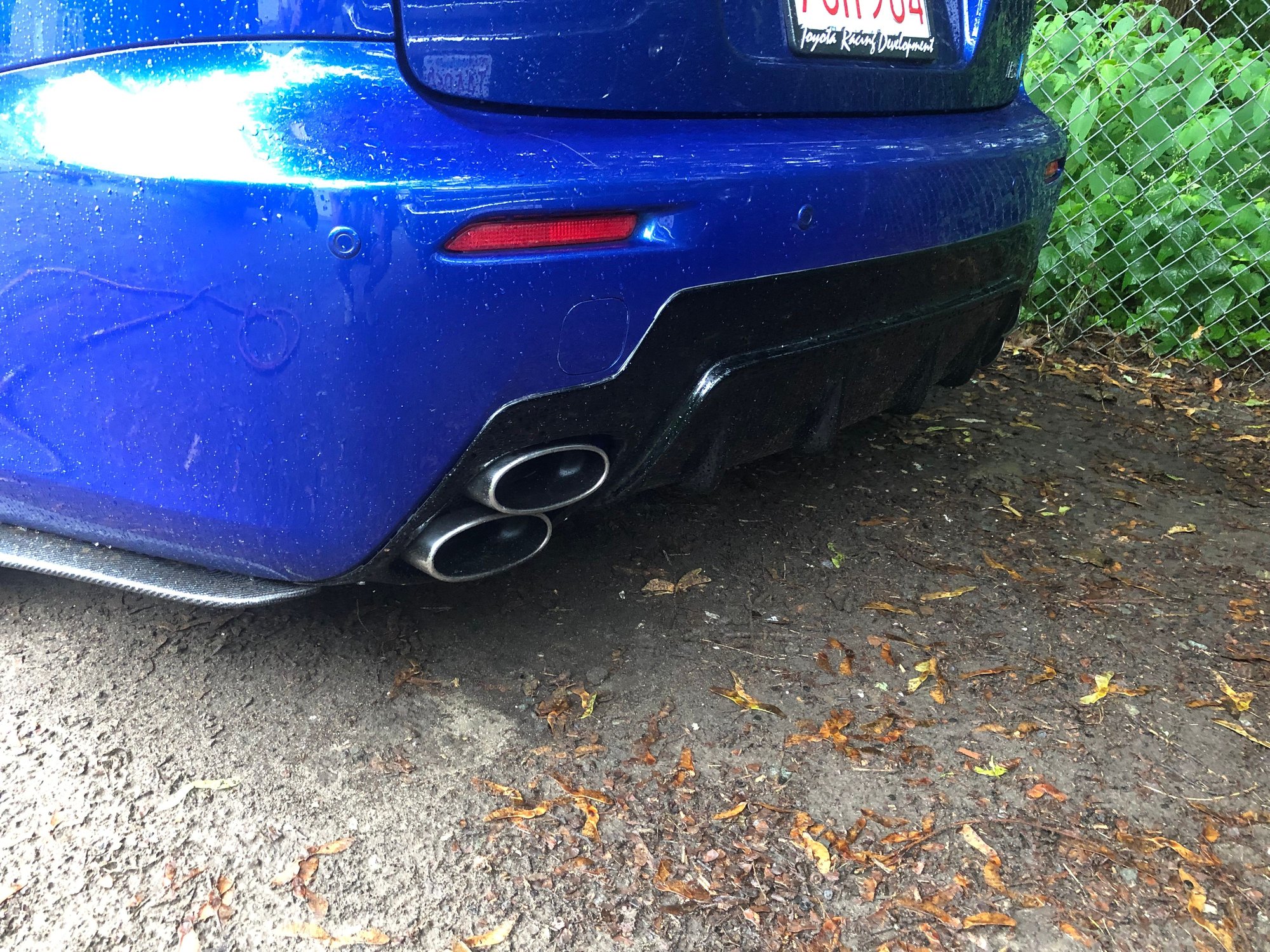

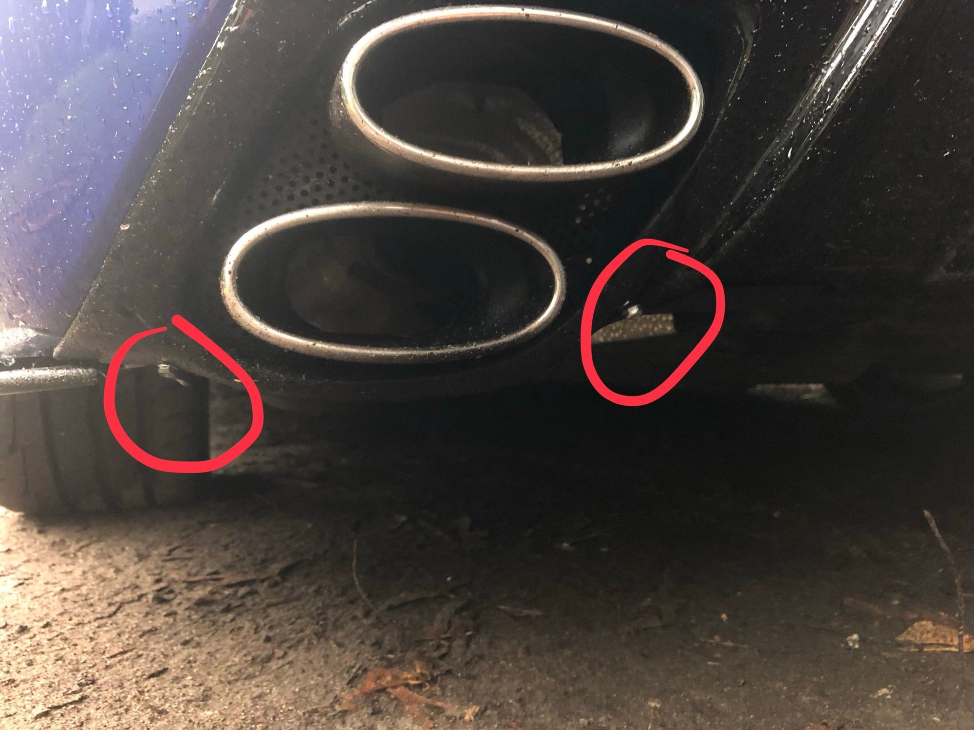

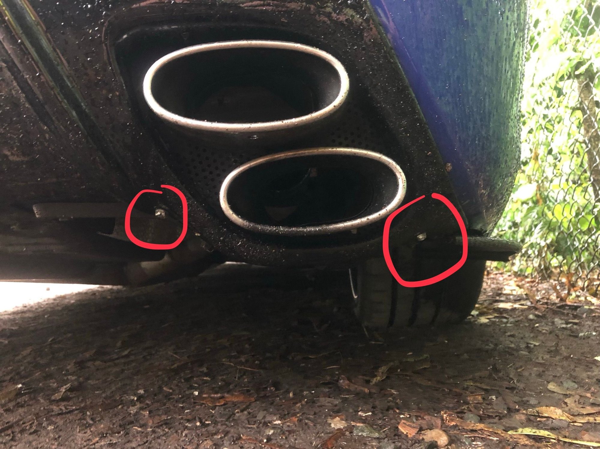

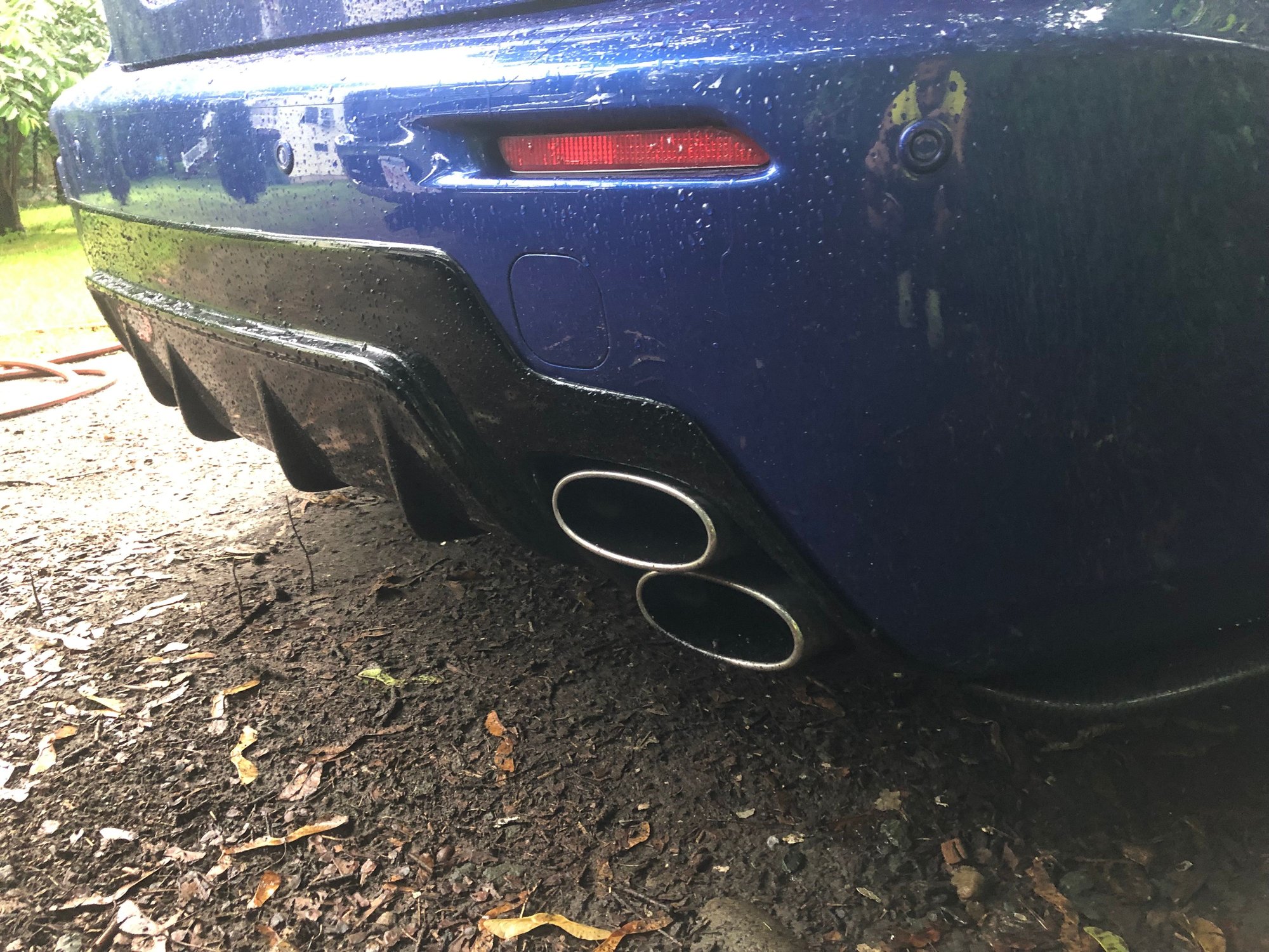

I actually bought from the exact same seller and by the sounds of it my fitment may have been slightly better than yours. I used some 60 grit sandpaper to the backside to create a nice flat edge for the 3M to stick to, making sure both surfaces were extremely clean because of the fitment issues. I did have a little bit of lifting from the 3M, so I drilled four screws into it on the bottom to make sure it was at least sitting mostly flush. All of my tabs were used on the bottom.
