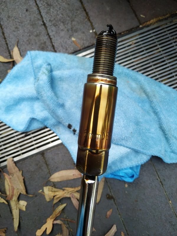

  #58
robxs's Avatar
robxs
Joined: Dec 2020
Posts: 26
From: New South Wales
Originally Posted by virulosity
Here is a picture
#8 also
Old Dec 14, 2020 | 02:06 PM
  #59
MileHIFcar's Avatar
MileHIFcar
Joined: Feb 2015
Posts: 2,673
Likes: 408
From: Colorado
My guess is what Joe-Z said above and in the other thread is that your car has been overfilled when the oil changes have been done by that shop or the previous owner and over time you get the accumulation of oil....
