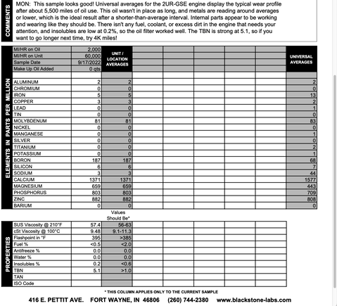

Here is mine, oil was in the car for 1.5 years ( I know, it slipped my mind to get it done) but I only drove around 2k miles in that time.
I think I used Costco Synthetic or it might have been Mobil1, but in any case..it was 5w-30 with OEM filter. Going Costco oil this time around and will post in a year or so from now.
