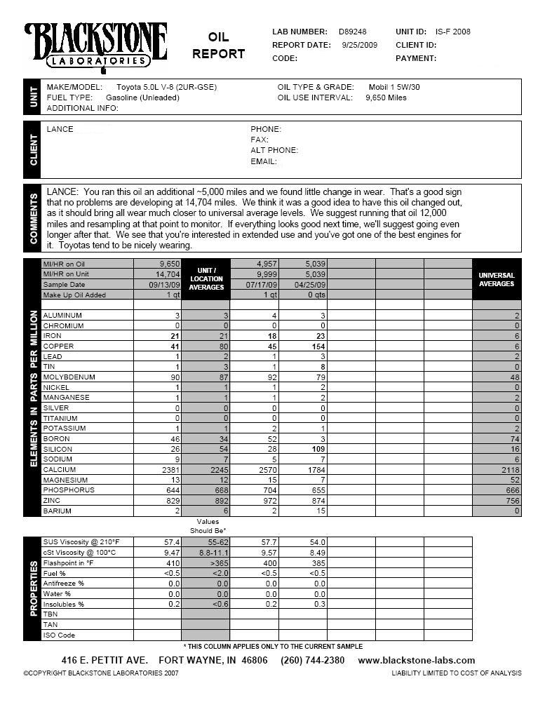

So I've been tracking the IS-F... Here's what I have so far. I'll have more soon, I just did a complete change at 15k miles while visiting a friend in Dallas (oh, yeah, I ignored their recommended change...):

haha that is crazy...I don't understand half of what it means...LoL

looks like they said another 5000mile interval not a another oil.

Blackstone says I am good for 12k mile OCI! This data INCLUDES a track weekend, and notice many of the numbers actually decreased after the filter change and top off at 5k miles.

Copper seems a tad high but perhaps from the oil cooler and track running. I doubt it's related to something like a coolant leak as there would be other signs.
Looks good!

Excellent work and proof. This goes with the car chat thread that service intervals for oil changes maybe too aggressive.
Thanks for sharing!

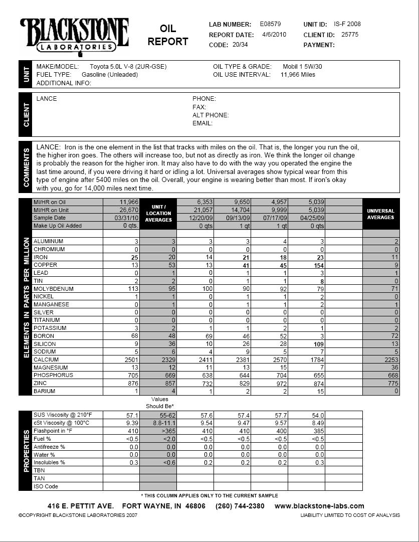

Latest update....copper is coming down...iron is tracking, can go further still...
