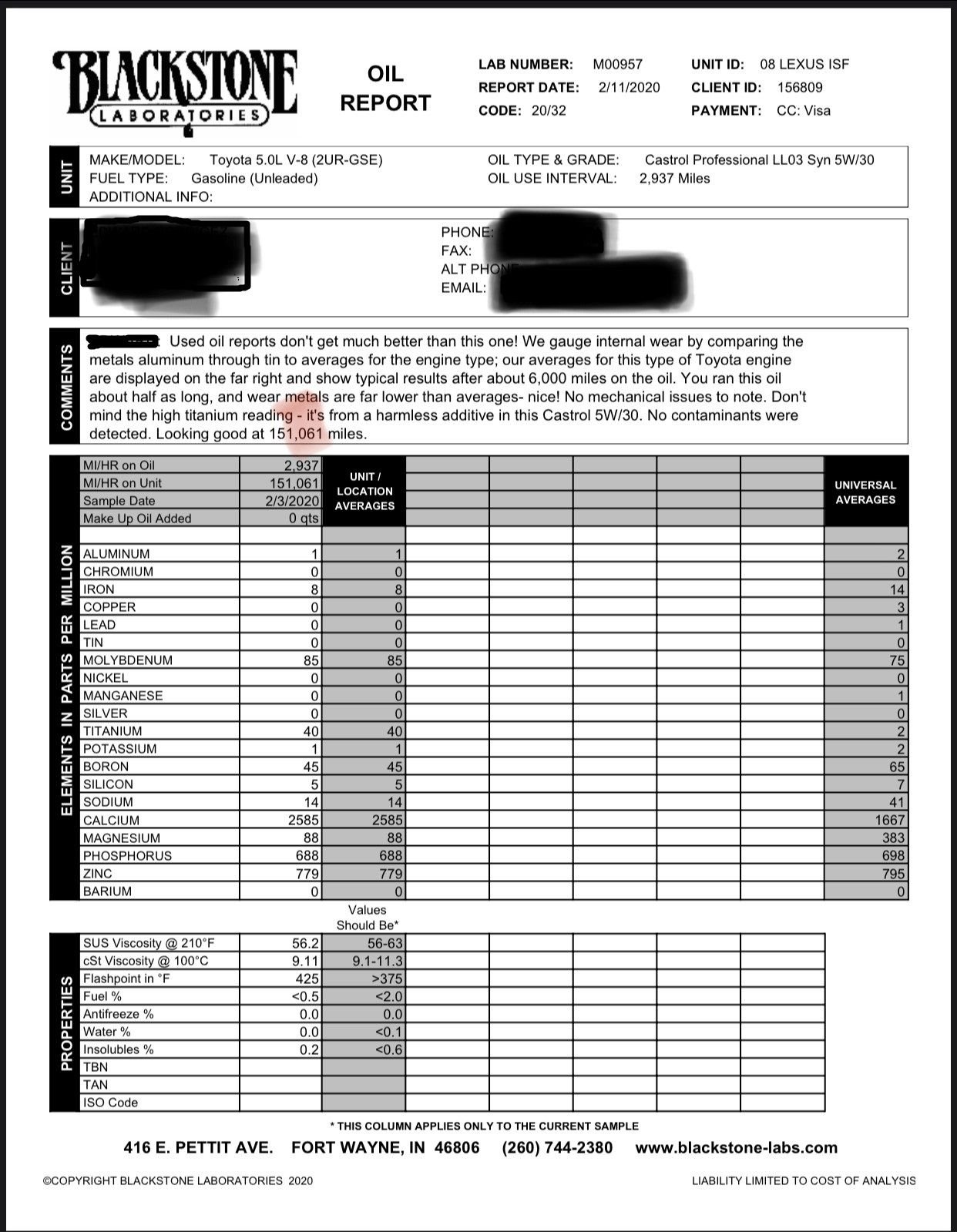

Here's the latest with Renewable Lubricants 5w-30 PCMO SHP instead of the Mobil 1 I've been running forever:
Can you put the differences into laymen’s terms for me?

There's not a lot of solid information from Blackstone. Wear metals are OK, and viscosity is OK, but everything else is suspect because the tests they perform for these things are questionable compared to other labs with ISO certification. Blackstone is convenient for me and reasonably priced, so I've stuck with their analysis, but if I really wanted to know flashpoint, fuel dilution, or water content I would need to use a better lab.
That said, the biggest difference between Renewable and Mobil 1 is the additive package (this is clear in the trace element numbers) and the viscosity - Renewable's viscosity is higher and more stable compared to Mobil 1. The iron numbers I have seen from the wife's GS F are ridiculously low - where my IS has 14, it has 4. I was wondering if this is an engine design issue, or if it is a result of the oil's ability to reduce wear. Since this is my first test with Renewable in the IS, I will be looking for a downward trend in iron. Right now, there's no difference, but the point of these data points isn't what does a single test yield, but how does the engine wear over time. So I'll need a couple more reports to really determine if this oil reduces wear compared to Mobil 1. Right now I can only say it is no worse, but that's just one sample. Time will tell for sure.

The biggest reason was after seeing iron at 4 ppm in the GS F, I reconsidered running with 24 - 35 ppm with the long change intervals. The best abrasive compounds start with good lubricants, and iron is abrasive, so I decided I wanted to reduce the level of abrasiveness in my oil.
