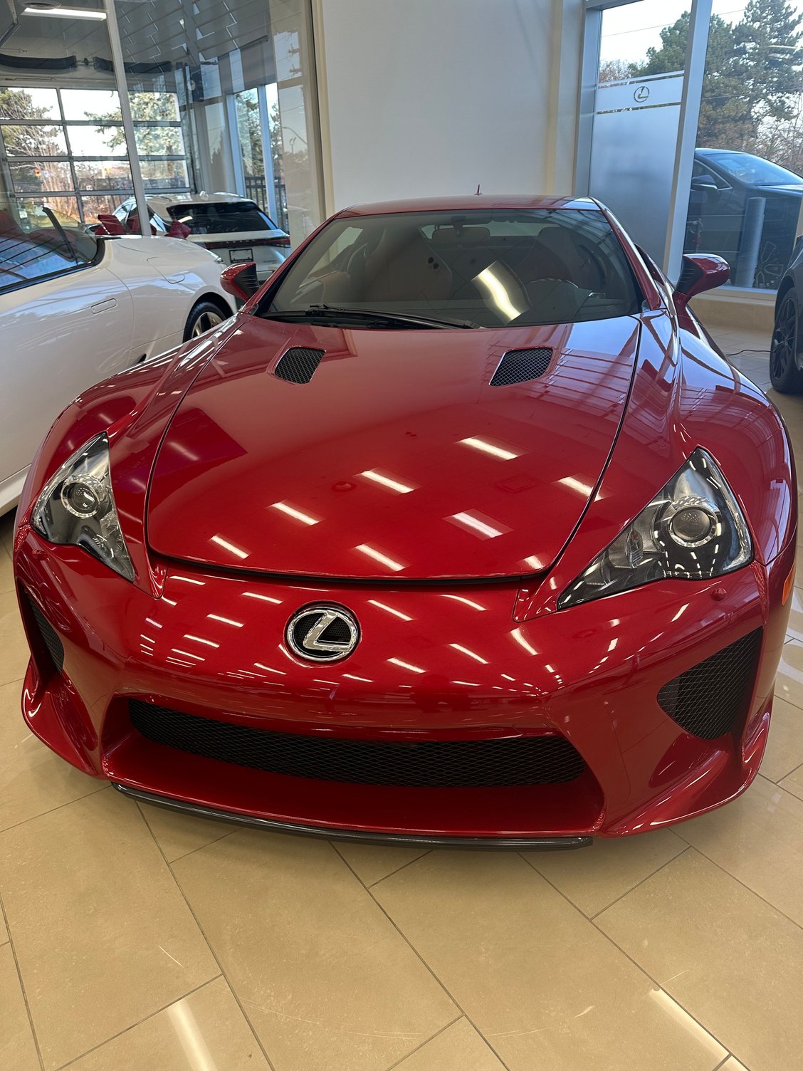

@wthrman2 Yeah. I changed the light and lock settings with the key fob inside my pocket. When I stepped out of the vehicle, both key fobs stopped working. I can manually lock and unlock the car, but the controls do not work from a distance.
@Benibiker1558 I just read the post. Dealership said this is the first time they heard of this issue. I did reference your post, but they said they have to do a full diagnostic of the car.
Will post updates after I get the car back. They did give me a nice loaner so I can’t complain. 🤩

Update: It was a simple fix with Techstream. They just synced the vehicle back with the key fobs. All is well now.
@wthrman2 I had to return the LFA loaner as my key fobs were fixed right away. Maybe next time. 🤣
