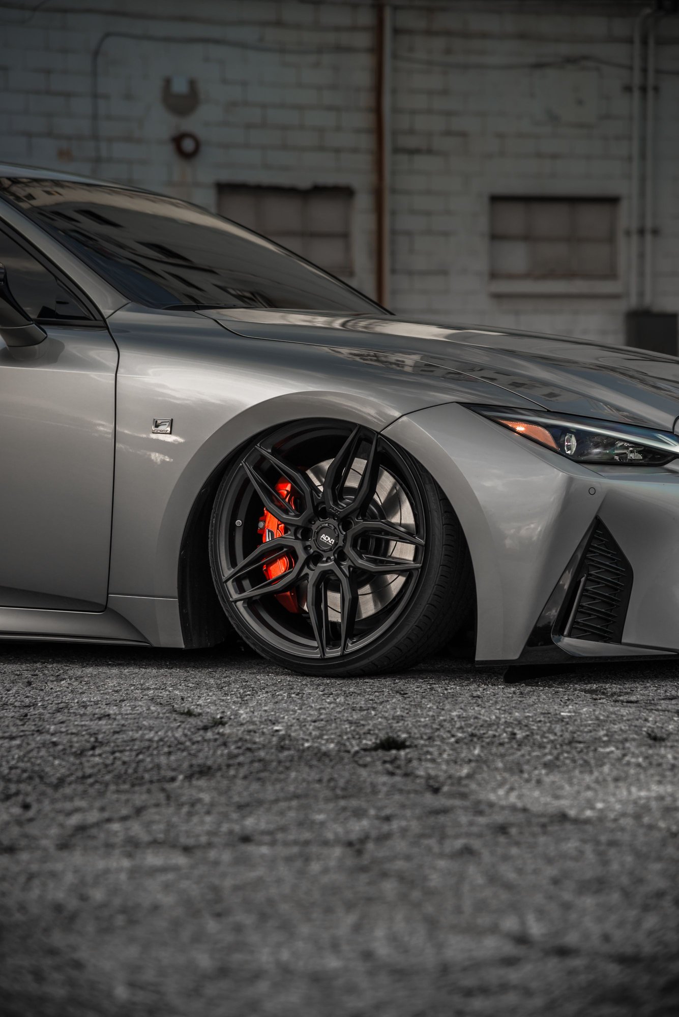

Here’s my 2021 with gsf bbk
Haha, that is actually my screensaver! That is a badass setup for sure! But it don't help me, lol
