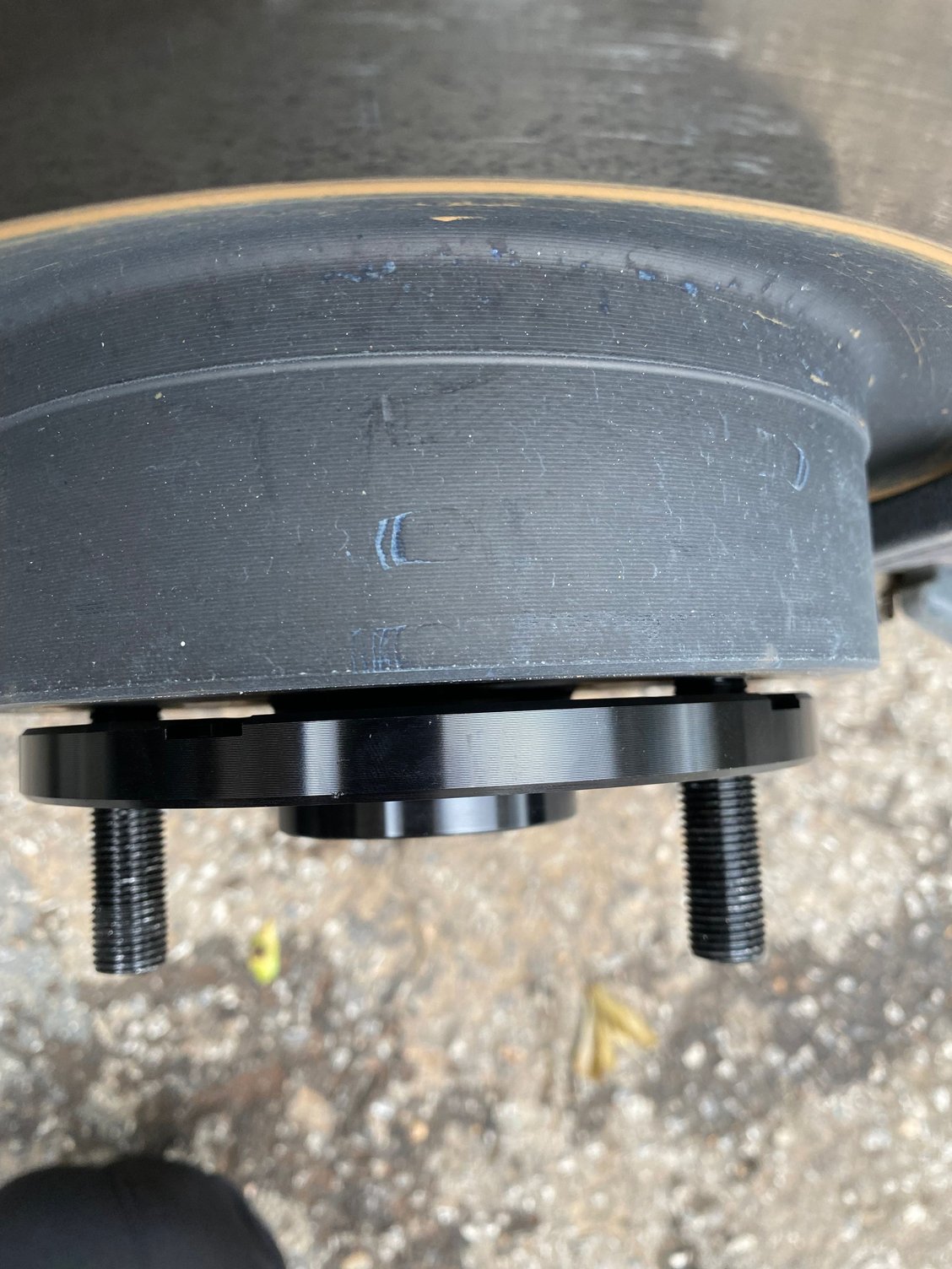

So I actually got the 10MM spacer a couple days ago and tried them on to no success. They perfectly cover the hub leaving nothing for the wheel to catch. I was able to overnight their "Mid" hubcentric ring (they have a low, mid, high. The 10mm comes with low), and hoped that would work but even with shaving it down a good bit, it was a no-go. So I'm thinking you either need to stick with 8mm-ish, which is pretty sketchy cause I still wouldn't think theres enough hub exposed or run a 12-15+ for the fronts.
I'm probably going to try ordering the 20mm to replace the rears and put the 15mm up front. We'll see how it goes

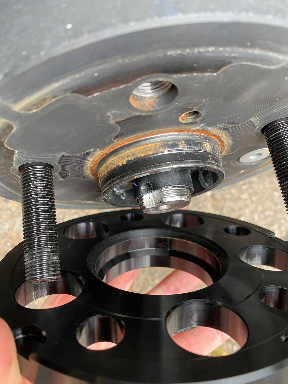

I ordered Motorsport hardware 14x1.5 studs and lug nuts, along with 20mm and 12mm spacers. Planned to remove the lugs from the spacers and use studs/nuts. This part worked great.
The spacer wont slide all the way to the hub.
You can the the step inside the spacer here.
The 20mm fit in rear, but I think it’s too much for me…I think 12-15mm will be perfect.
The 12mm has the right 60.1 bore but doesn’t clear the whole length of the hub centric on the car….pic attached. Maybe same brand (ksp) in 15mm would clear or have the 12mm machined to clear.
So looking for different spacers/solutions.

@isedawishy I only tried on the rear, the 20mm just has more depth to the step. I’m going to study it more to see if I think a 15mm will have enough step, the do 15mm all around or 15/12mm.
I assume but don’t know if the front and rear hubs are the same, may compare this weekend to see if the 12’s will work on the front.
Also looking at using 15mm spacers with 66mm bore + adapter rings, maybe that would clear the hub.

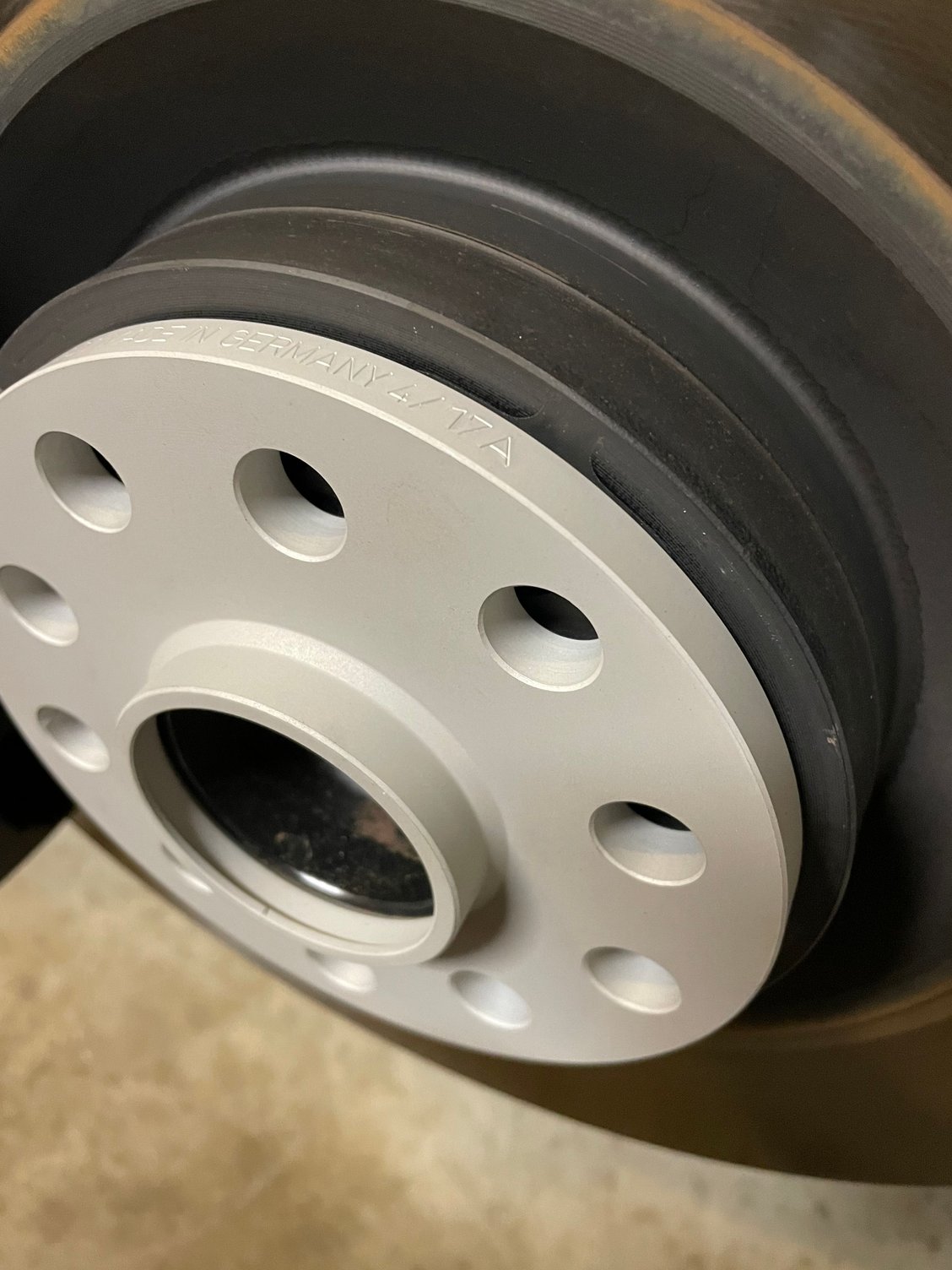

H&R 10mm don't fit the front but the 15mm spacer fits both front and rear.
We may buy another set of 15mm and have a machine shop take 5mm off the back. I believe it'd then fit the hub lip.
Here's what the 10 looks like up front,
