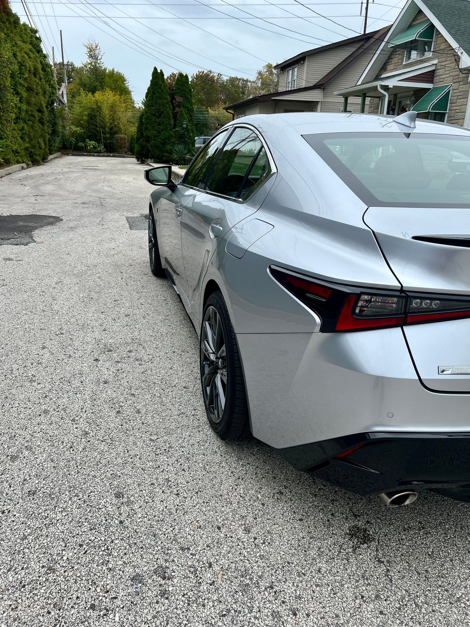

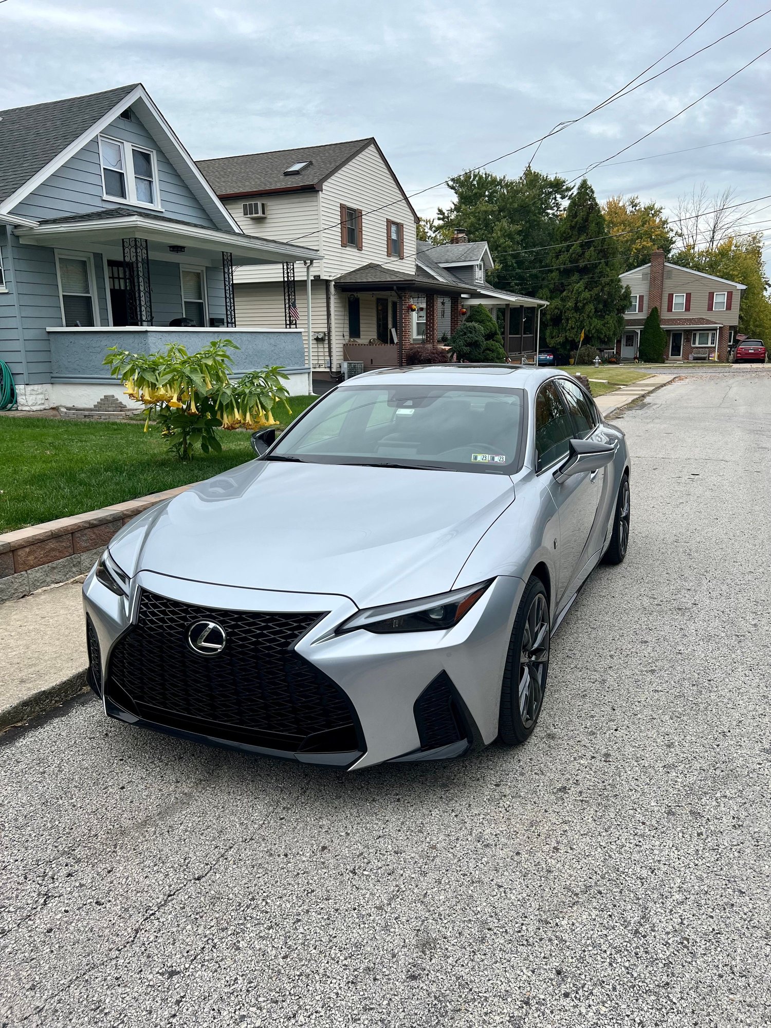

Thank you ordered that exact setup installed last night looks perfect! Now if I can only find a way to lower this thing. Anyone know what setup works on a 2021 is350 fsport awd? Looking for springs

Originally Posted by dxbIS350
Hey, could you please send some pics here of the car with the spacers on stock rims and stock suspension.
