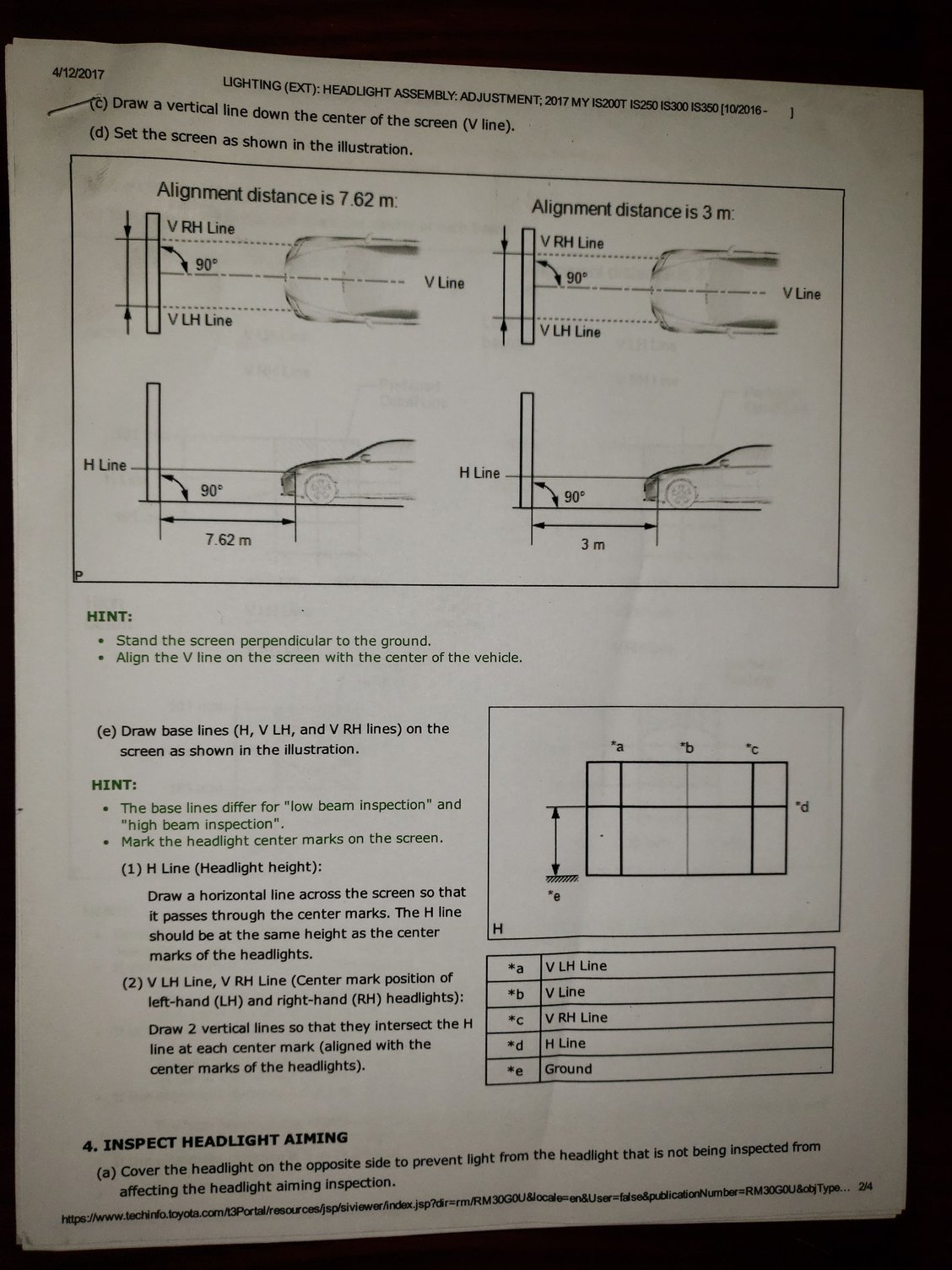

2. Extra info for raising, lowering, using wall, feet, etc. etc. - these are pics but i got pdf too
How to: Headlight height readjusting, useful threads, etc-xvhekiy.jpg
How to: Headlight height readjusting, useful threads, etc-xudxie6.jpg
How to: Headlight height readjusting, useful threads, etc-0ncxfoj.jpg
How to: Headlight height readjusting, useful threads, etc-04pptk1.jpg

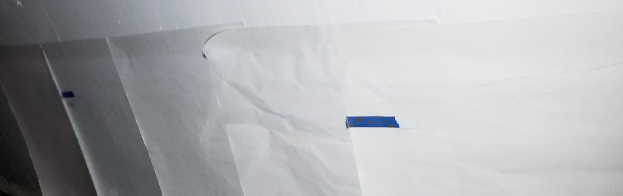

Additional info...i used these GIANT super sticky post it notes...or easel but plain white paper, butcher paper, etc. etc. should work fine...its a bit pricey and i'm sure it can be had somewhere for less, only needed 5 sheets of 1x 30 sheets
https://www.uline.com/Product/Detail...E&gclsrc=aw.ds

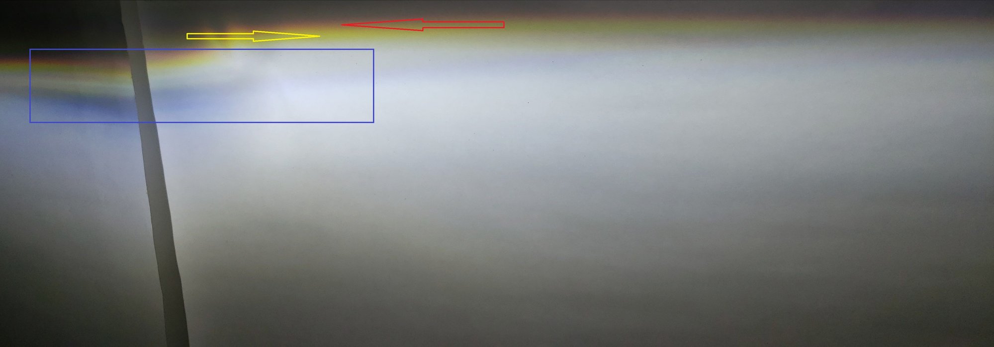

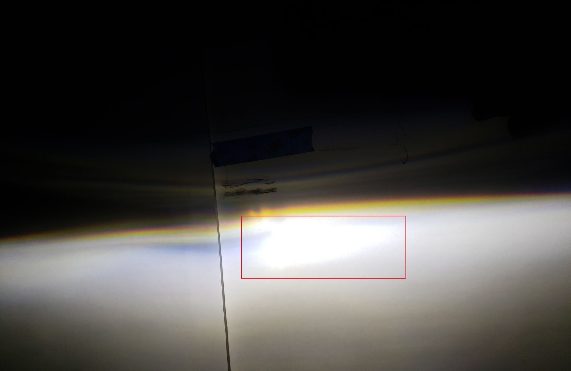

if your are parked about 3ft from the bottom of your bumper from any wall, you should see a super bright white spot (red)
what also helps is you can see Red (red arrow), Yellow, (yellow arrow) etc. or colors of the rainbow. in the blue square you can get a better view of the color spectrum that helped with leveling process
