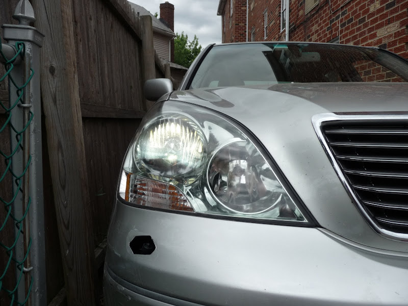

This Sunday afternoon I decided to restore my yellowed headlights. I was sick and tired of them being so nasty but didn't have time to get to it. So I bought this: http://www.turtlewax.com/main.taf?p=2,1,4,32
which was $24.99 at my local autozone.

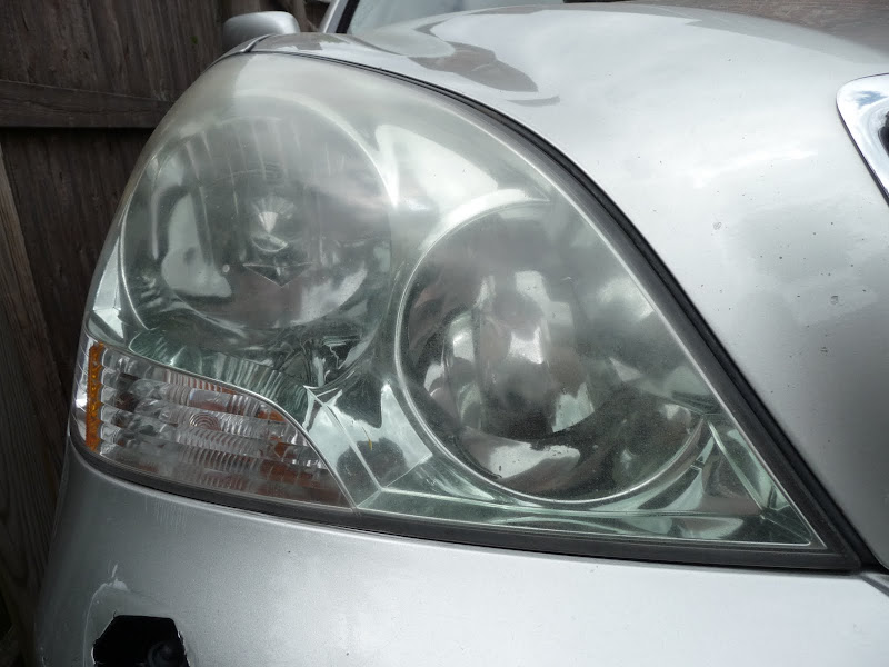

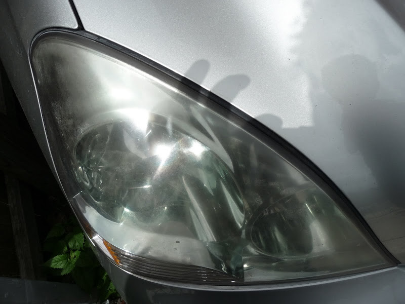

Before:

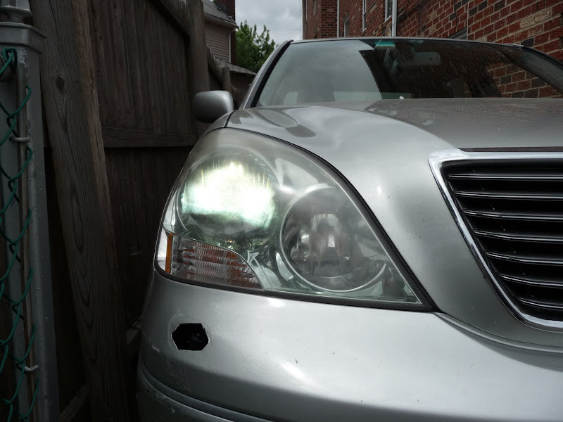

After:

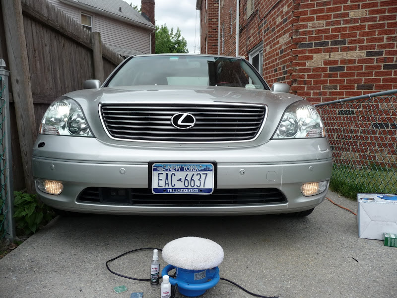

About an hour of work and $25 can make miracles. Everything was really straight forward - follow instructions and you'll be ok.
P.S. Shop quoted me $100 to restore both headlights.

After continued:

Wow! Good work! I heard if you put some 3m headlight film on it, it prevents clouding/yellowing again.

Thanks for the kind words. The TurtleWax kit comes with the special wet cloth with a soaked special liquid that prevents yellowing and clouding.

It looks good but you could've gotten the same results for even cheaper.
5000grit sandpaper + water + Rubbing compound =done
Dip the sandpaper in water get it wet wetsand the lense,dry it off,apply rubbing compound & buff to shine.....for the nextime

I'm not cheap but the difference between $10-15 and $25 in your case and $100 and $25 in mine is pretty big, plus TurtleWax guarantees satisfaction. If I don't like it I can get money back. For me is better to buy specialty products for whatever I need to do and get less chance to screw it up.

Wet sand it with 1500 grit... then wet sand it with 2000 Grit... then polish it with that stuff
Mine look like crystals because I wet sand and buff them about 6-8 months

Did you not mask the car before doing the work?

No, I didn't mask up the car. That nasty hole you see in the bumper will be gone soon with repaint of the bumper. What's the reason to protect the bumper if you gonna repaint it?
