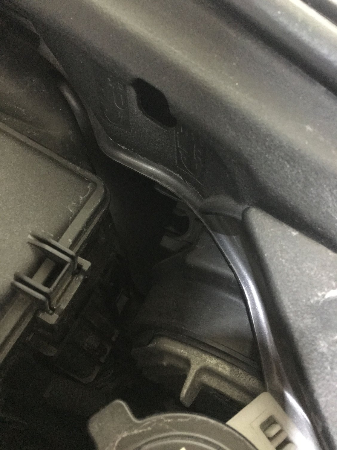

it's a tight squeeze not sure I can grab on to it from the engine bay..
is the alternate way of accessing through the wheel well?

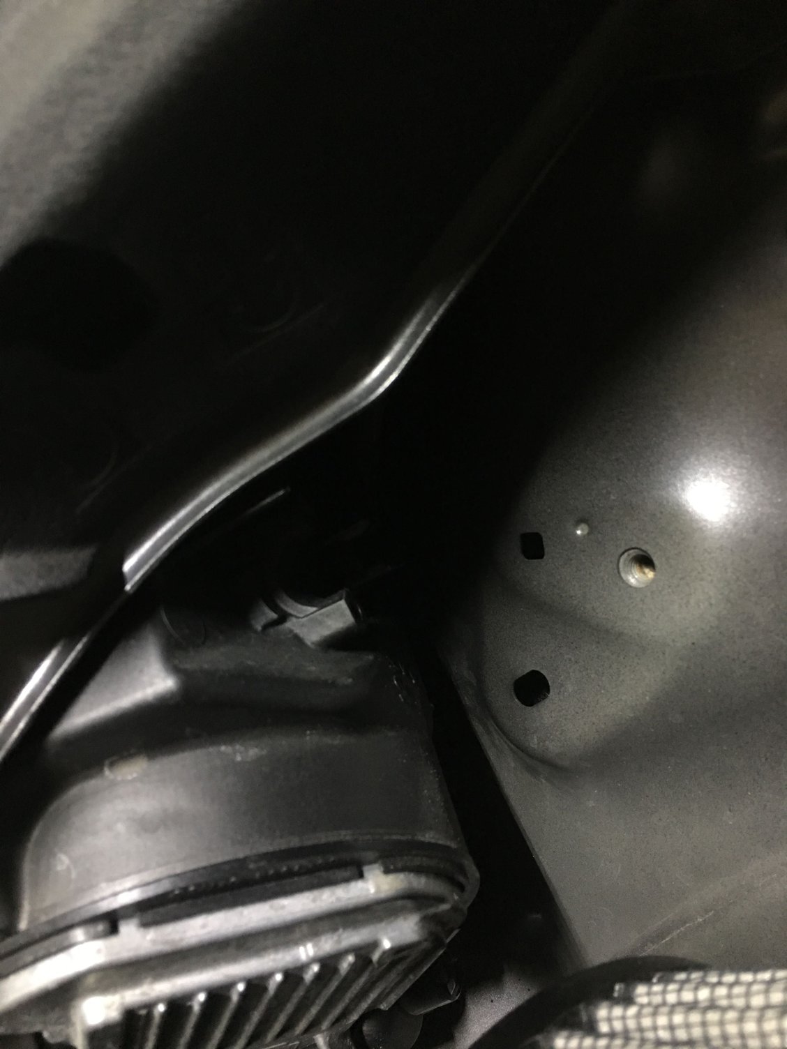

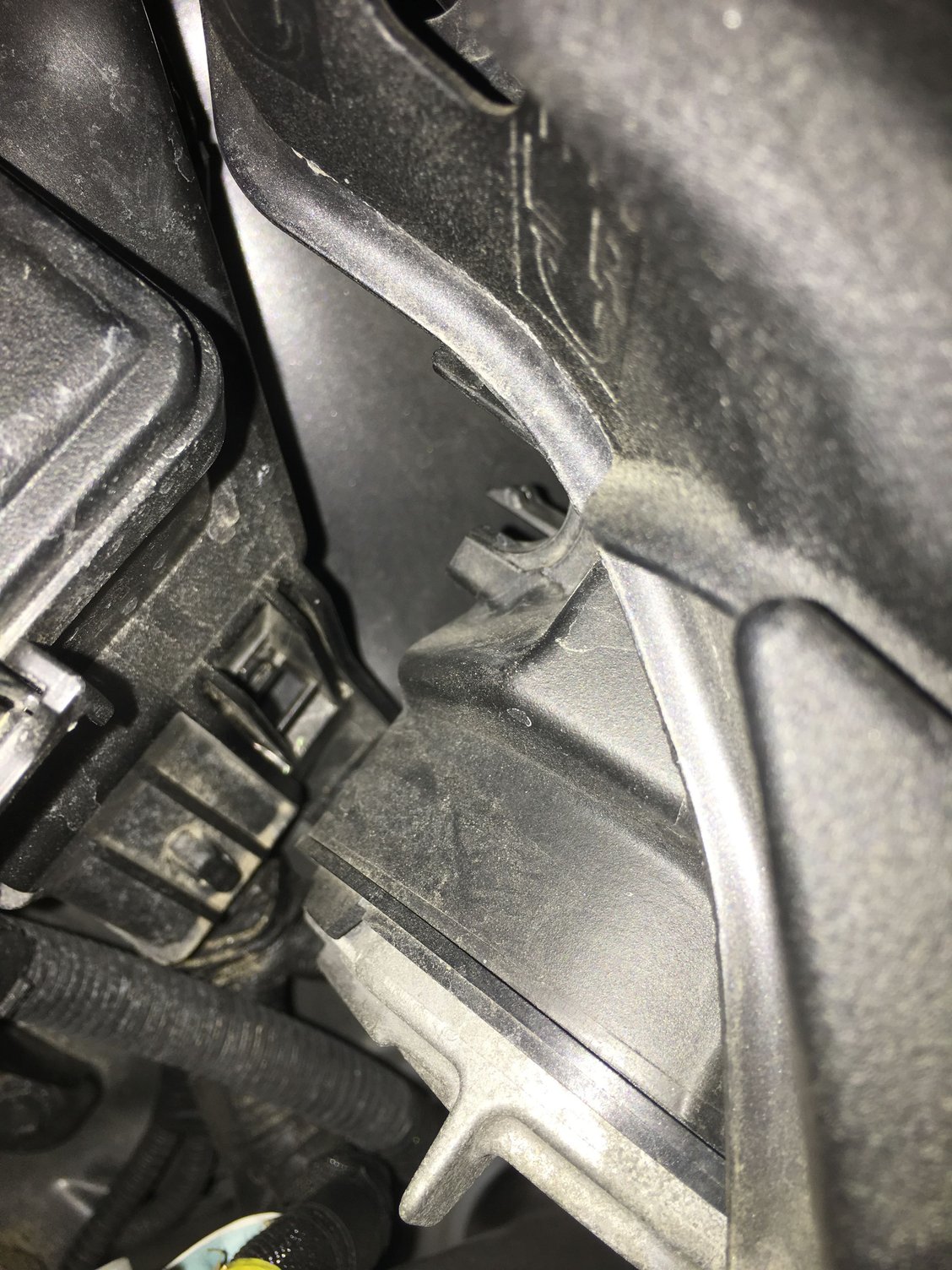

My car is Canadian spec it's not possible to reach see attached
One would think this is relatively simple but the design and compact area is impossible to reach... Is there an alternate way?? This is way to complicated never had any issues before with any other car accessing the plug/ bulb on headlights terrible I probably will have to remove fuse box to even have a chance lol

I'd say go through the fender liner then. I had to do that on my Civic. Only took 15 mins or so.

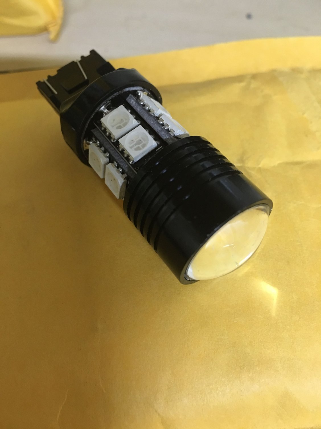

Posts: 62
From: ontario
Originally Posted by J3ffrey
it took less than 5 mins for both.. just use tools.

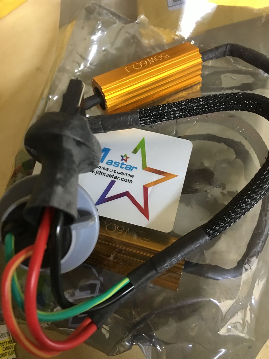

So I started one side on rear took a few seconds to do really easy lol...I'm not satisfied with the bulbs I got way to dim compared to stock now looking for new bulbs .. My emergency signals worked normal without resistor as soon as used turn hyper blink occurred .. Tested my resistors all functional from jdm star just disappointed in bulbs ...anyone know any decent cheap high quality bulbs

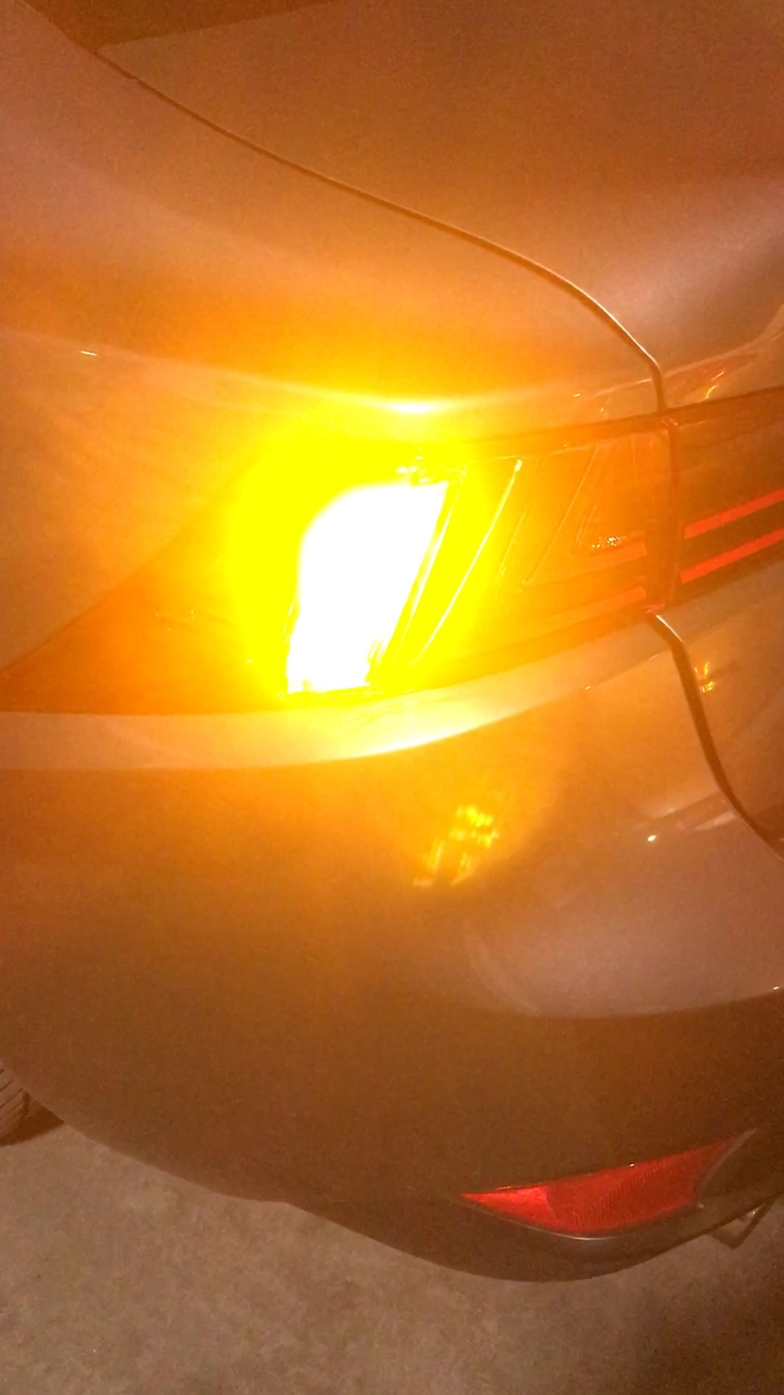

Finally installed rears went well went through 3 sets of bulbs to find the best ones that suit to my liking lots of garbage LEDs and am satisfied nice small upgrade I find LED can be expensive not worth the price but outcome of faster crisper bright response of the LED is what you pay for LOL ...
Waiting for front harness now as I ordered the wrong size 7443/ a set that will fit the front housing properly which is 7440..
