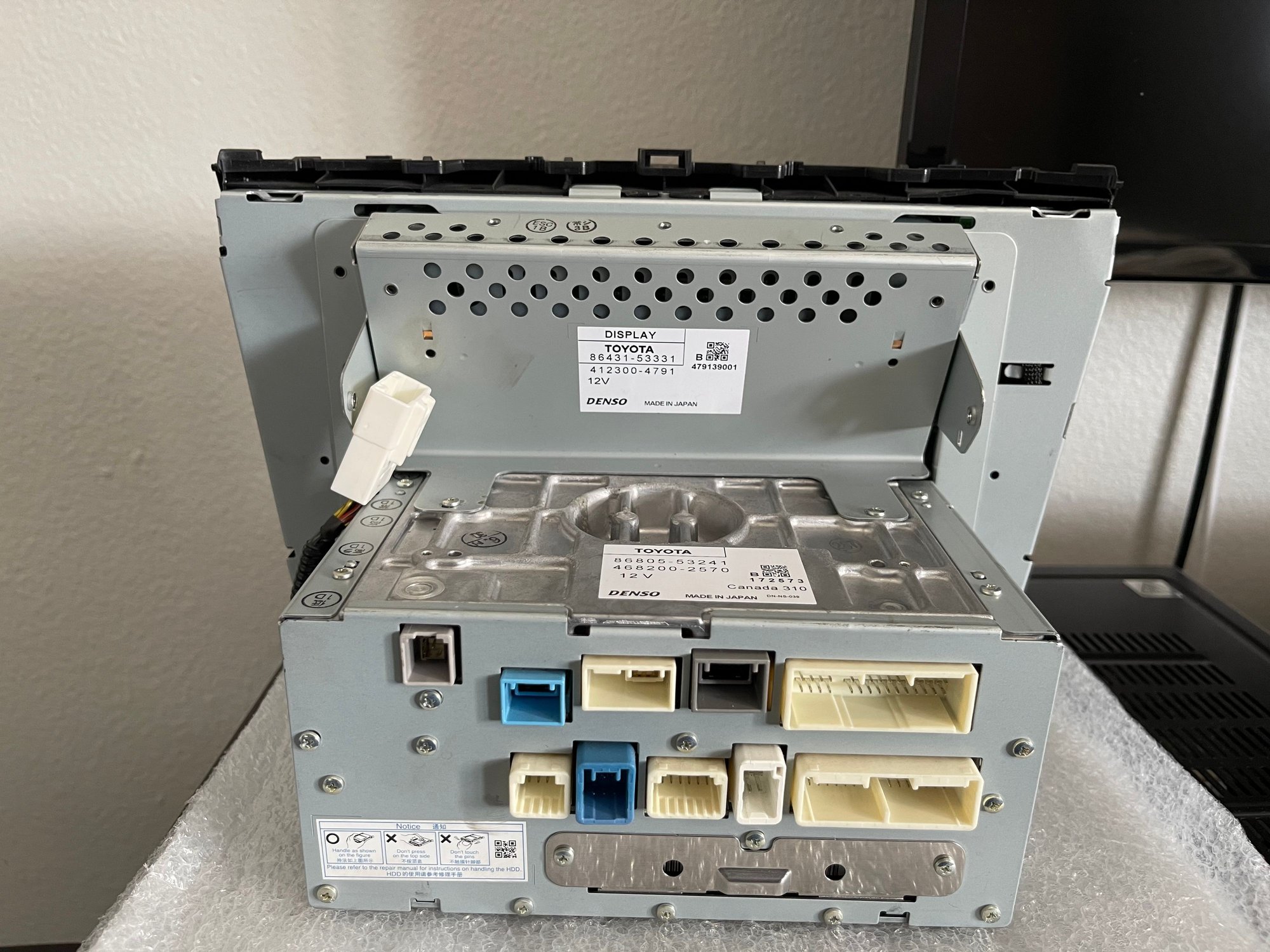

will the 2010-2012 nav system fit a 2009 is250 car that had nav without any modification?

That's a good question! It has a similar front, but the connections on the rear are completely different. Is there a reason you are looking for an upgraded unit? Probably the bluetooth audio streaming I'd imagine?

yes, thats exactly why, i really dont want a super duper aftermarket system, all i care about right now is the fact that i have to use cheap third party AUX bluetooth adapters, and having to control everything thru my phone, all i really want is bluetooth audio capability. At first from what i read i though 2006-2008 would not fit because of the vents, but then i saw the 2009 and up vents are the same so i thought this would just drop in without any issues.
Is there anyway around this, in other words, a harness of something i can use?

There are no harnesses but I have the GROM VLINE2 on my 2010 and it has changed the infotainment for the better. I’d highly recommend it. They have it for a ton of different models and it adds wireless Apple CarPlay and A whole lot of other great stuff
