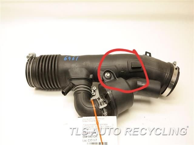

Originally Posted by MikeFig82
Looking at that pic, what's at the other end of that sound generator trumpet like pipe? is it an open hole pipe? will that not cause a vaccum leak?
It's a diaphragm:
https://www.clublexus.com/forums/is-...generator.html
