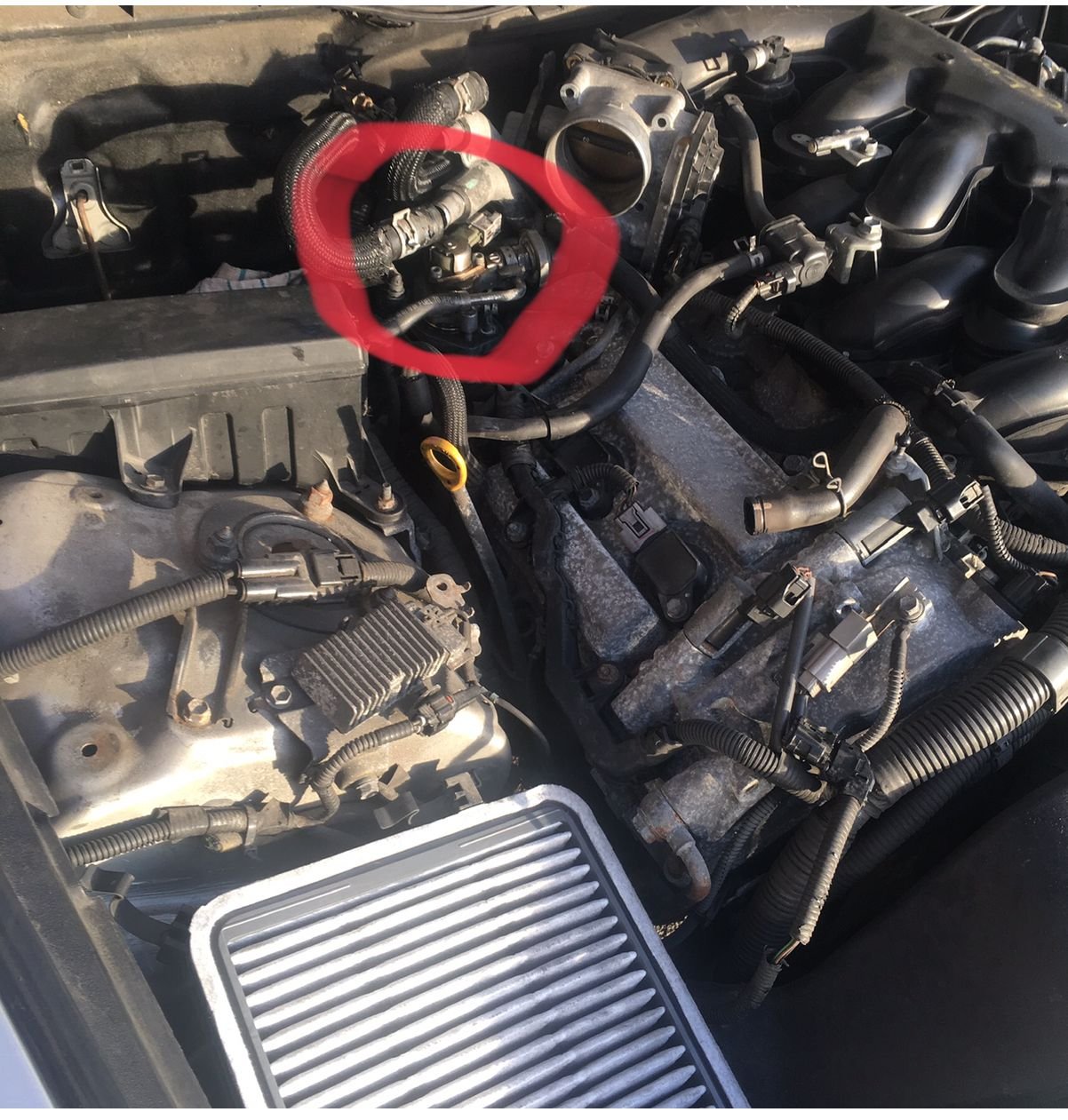

SOLVED!!!!! Thanks for all of the responses.... it was actually the fuel pump... and like how the previous person said... the engine was flooded because I seen the high pressure fuel line was leaking fuel every time I had my gf step on the brake. So I replaced the pump and the battery light came on but wouldn’t start. So I sanded down the negative side wall and the ground under the eps and battery holder.sprayed a couple of sprays of starting fluid into the throttle body. Jumped it from my sc400 and VROOM. I was back in action... I don’t know if the buzzing from the throttle body played any part when it wasn’t starting. But buzzing stop, maybe a failing TBS. idk, but the leaking from the high pressure line stopped once the car started and I drove it around to make sure everything was good and it was!! Thanks fam y’all are the best! My next question would be was caused the buzzing from the TBS?

That's good. Can you describe the fuel pressure hose leaking? Did you disconnect the cold start injector line? I'm assuming that's how you saw the fuel coming from the lines.
As for the buzzing on the TB I'm not sure. I had an GS400 before, and it would buzz if the ignition was on. While making the engine cut off while it was running.

I’m saying it wrong.... it’s the fuel high pressure valve pump the green circle was where the leak was coming from. It has black plastic piece and blue tab piece on it
