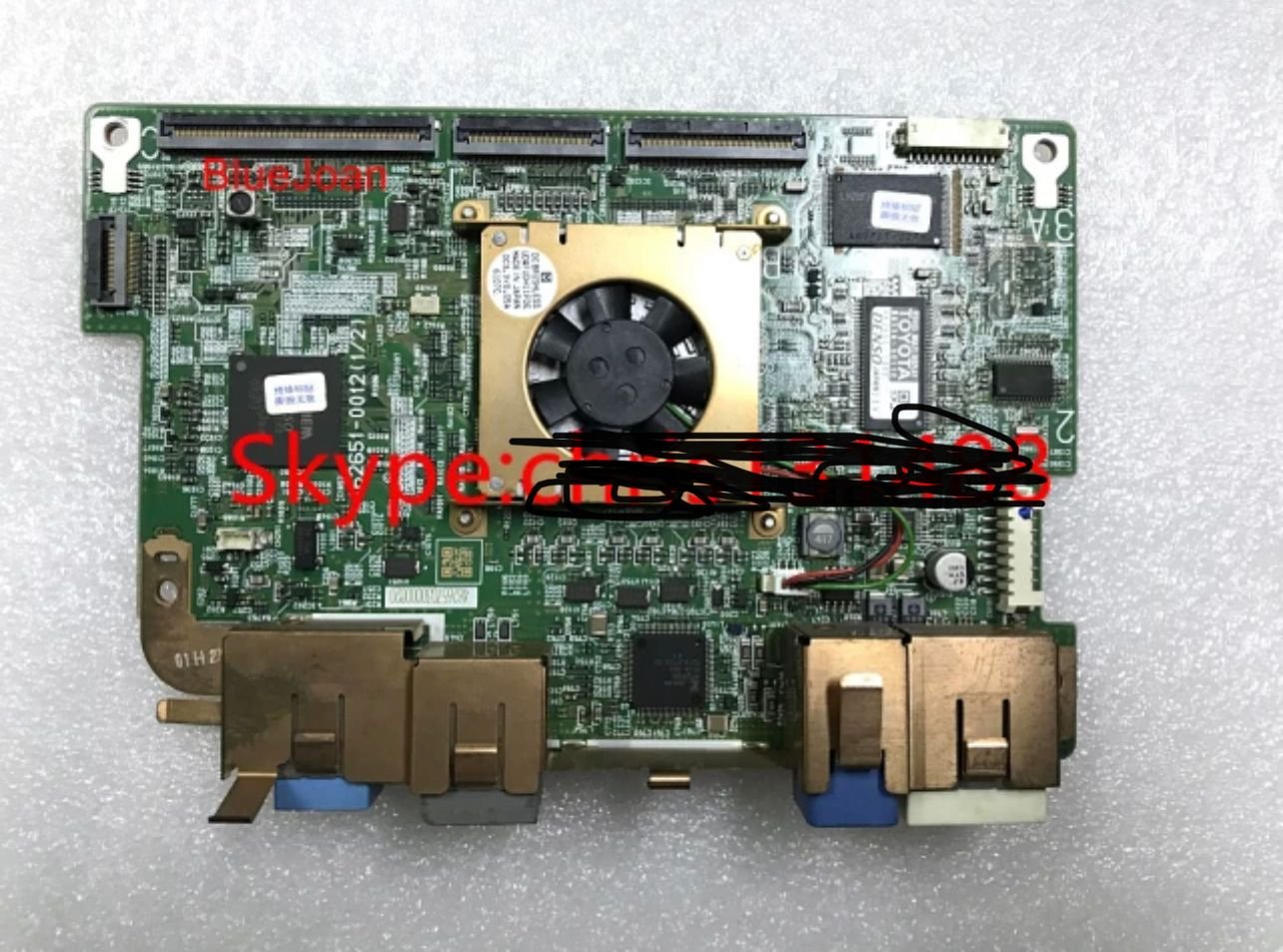

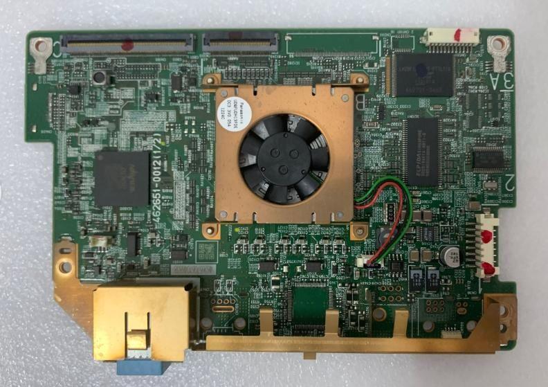

Hi All! It finally happened to my 2006 IS 250. This thread has been very helpful so thanks to everyone’s contribution. I’m going to purchase part 462651-0012 (1/2) off Alibaba, but wanted to confirm one thing. There seems to be multiple versions of this one part? The person on Alibaba asked me to send a picture of my part and showed me different versions of this part see attached. Are these interchangeable?
