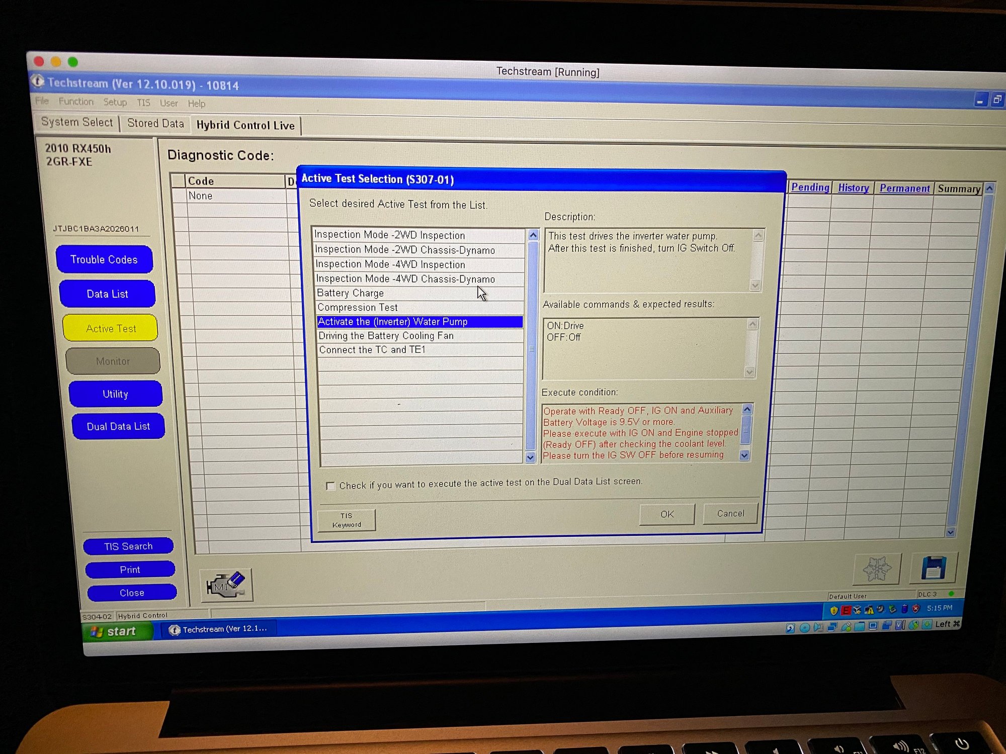

Toyota Synergy Drive has 2 coolant circuits:
1. standard engine/heater core one
2. inverter cool;ant one. Same circuit is cooling both motor generators.
You can DIY engine coolant, nothing special there. But, according to Big T, you need TIS to replace inverter coolant, as you need to operate dedicated coolant pump. That said, one of hybrid owners at toyotanation, simply siphoned coolant out of expansion canister, refilled it, let it cycle through, and then replaced again few times. It is a small volume circuit, not that hard to do.

This is correct, it's worth getting the Techstream software to do it right. The water pump is electric and can be triggered with a bidirectional scan tool and Techstream. The coolant capacity is around 2.5 quarts.
