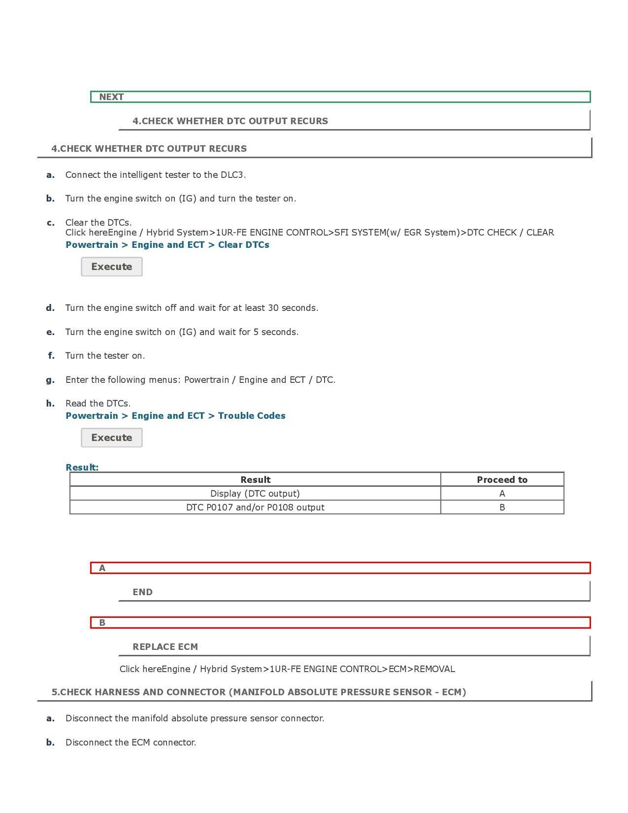

Anything else to check? Should I clean out the rubber vacuum hoses? Clean intake?
The service manual lists this as a trouble are for that code:
The SM walks through a procedure to check the MAP sensor as well.
Doubt it's ECM so I'm back to square one with needing a new MAP sensor I'm willing to guess.
Originally Posted by Acrad
My ODBII tester does have logging and real-time data display so I can chevmyhe pressure and I believe voltage. Don't have much in a way to do the rest of that and I hesitate to take it to my local Toyota dealer to here in north Idaho Donne I have zero experience or trust with them. I may check with some other GX owners near me to see if they have a better tester and can assist.
