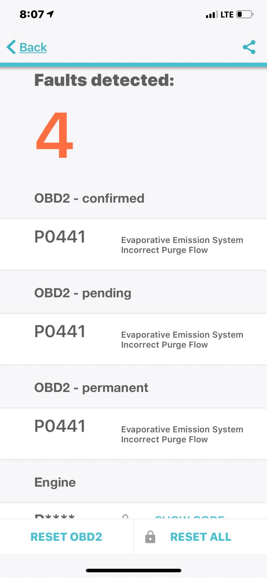

Hey guys what do you think can be causing this just recently installed a cold air intake and if I reset the light after about 30 miles it turns back on what do you guys think?

Hey, Guys took it to the dealer they told me the purge flow valve hose came out they fixed it for me? do anybody have a diagram where this for future references?

Hey so the dealer provided this photo why I was getting this check engine light to turn on they said it was somewhere close to the air filter box if not underneath. Does anybody know where exactly this is?
