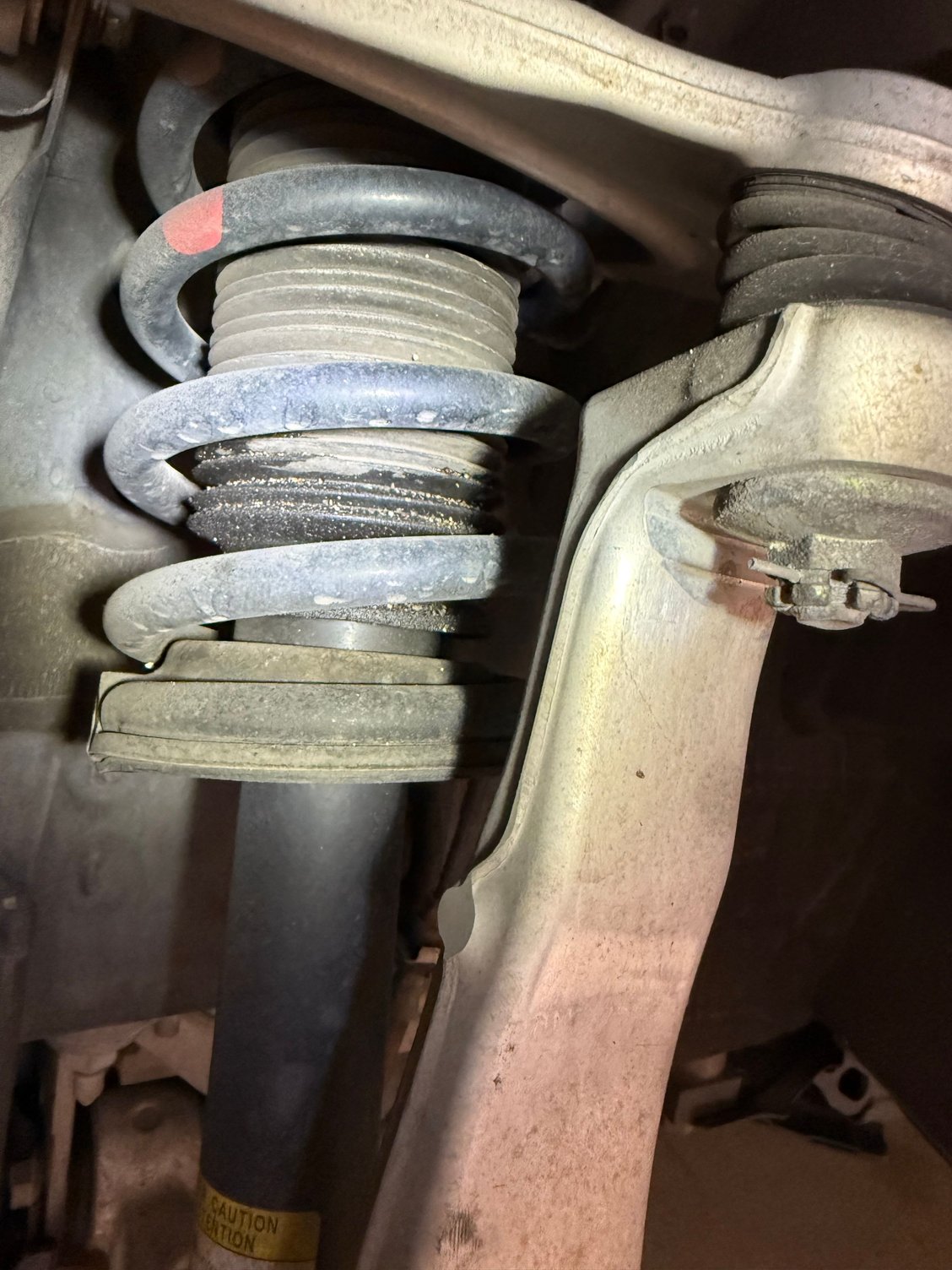

See photos...I can't tell if the caked on fluid-looking substance on the bottom portion of the shock boots is evidence of them leaking, or just gunk from the road. This is on both fronts shock assemblies.
Is this what y'all typically see when they start to leak?
They haven't exhibited any possible signs of leakage other than this, but I did just hit 110k miles on the car, so

Second pic looks like it's 'beginning' to seep.

Yeaaah, fraid so

What year is your GS? At 110k and the known Struts leak problem it is likely not good.

They look fine. I wouldn't replace them.

I would change all 4 corners at that mileage. Well worth it.

How much is that? It looks like it could go another 50k miles.

110k and showing fluid outside. Eight years old, and there is a documented know 4th Gen Strut problem. You won't know how bad it was till you install new ones like those who have felt the difference. lol!
