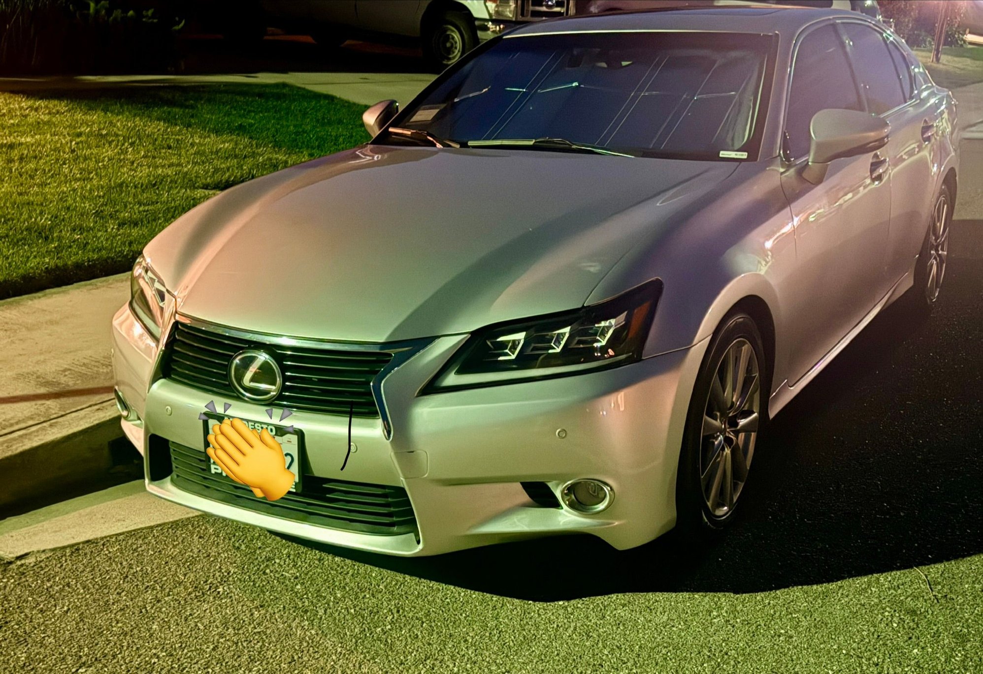

so i recently bought my GS, everything was fine until the left blinker in the headlight stopped working. I have checked all the fuses both engine compartment and under dash and passenger side are all ok. when i hit the left blinker on the turn switch it binks 3x inside the car but outside nothing happens. These are aftermarket headlights that came with the car from dealer. The weird thing is when i use my key fob my left mirror blinks and rear light , the right side is all ok. any help?

Is the blinker halogen or LED? If its LED, most likely bad electronics. If its halogen, check the bulb and the wiring. This is why you stick to OEM. Car looks good btw.
If you want to save the headlight, take it off the car and then take it to a computer repair shop and see if he can find the issue. LEDs don't run straight off 12.8volts so they have a ton of small parts that can easily go bad and because its aftermarket I would suspect that the engineering that goes into the building the electronic components to be subpar. Someone might've decided to install new headlights because the originals were faded to yellow.

It seems like more and more folks have purchased these aftermarket headlights and are having issues. Unfortuantely, if i had to guess, its another case of a defective headlamp - as Red4GS mentioned, it can potentially be fixed if you take it to the right place (either a local body shop or maybe a place specializing in electronics/headlamp repair).
One long shot is go back to the Dealer you purchased from and see if they are willing to offer a good-will discount to fix it. These are typically made in China, plug-and-play headlamps so you may be able to purchase a single headlamp to replace if needed from eBay sellers.
Here's a reputable (based on their feedback) US seller that has these headlamps on eBay ... maybe you can reach out to see if they offer troubleshooting/fixes or maybe strike a deal for a replacement with their unit: https://www.ebay.com/itm/226502002780
