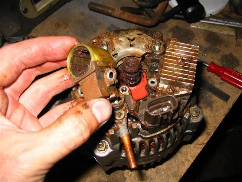

If you can remove the alternator from the car you can rebuild yourself. Replacing the brush assembly is what is needed most of the time. About $20 from the dealer. You can also replace the bearings if they are noisy.
Here is a pic from the Landcruiser forum of a set worn brushes coming out. Notice all the gunk from the old brushes.

WOW!!! That is the nastiest alternator I have ever seen, and I have been a mechanic for over 40 years. Is this from a 4WD vehicle? Maybe that could explain the corrosion.

Yea, Landcruiser is 4WD, the guy had a power steering leak that dripped on the unit. Click Here for the complete thread with more pics.
The internals of these alternators are pretty much the same as our Lexus'

Toyota/Lexus seems to always put the alternator underneath the power steering pump. Then, since the power steering fluid is hardly ever changed, the pump begins to leak fluid, and it drips into the alternator.
That fluid really takes it out. I make it a habit to change my power steering fluid at least once a year. It is less than a quart to flush the system, and at 180,000 miles, my pump has never leaked and the steering is perfect.
I hope my alternator never looks like this.
