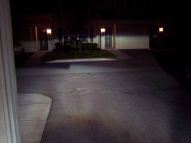

Whats not funny is that my cutoff is way off
I know which **** adjusts the vertical alignment but anyone know which way to turn it to adjust it?
