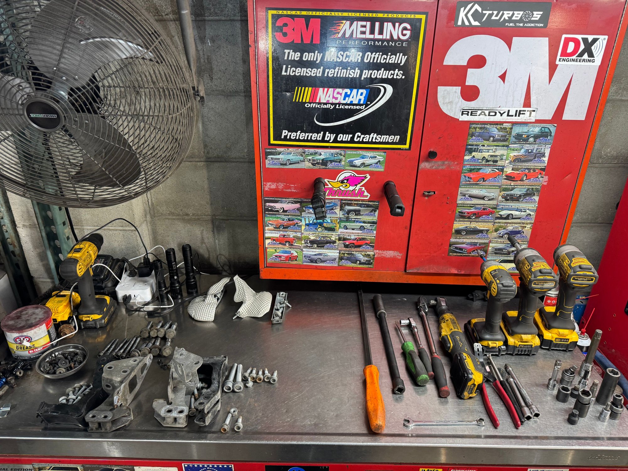

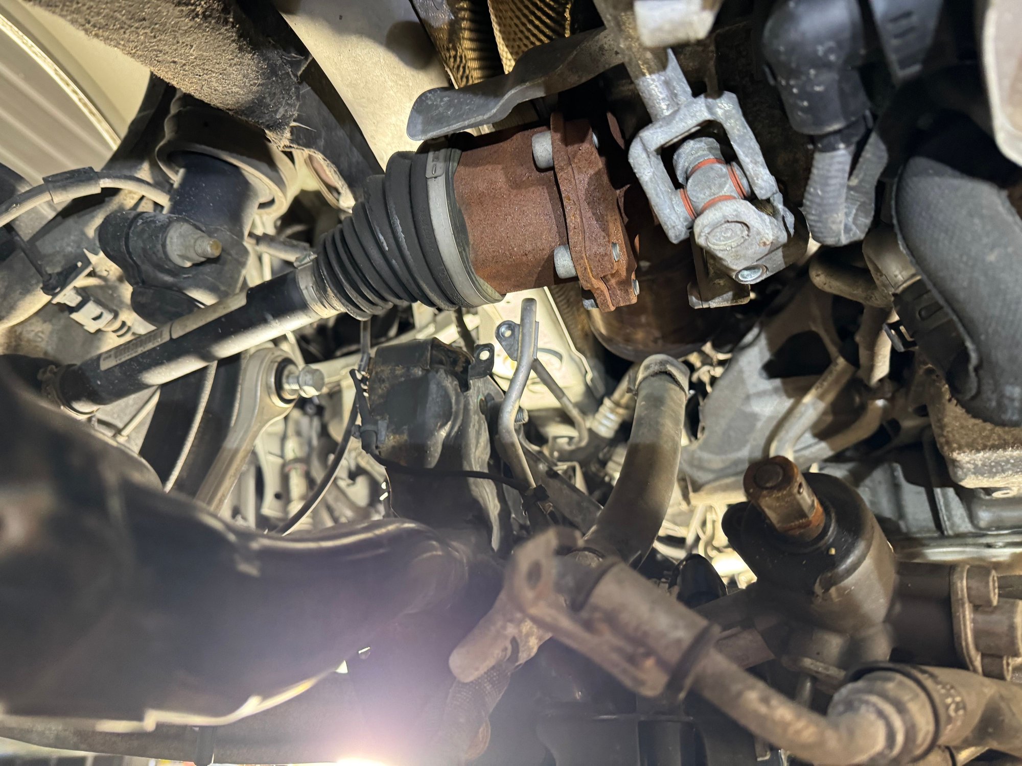

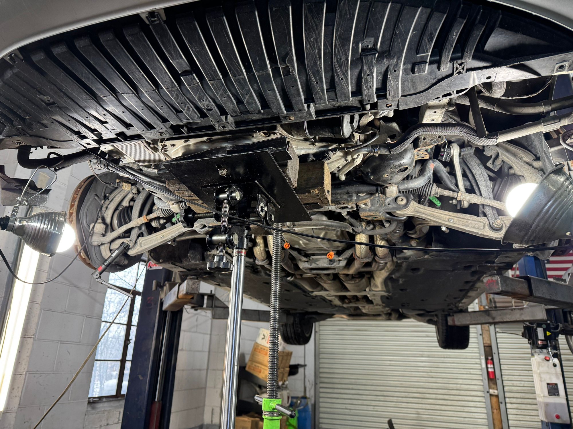

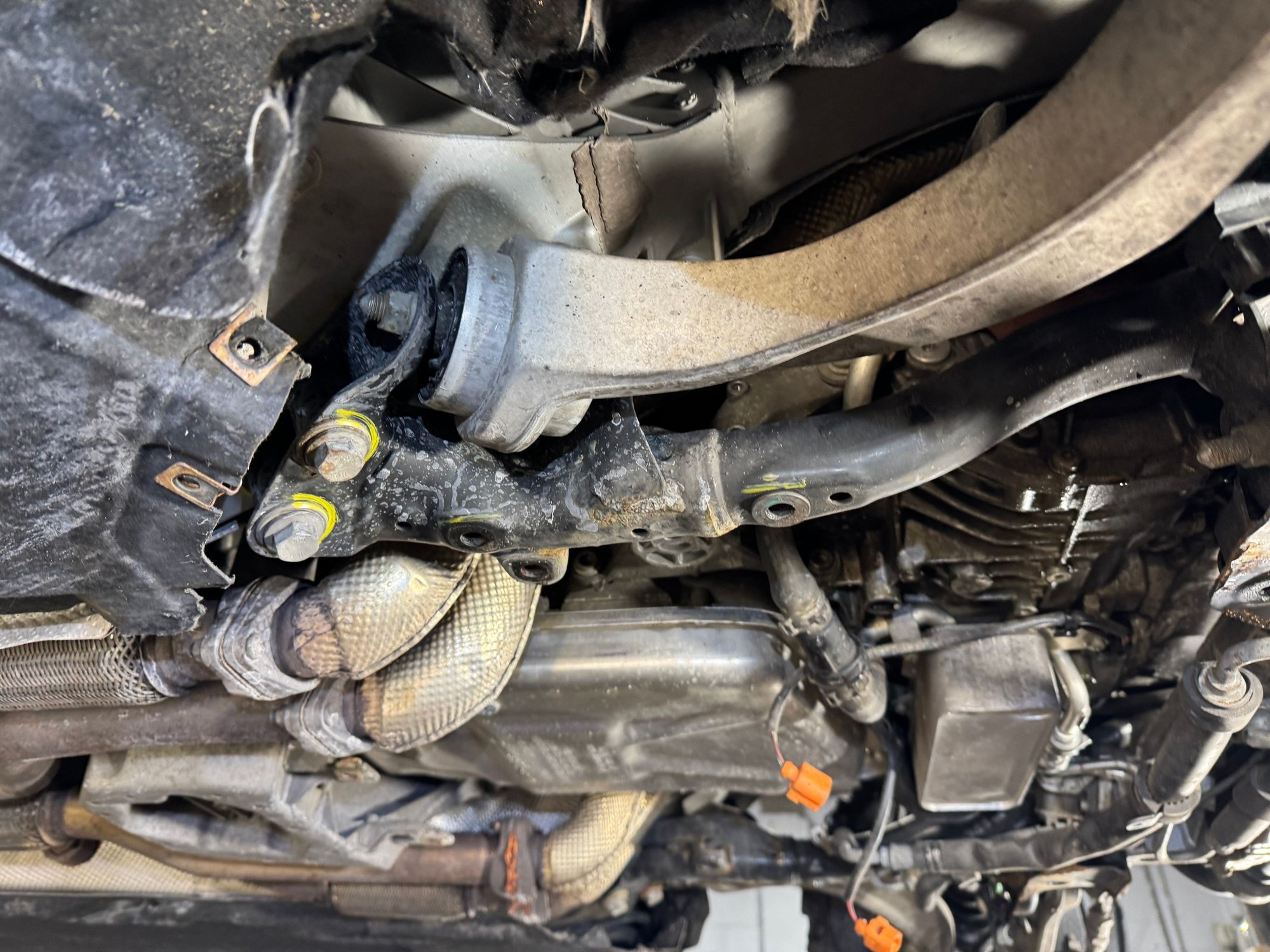

I'll have more pictures later, but it's not much more than this to swap all mounts out. Book time is the lowest for any of the engines that fit this chassis too
Finally got around to doing the mounts. For having a fully separated active it wasn't that bad lol!

Lol those mounts look like they cost as much as a 3-cylinder engine!
They are a few $$$$ haha!
I went OE so it's $325 for each active and $240 for the mains, you can get knock off Chinese made stuff for like 1/4 but I'm not going to play that game with this car.

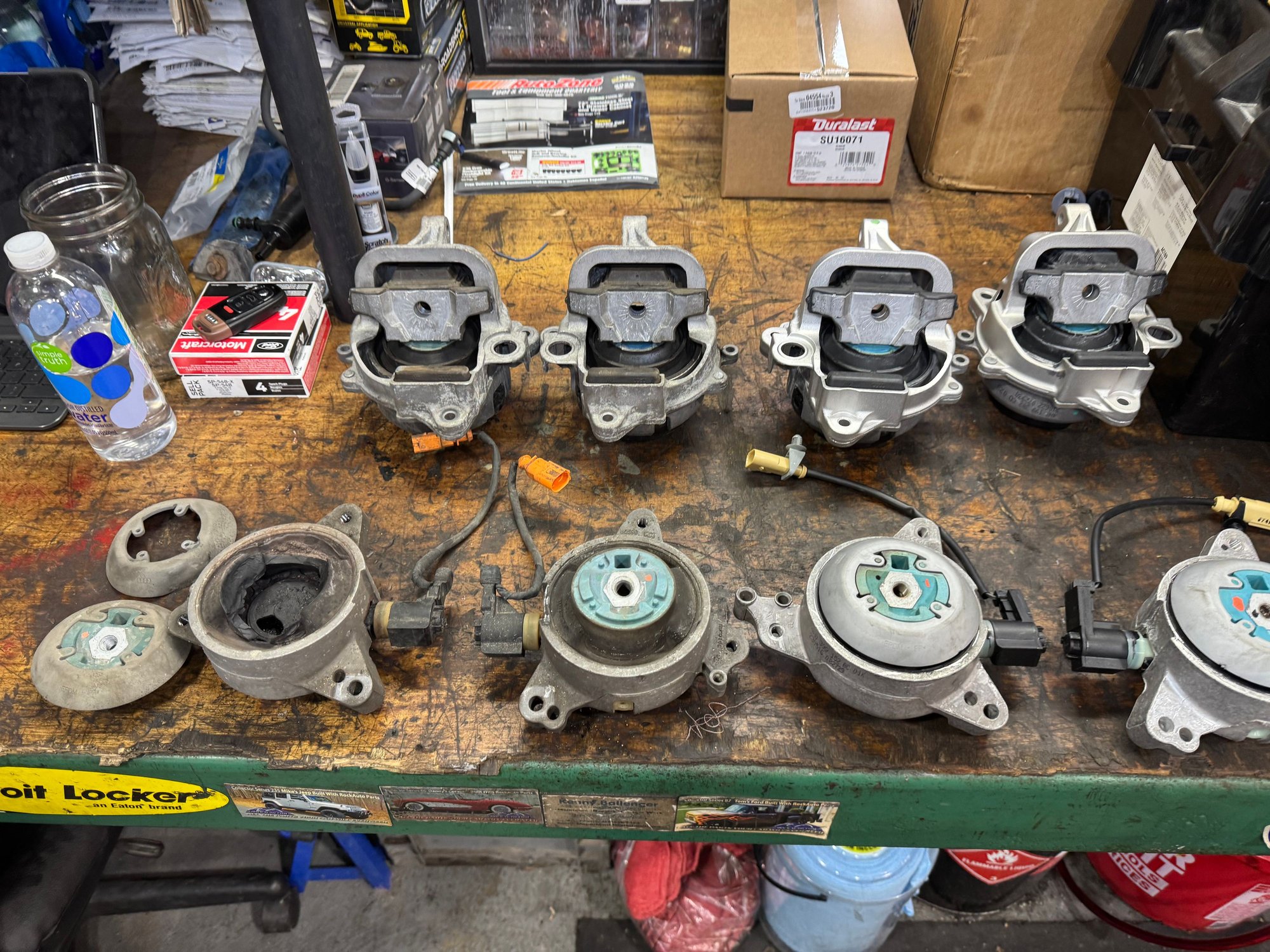

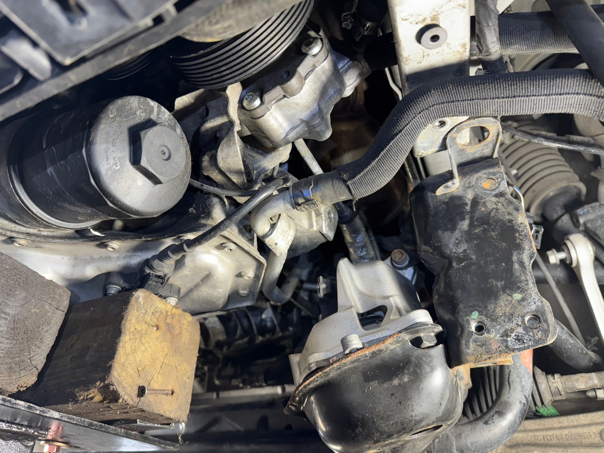

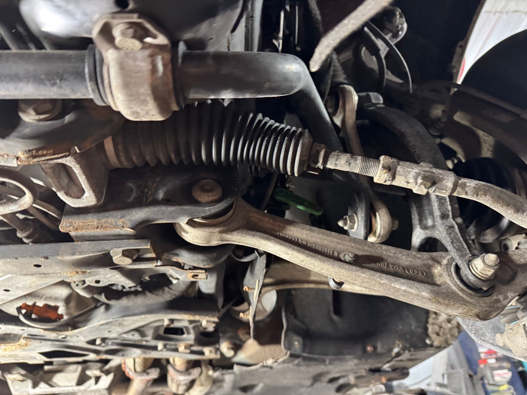

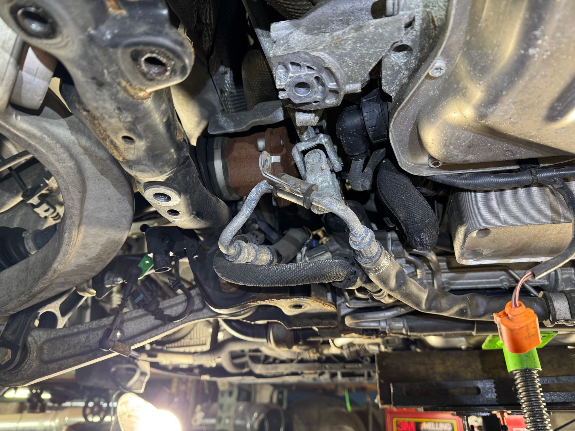

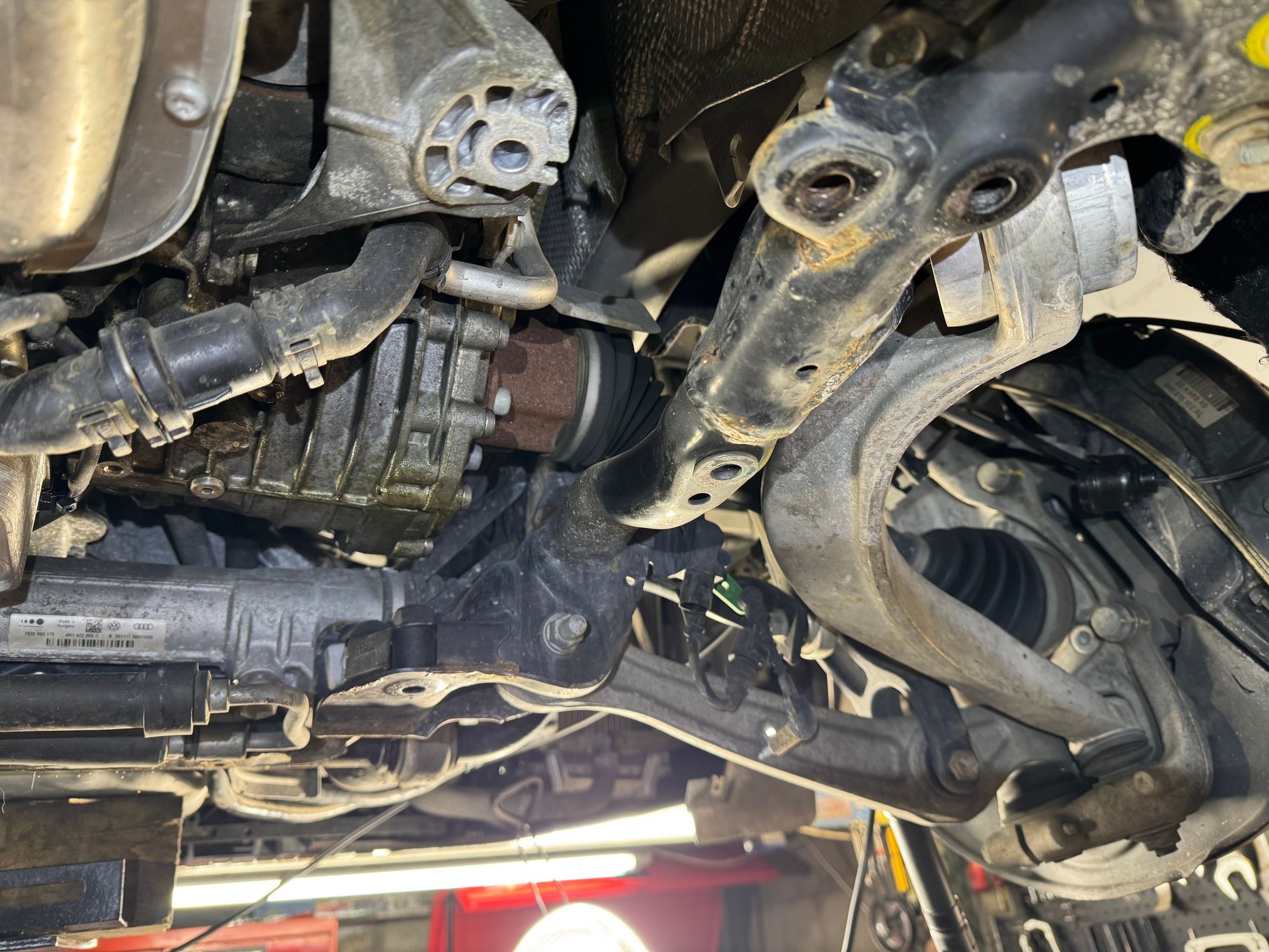

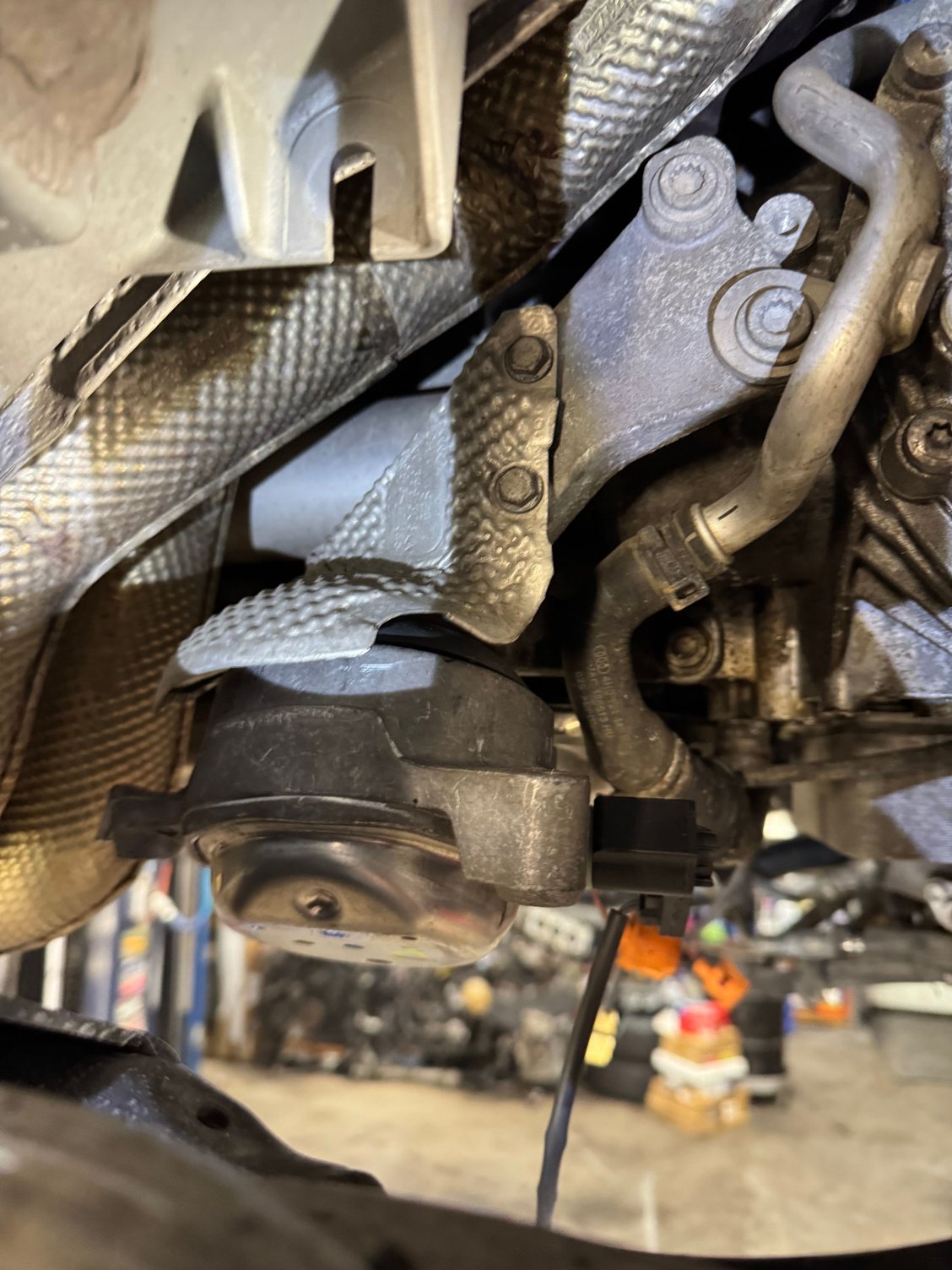

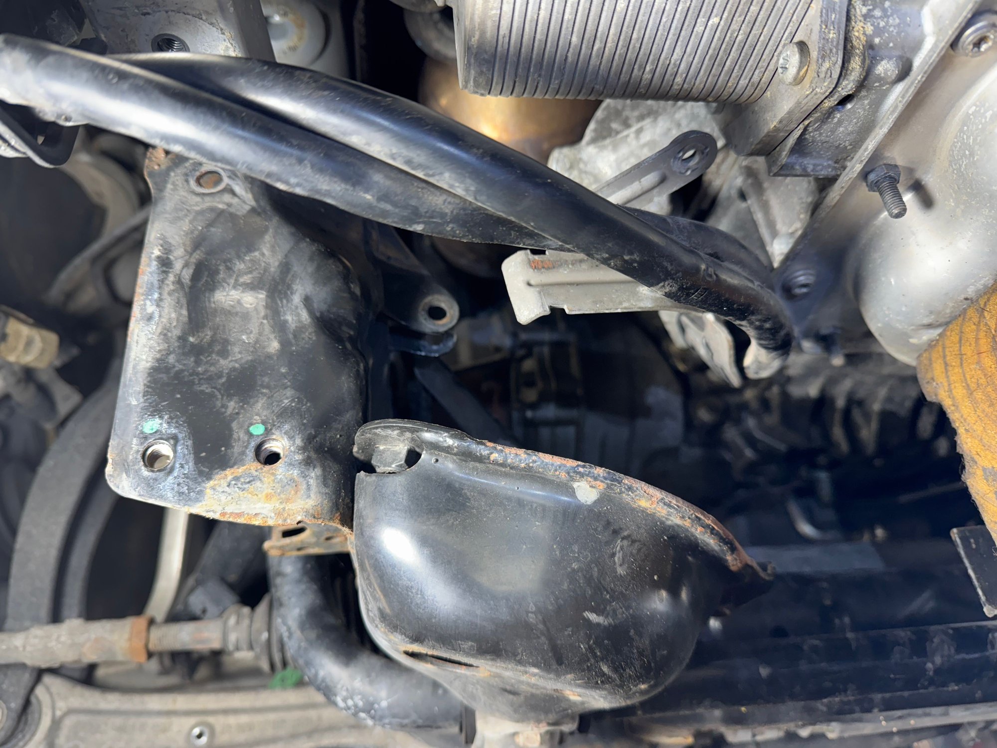

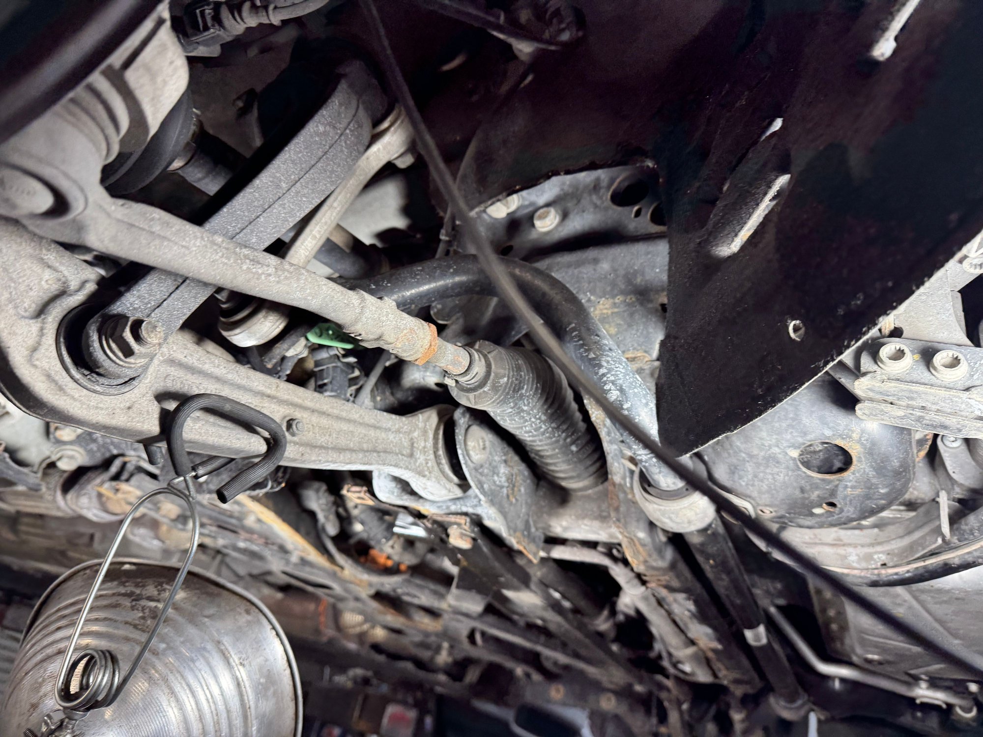

Some more pictures, I'm starting to get so used to working on cars like this it doesn't even register to me how complex they actually are until I see pictures like this. I could totally understand how it just looks like a million parts lol!

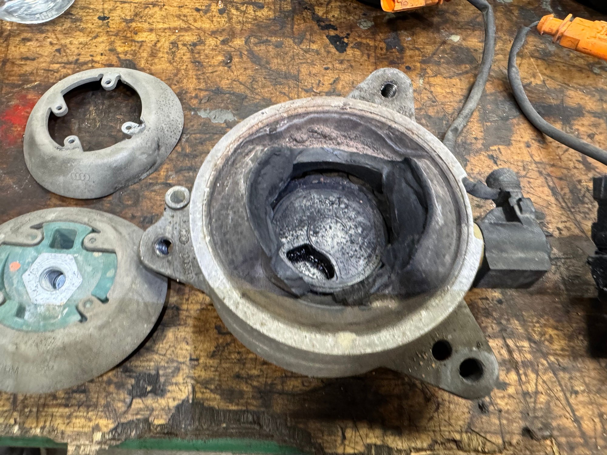

Very dead trans mount
Im actually stunned at the condition of the main mounts, they were almost totally fine. Not collapsed or hard at all, going forward I think Im going to say that the trans mounts are the ones to watch out for failures on.
I'm actually stunned at the condition of the main mounts, they were almost totally fine. Not collapsed or hard at all, going forward I think I'm going to say that the trans mounts are the ones to watch out for failures on.
I really think I'm going to take the car somewhere to be full CO2 cleaned, the dirt is really bothering me but if I do that then I would never want to drive it. Peak 1st world issue I guess...
I'm working on the W8 now and by comparison it's comically simple and has what feels like "excessive" amounts of room. I know it's still a very complex car in my head and all but man, I think I'm getting Stockholm syndrome or forced into a skill bracket by the 12s.
With the new mounts the engine is now smooth to the point it's disorienting honestly. I'm getting no feedback at all in comfort mode, gear indicator and RPMs just climb without any sound or vibrations.
Last things to do is new rear mufflers so I can actually hear the engine and to replace all the suspension arms. At that point all wear items will be new!

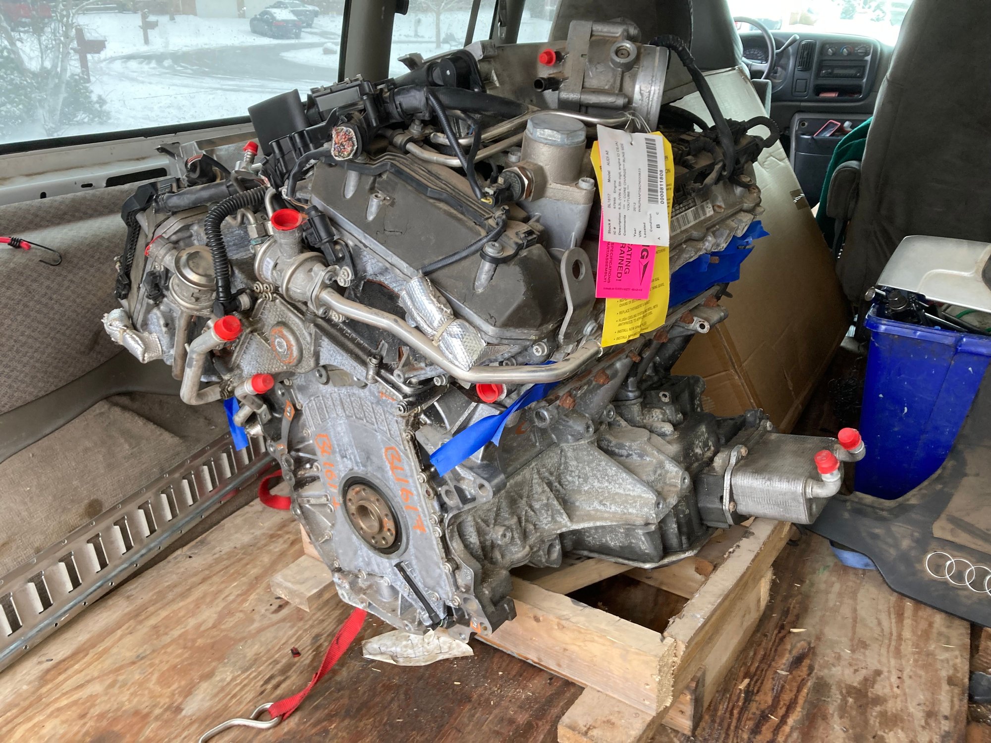

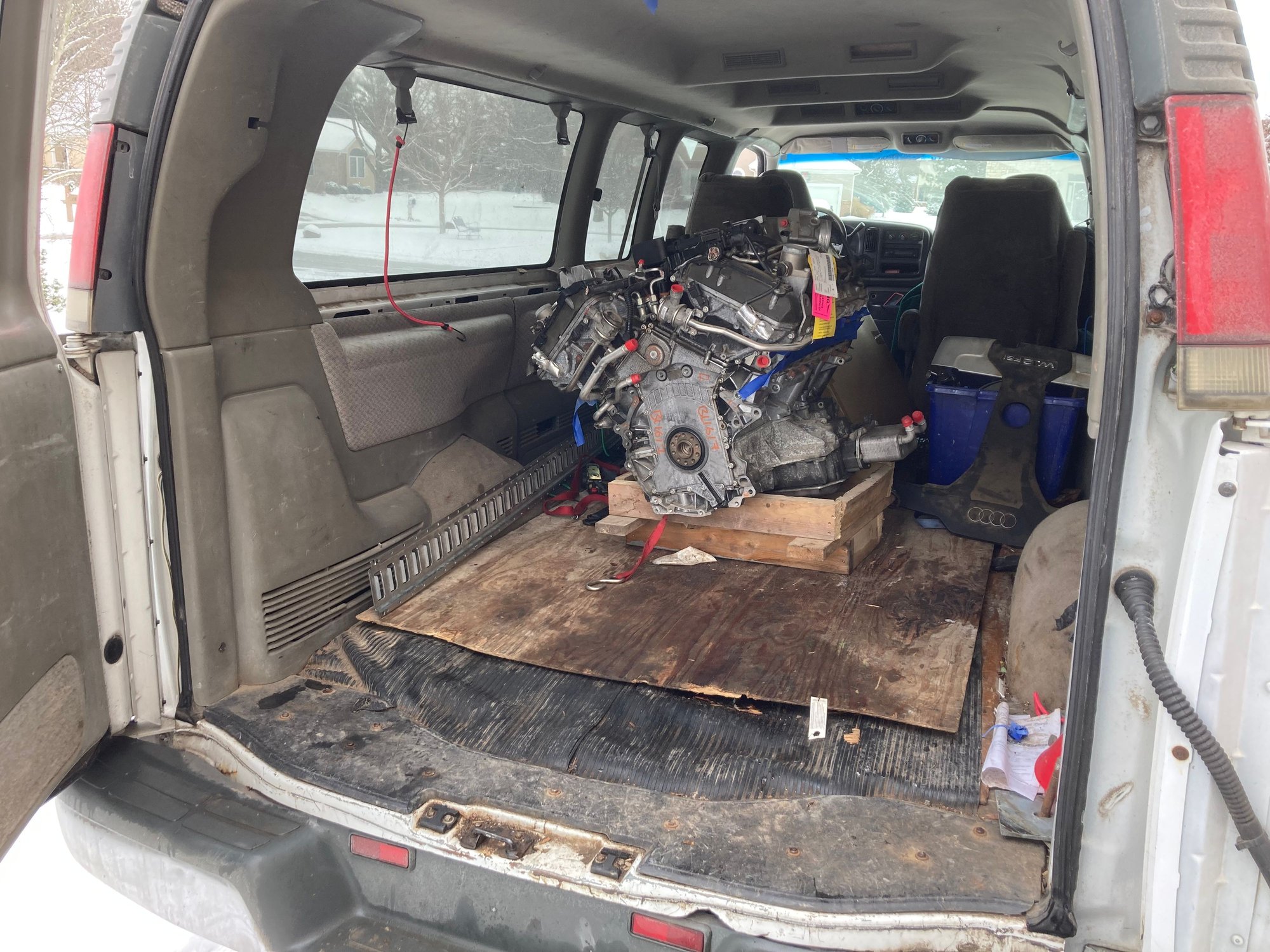

Got a 3rd engine!

Got a 3rd engine!
What is the point of having this engine?
