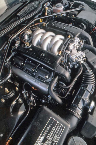

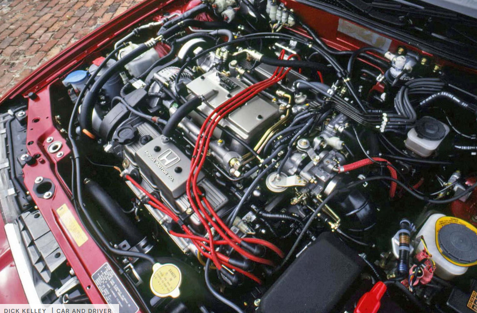

I believe one of the side effects of a transverse, FWD layout that you'll end up with unequal length drive shafts, which increases torque steer. Going with a longitudinally mounted FWD engine squares it all up and keeps both sides equal.
As a side note from up in the thread, I do believe the first Acura Legend was transversely mounted, and they went longitudinal on the second gen.
First Gen:
2nd Gen:

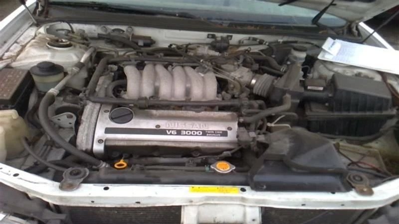

Thank you!!!! I fully understand now. Pretty sure my TL was transverse. It did have a limited slip differential and honesty the torque steer wasn't bad, but that car was fasssst. It was a 6 speed. You could always tell it was FWD. I think my 93 SHOs engine was Transverse too,,, My 97 maxima I'm not sure about but it sure had a sweet V6 and was a 5 speed. Torquey AF unlike that TL. Original VQ and probably the best one.
Here's the engine:

Yeah your SHO and Maxima would both have been transverse.
