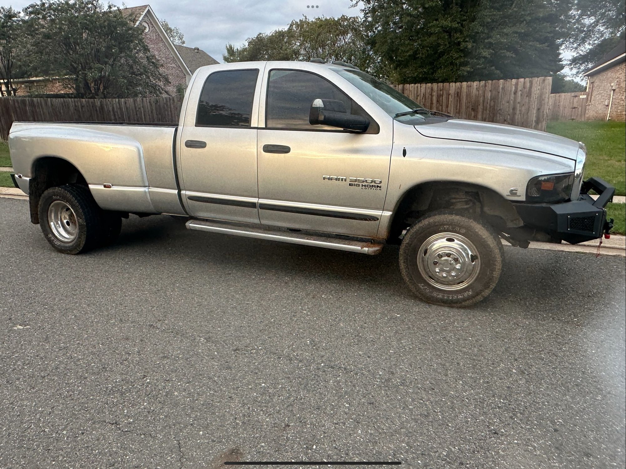

When the 300k CUMMINS is in the shop getting its tranny replaced you have to do what you have to do with ole reliable. Tundra pulls loads just fine. 4.30 gears
HD trucks are a pain to live with when not towing. Plus domestic trucks have more issues so the Toyota is a good compromise. And diesels are terrible if you have to pass any sort of emission testing

They are not a smooth ride especially unloaded. Also have to kill the engine at every drive thru. The 5.9 is loud!!

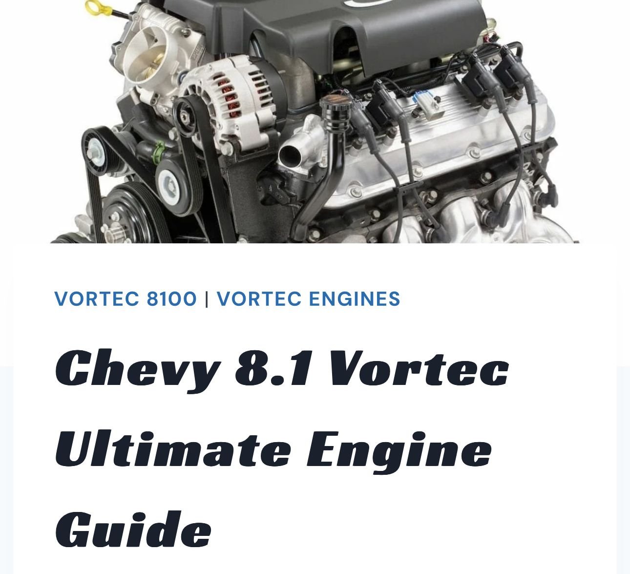

I would 💜 to try the Chevy 8.1. Wonder what it’s like to drive an engine that big?

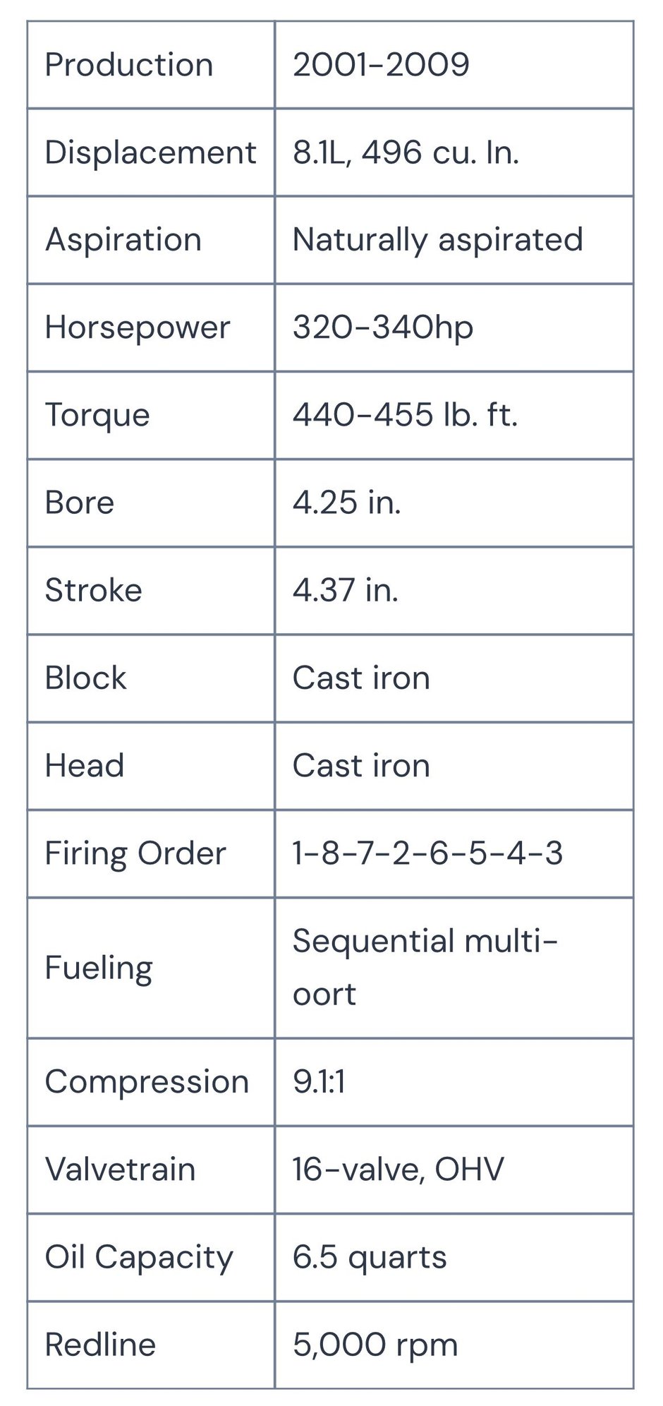

42 hp per liter? That's shameful.

If your design goal is specific output, absolutely. But then if that was the goal they would have used lightweight parts, high compression and an oversquare design to allow for a nice high (for the size) redline of 6500 or so, and power that surges as revs increase.
But that's not at all what this type of engine is about. It's about easy torque to pull big loads with minimal strain. So instead you have an undersquare design made of super beefy and very heavy cast iron components, with a 9:1 compression ratio. It has a very low redline of 5,000 rpm, but makes 400lbft of torque just off-idle (before 1,000 rpm), peaking at just 3,200 rpm.
This is exactly the kind of engine design you want in a truck (or RV, which is this engine's primary application) that's designed to spend its life working hard.

Agreed. Someone has to look up the gearing of the 8.1 Chevy. My 2UZ is low revving. Max 4800 for HP and TQ at 3400. The 8.1 is 4200/3200

What is your obsession with the 8.1? It's not a good engine, it was just a temporary solution and the 6.2 totally replaced it since the 6.2 had a 6 speed allowing better effective pulling and far less drawbacks.

I should have also added that the 8.1 is a 25-year-old engine, and an evolution of the 454 introduced in 1970 (itself a descendent of the original 1955 409/427 big block). It was discontinued 15 years ago, so of course it's outperformed by the 6.6L that replaced it, as well as Ford's 7.3L "Godzilla". But though the technology has improved to allow for similar outputs from those somewhat-smaller motors, the basic design goals remained unchanged: Make an engine that is both everyday driveable with low maintenance requirements, while nonetheless being able to easily pull a heavy trailer almost like a diesel when required.
This makes no sense. The 8.1 and 6.2 are totally different engines with totally different applications. The Vortec 8100 has never been available in the half-ton, and the 6.2L has never been available in the 3/4 and 1 ton. So in no universe is one a replacement for the other.
