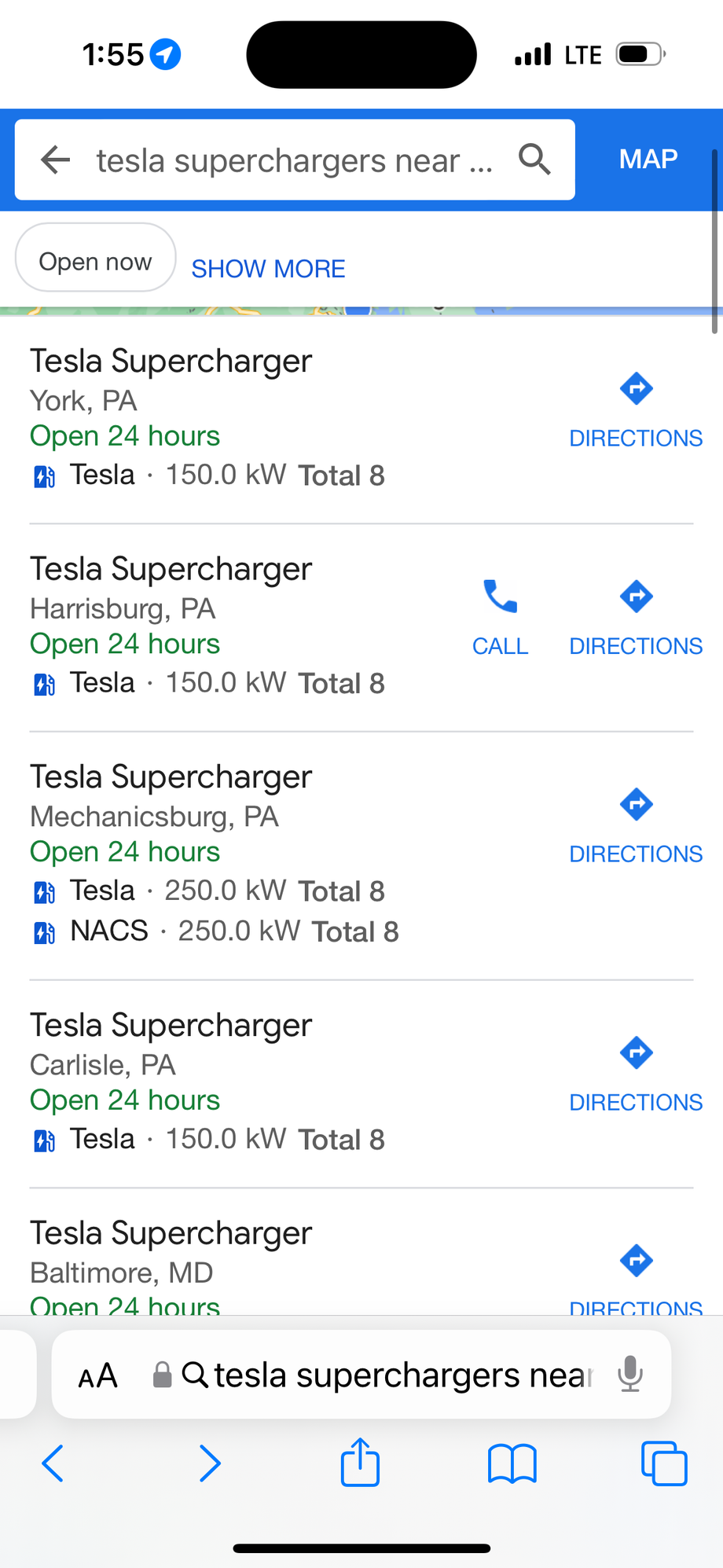

It was another 150kw/hr charger and I guess when all the stalls are being used maybe it makes it that much slower.
Here is a screenshot of the chargers near where I was. I used the Harrisburg and York chargers, both 150kw.
That's the answer, when someone is next to you sharing like Hameed said, you drop to 75kW, which explains why it's taking 45 minutes. Which is why I will drive a little further to 250 kW chargers, which btw don't share power. But it seems in your circumstance you didn't have a choice due to limited Tesla chargers. Had you hit a 250kW, you would have been out of there no more than 25 minutes, or even a lone 150 kW, maybe 30 minutes

They are too far apart. The one night I was going to drive to a 250kw charger it would cost me 40 minutes going there and back without adding in charge time to where I was. The crazy thing is is down further in my screenshot the one in Baltimore was only 72kw, crazy!
