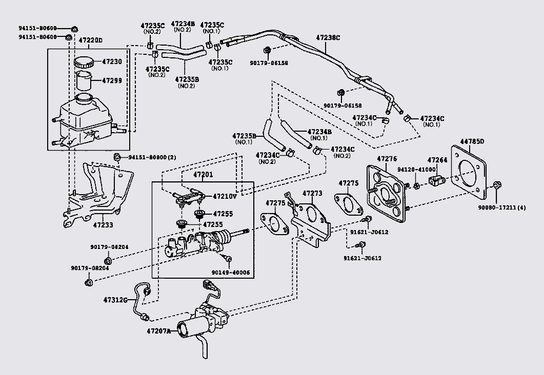

Brake by wire has been the case for hybrids (and not only) for over 20 years now.
That is not true brake by wire. Such a system has only an electronic sensor on the brake pedal is creates no mechanical force to move calipers. Toyota/Lexus hybrid has a conventional master cylinder combined with a brake force simulator and other components.
Same with steer by wire there have been a few cars with it but they still have a mechanical link.

It's a hydraulic brake-by-wire system.
Brake by wire or "by wire" in any system means electrical interface not mechanical.
Here is Toyota's hybrid braking system (partial)
As for Highlander I think the car is awesome I want one.

And here is a full diagram and not just a random page off the EPC:
Would you mind telling me how this is not a brake-by-wire system?

That's not brake by wire anymore than my Tesla has brake by wire. There is a fail safe that allows strictly mechanical pressure from the pedal itself. Diagram I posted is not random that is a 2015 RX, the same system used in every Toyota/Lexus hybrid.

...and the EPC diagram shows precisely nothing re: how the system operates.
And yes, this is brake-by-wire. The brake pedal has no direct effect on the brakes during normal operation. The ABS ECU reads some sensors (pressure & stroke) and commands solenoids to release high pressure fluid to the brake calipers as it sees fit. Yes, there is a failsafe - there is a mechanical interconnect failsafe with infiniti's steer-by-wire too, and it's not exactly a bad idea. The seized intermediate shaft that you mentioned is just somewhat unlikely compared to what can happen with a fully decoupled steer-by-wire system.
Good pic.
It looks like it has two M/C pressure sensors.
This may imply there is pressure in the master cylinder(M/C) as the pedal is pushed.
From there it looks like the pressure is metered electronically.
It's really hard to say, just a guess.
