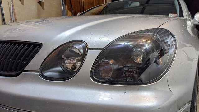

Ready for the retrofit! Just waiting on USPS to deliver my projectors...

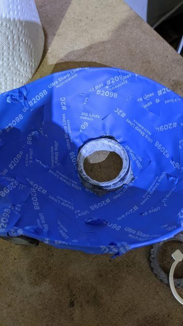

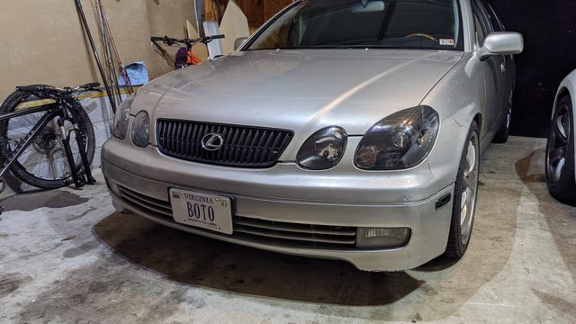

Still waiting on my harmonic balancer before doing the timing belt and front main seal, soooo retrofit done! Definitely time consuming, and had to do a lot of modifications to random bits. But overall I'm very happy with how it turned out.
Painted the bezel satin black. Not too shiny, not too matte. Decided to keep the orange reflector for an accent color.
Had to do a good bit of dremeling on the headlight bowl. That dust is *nasty*. And yes, I ended up smoothing it out nicer than it looks in that second pic.
Annnd skip a bunch of steps and boom! Done! Pardon the filthy car...
