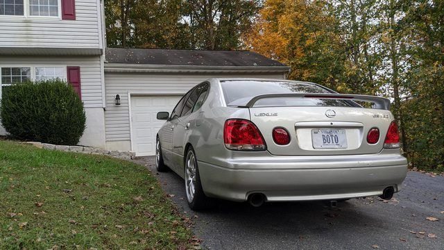

Picked up a *perfect* condition trunk with spoiler for $200 (and 7 hours of driving) to replace my spoiler-less, dented, scratched trunk Absolutely love how it changed the look of the car. If anyone needs a silver trunk without spoiler, let me know. I want it out of my garage, but hate throwing things away. Now I just need to replace all the other body panels...
Oh, and as a note for anyone else that comes across this wanting to swap trunks. The spoiler-less wiring harness DOES have a connector for the new brake light in the wing. Install could not have been easier.
