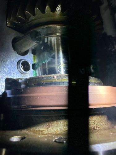

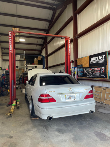

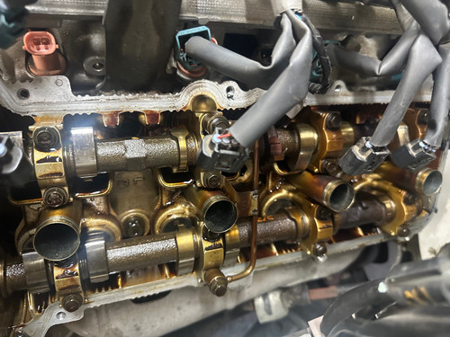

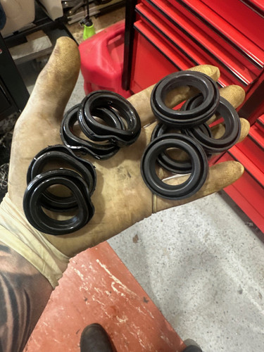

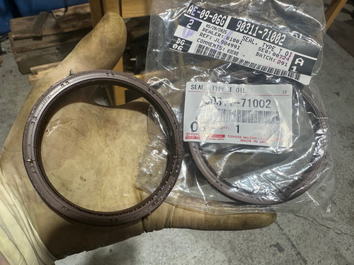

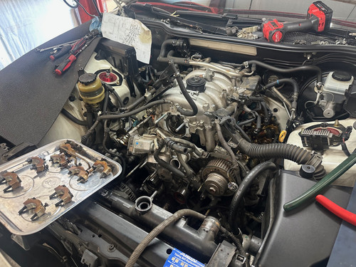

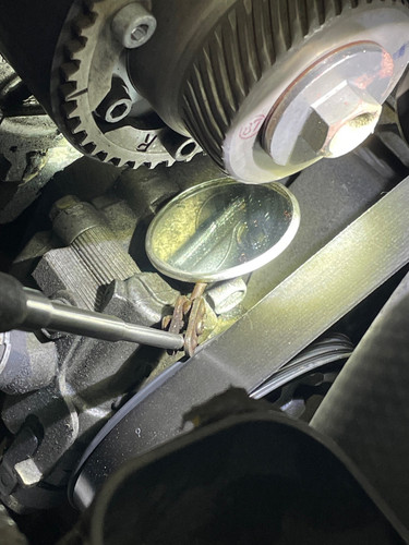

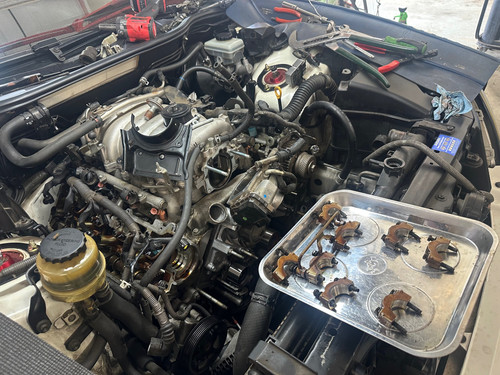

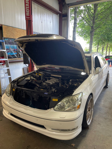

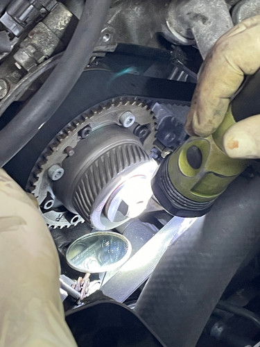

Default Timing belt / Waterpump + Cam seals
Hello Clublexus
Big news — I recently accepted a new position as an SAP Product Owner at Toyota Motors North America! They offered an amazing relocation package, so we’re moving to Dallas, Texas. We’ve already found a home and will be officially leaving Atlanta on July 25th.

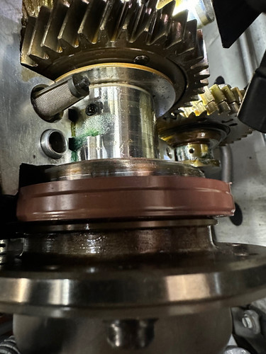

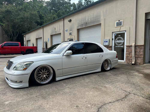

Before the move, I figured I’d get the car checked out by Dan at The Auto Lounge — turns out the cam seals on the passenger side were starting to leak. What was supposed to be a simple inspection ended up costing me a small fortune. But since Dan's the only one I trust with the car, I decided to go all-in with the classic "while you're in there" approach.
We ended up doing a full timing belt and water pump replacement, along with new cam seals. Since I had recently changed the spark plugs and valve cover gasket, there was no need to redo those. Dan also replaced a bunch of vacuum lines that broke during the process (one EVAP, two PCV, and two lines that go to the power steering advance valve). It was a big job, but now that it’s done, the car should keep running strong.
I’ve been toying with the idea of selling it — maybe getting an LX470 or a Land Cruiser — but for now, I’m keeping the LS. I might put it up for sale in Dallas. Either way, I wanted to make sure the next owner (or myself) wouldn’t have to worry about any major work, so I got it all taken care of. The car feels great, and Dan did an excellent job!
The car at Dan's shop ready for open heart surgery:
Pictures of the cam seal oil leak:
Some pictures Dan took:
The inside of the engine looked good for 220k - no sludge
New parts:
Note: The bright metal line is where the hard seal was starting to wear the gear - so its a good thing that we replaced them.
All done and ready to be picked up:
Mandatory wash:
I’ll be doing one last Buc-ee’s run with the Atlanta LS guys before the move — gonna miss this crew. If anyone’s in the Dallas area, I’d love to meet some fellow car folks out there!
Yann

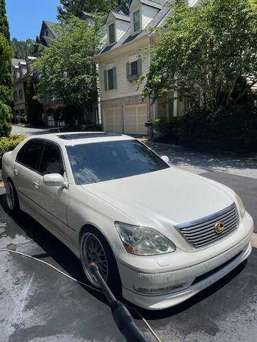

I also decided to clean the SMOG sensor as I dont think it had ever been looked at.
As i thought, it was very dirty:
I cleaned the filter and casing the best I could and refit it:
Last but not least, a couple pictures of her and clean and waxed...
