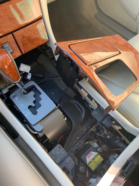

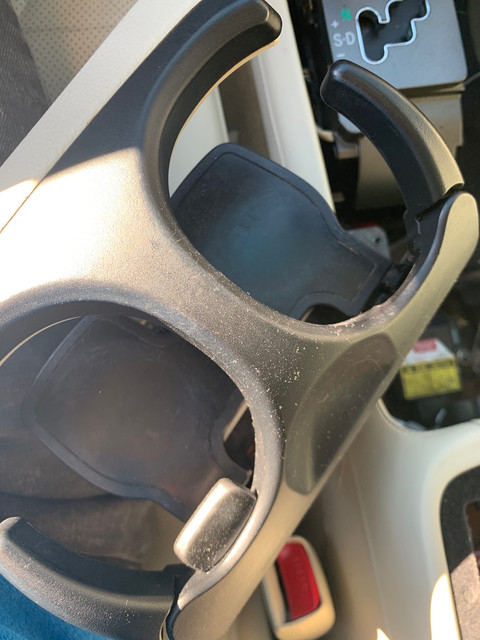

Quick little update - My Cup holders was missing a tab ( i guess the previous owner broke it) so I managed to get one from a donor car at a junkyard and replaced it
Remove the center console:
Remove the cup holder ( you can see which tab was missing) :
New tab :
All clean and shiny!

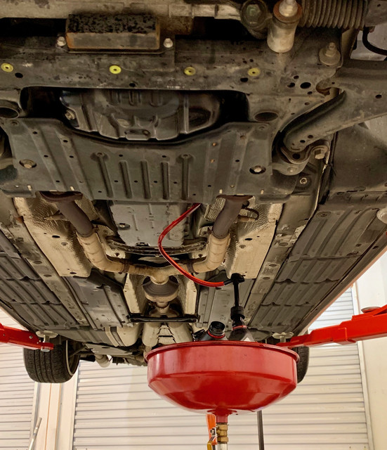

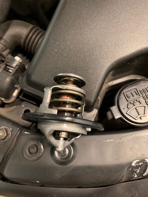

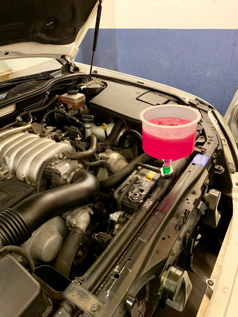

Little maintenance update -
1 - Replaced my thermostat as the car was slow to reach temperature (in cold weather)
2 - Did an oil + filter change
3 - Drained/filled some of the transmission fluid out as I dont think it had ever been done.
I reckon I will do another transmission fluid drain/fill with my next oil change in 4/5k miles.

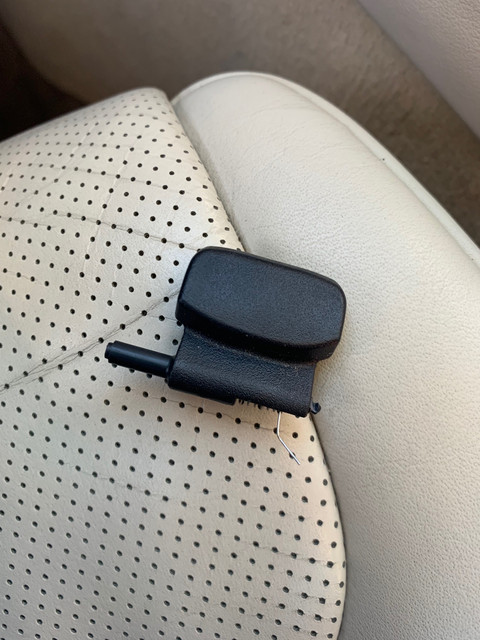

I also cleaned the little tab on the side of our seats as both driver and passenger side were very dirty!
