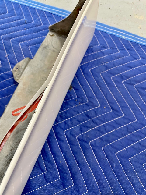

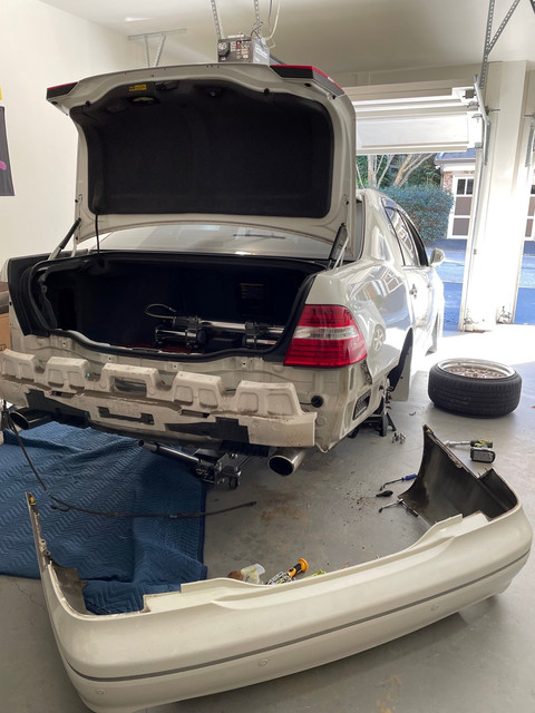

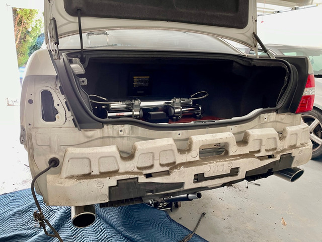

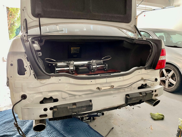

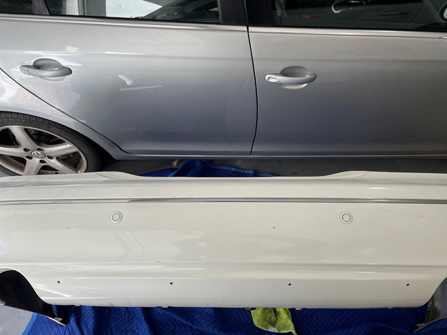

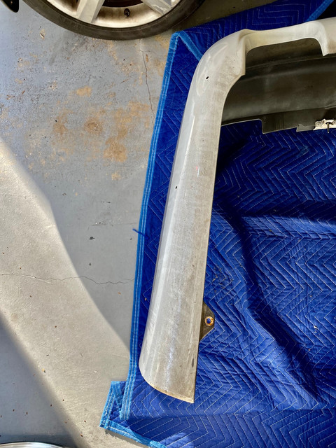

Default Celsior Kit - Part 3

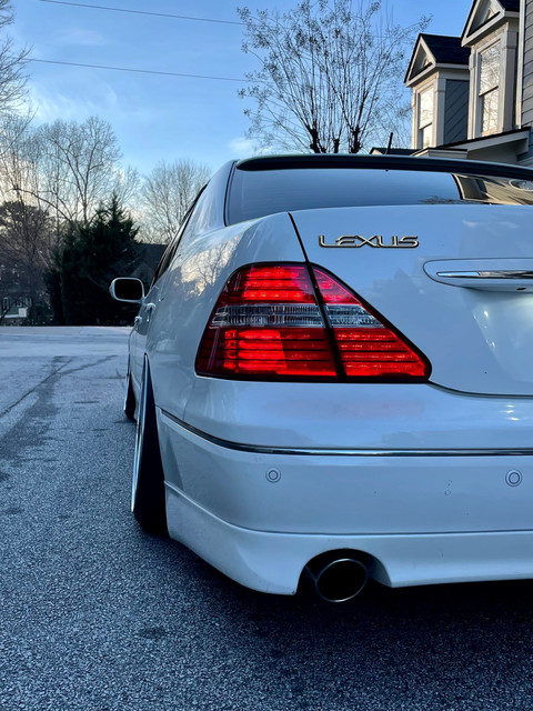

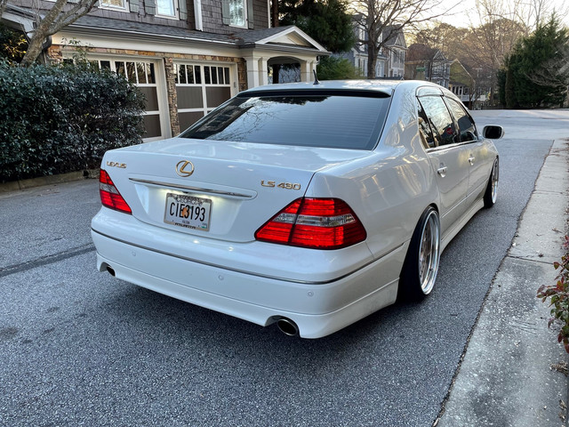

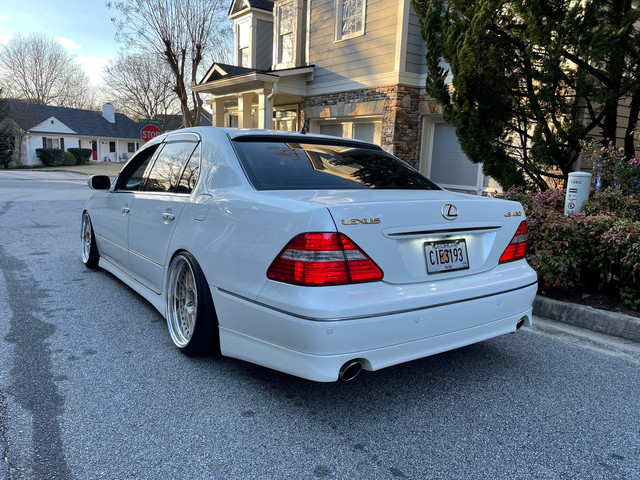

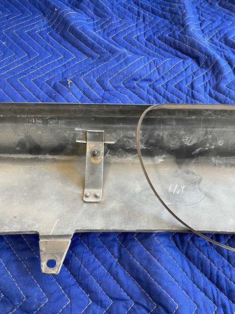

Hello,

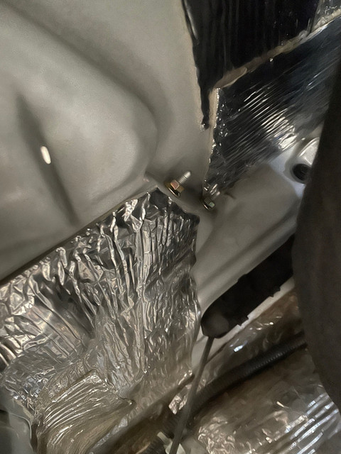

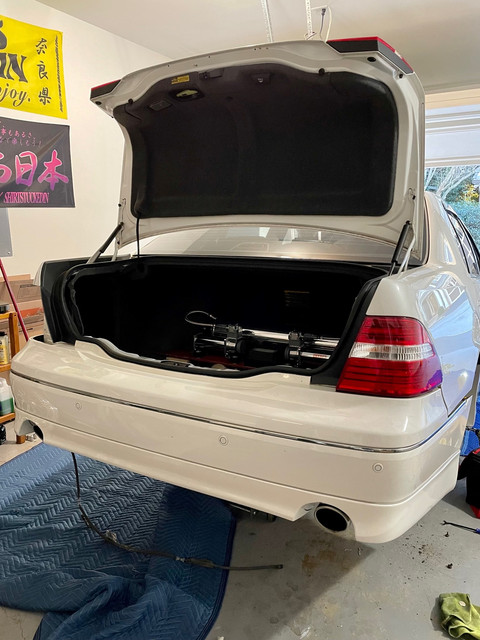

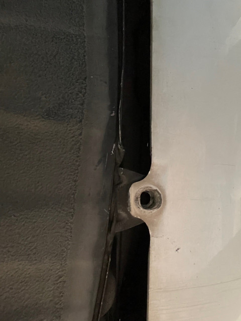

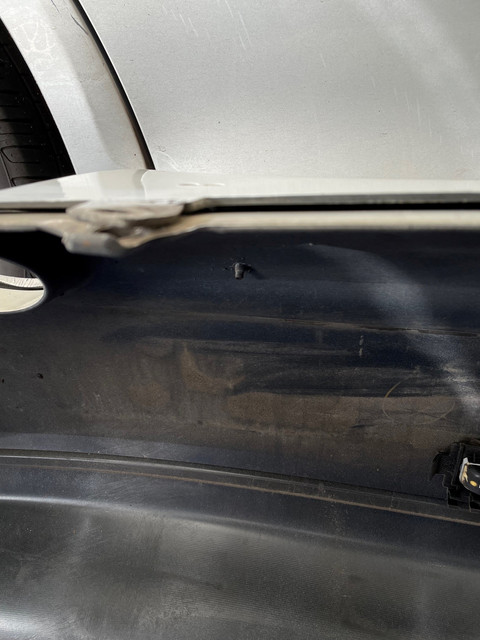

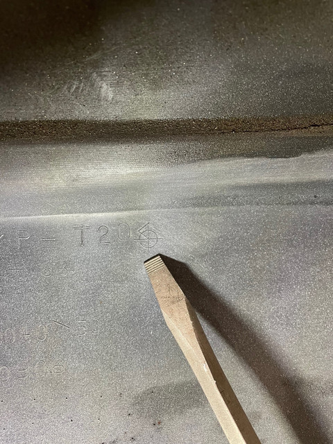

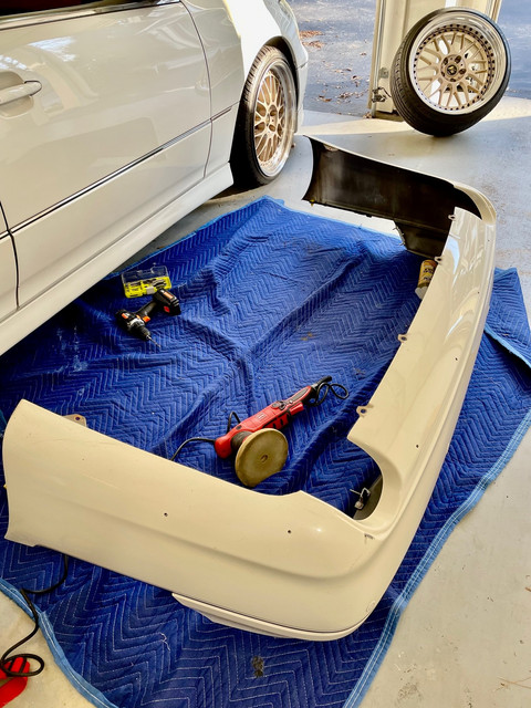

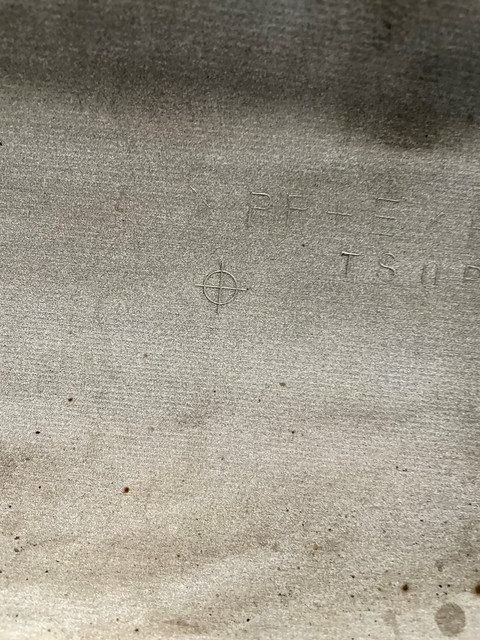

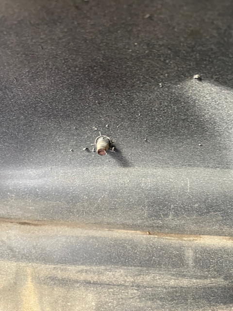

I finished installing my OEM Celsior Lip kit. As previously mentioned the rear bumper needs to have holes drilled which was a little scary at first until I found out that toyota actually has the exact markings where the holes need to be (THANK YOU TOYOTA) !
This post is picture heavy but enjoy!

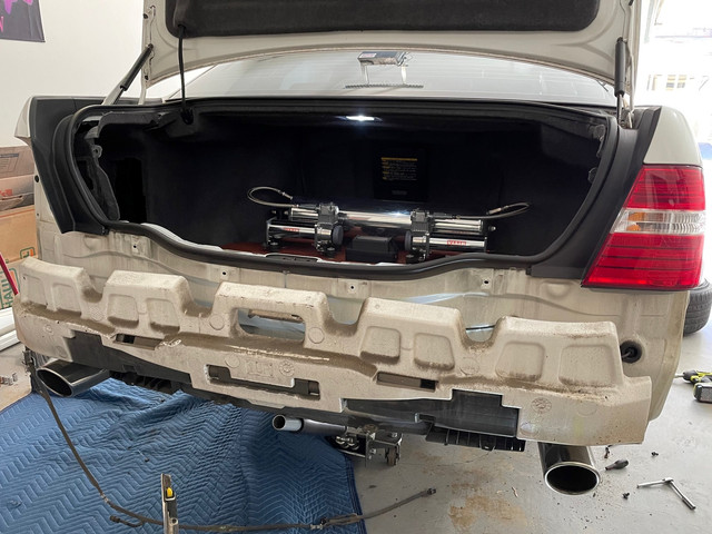

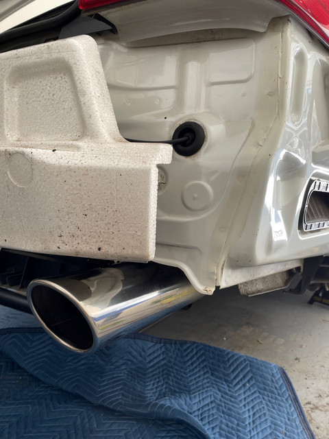

Started by removing the rear bumper:
Thank you Toyota for making my life easier and having the exact spot where to drill for the lip kit!

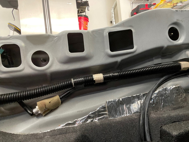

I also removed dirt from where the rear bumper sits:

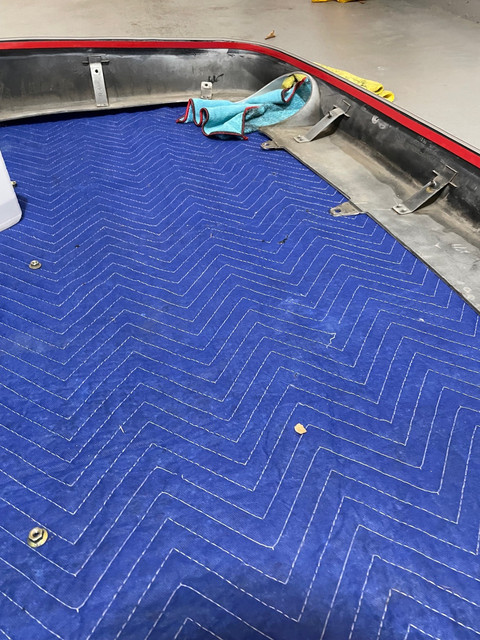

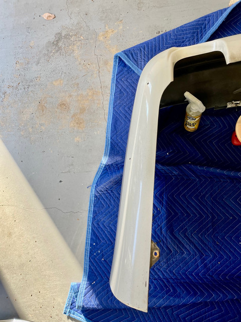

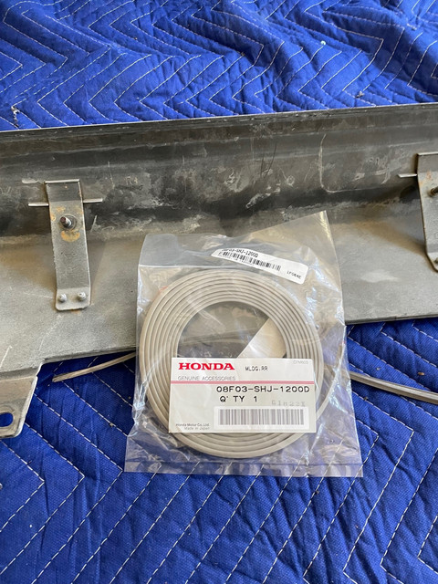

Just like the front I removed any old glue residue on the inside of the lip.
Replaced the seal between the lip and bumper (same part number I used in the front).
Old Feb 22, 2022 | 12:00 PM
  #230
YannG's Avatar
YannG
Joined: Jan 2014
Posts: 355
Likes: 180

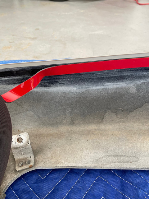

Default Celsior Lip kit - Part 3 continued...
Thanks to Shaun I was made aware that I also needed to add double sided tape on the inside of the lip kit and bought the following double-sided tape:

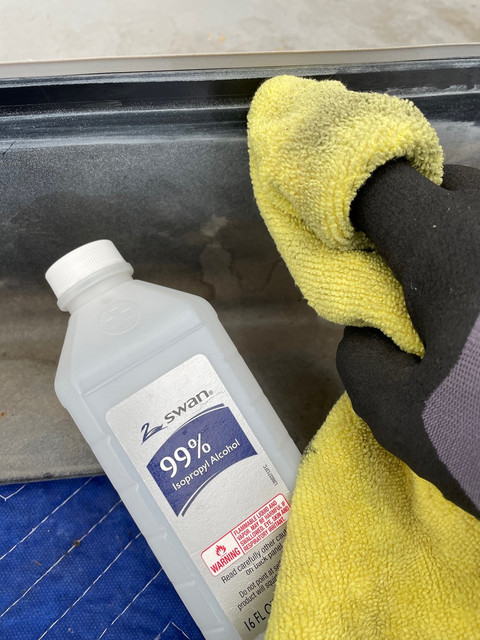

Removed any old glue residue with rubbing alcohol and a degreaser.
Quick test fit before putting everything back on:
I figured i'd also give the exhaust tips a quick polish:
End result : I am extremely happy with the outcome and thoroughly enjoyed the process.
All comments welcomed!
Thanks,
Yann.

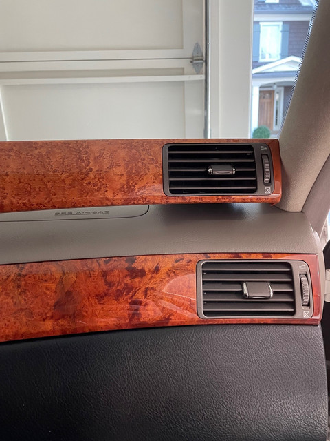

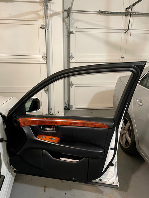

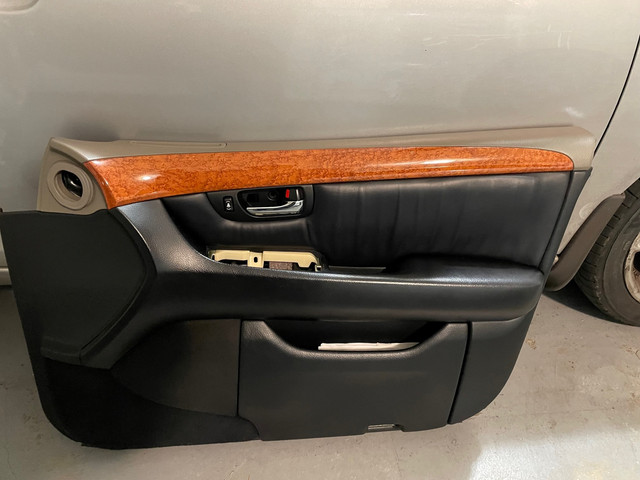

Default Tan to black interior swap

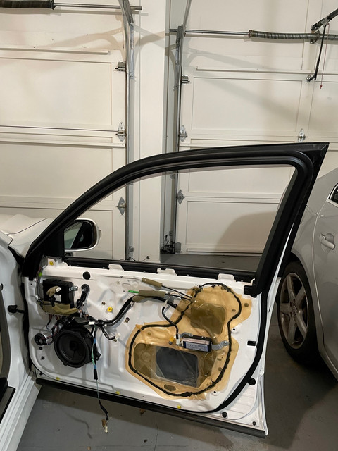

Hello,
Little update regarding my journey going from a tan to black interior swap!
I've decided to swap the wood from my birdseye maple to a darker/orange colored wood - Still unsure if I prefer it and I am struggling to find a matching steering wheel.

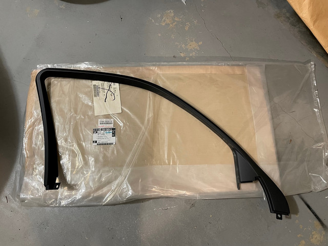

I was also missing the window garnishes and decided to buy the front ones brand new from Lexus - Turns out I bought the last 2 left in the country !!!
Differences in wood panels : left (newer darker wood) , right (current birdseye maple)

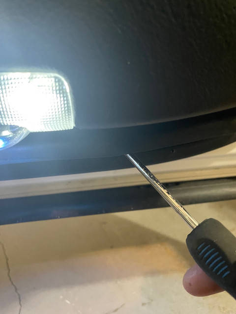

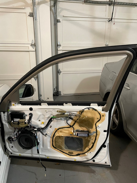

Now in possession of all 4 black window garnishes I got to work:

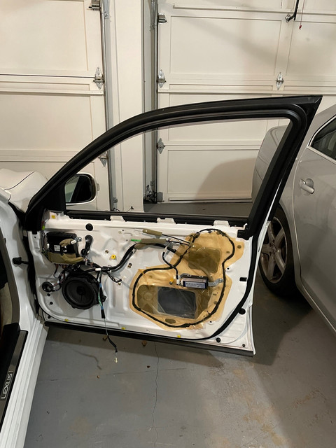

Brand new parts from Lexus that were actually wrapped in cotton!

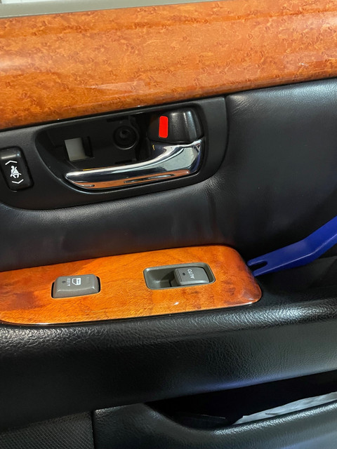

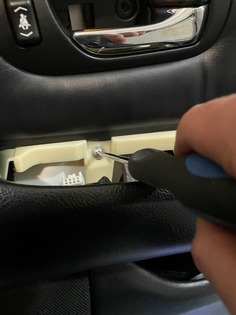

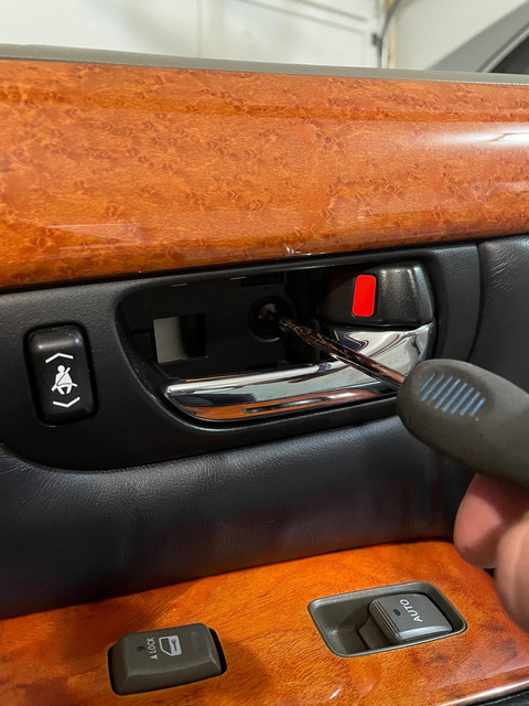

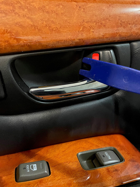

How to remove the door panel: Remove the plastic cover behind the door handle:
Remove the screw:
With the use a panel removing tool remove the window switch assembly:
Remove the screw:
Remove all 3 screws on the power part of the door panel.
Door panel removed:

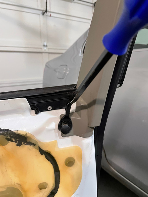

Remove both grommets holding the window garnish:
New window garnish on with new grommets:
Thanks,
Yann.
