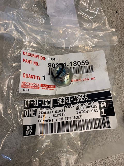

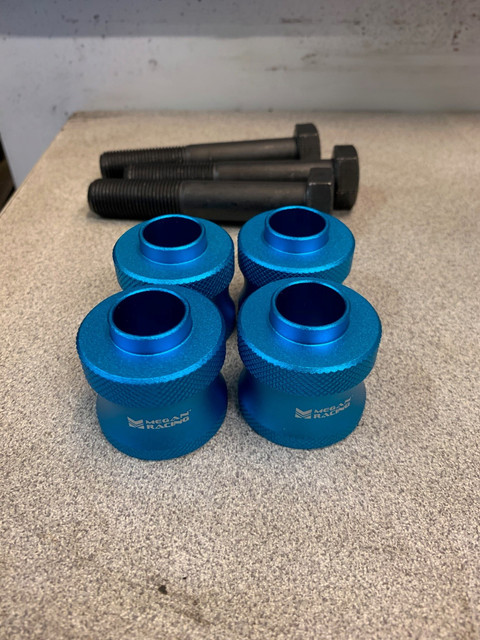

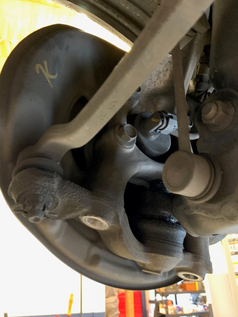

Default Update - Maintenance - Megan Racing RCA
Hello fellow CL members,
Hope everyone is doing well!
Little update - Did an oil+filter change, powersteering rack poly bushes, fitted some new Megan racing RCA and did my 3rd transmission drain/fill.
Next on the list is the valve cover gasket, I think the driver side one is slowly starting to leak!
(ps: special thanks to Dan @ theautolounge)
All comments welcomed!
Yann.

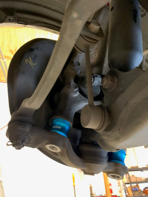

How difficult was the RCA install? I have a Youzealand SS Kit I need to install on my car.
Old Jun 11, 2021 | 04:56 PM
  #175
Ellesse's Avatar
Ellesse
Joined: Nov 2018
Posts: 623
Likes: 170
It's very straightforward, this helped (the rca is a single piece here but same thing)
If you're running less than a 19" wheel though there might be a clearance issue

Originally Posted by Ellesse
nice update! I installed those same RCAs a few weeks ago as well!
Nice work ! Did it lower your LS ? Lets see some pics
Its very easy, just remove the lower ball joint bolts and fit the spacers - just make sure you adjust the brake shield as it may rub on the disc.
https://youtu.be/ozx1c86JYDE
Thanks for posting that video!

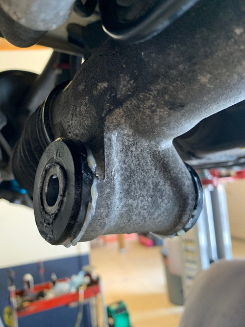

Great write up! How hard was replacing the steering rack bushings? Basic tools only?

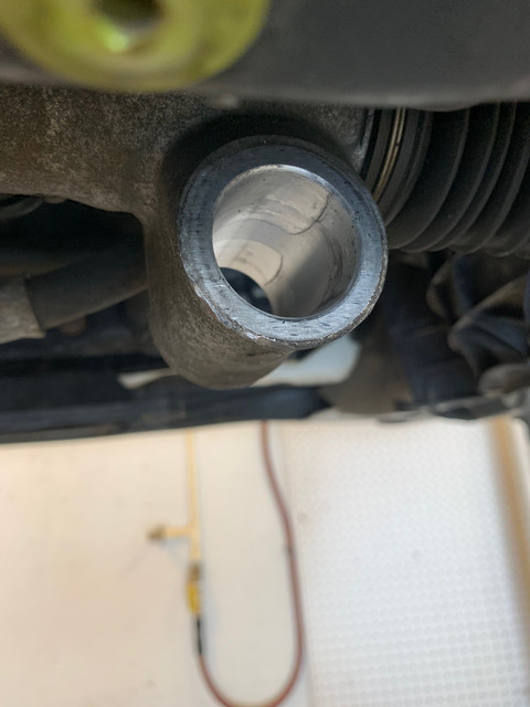

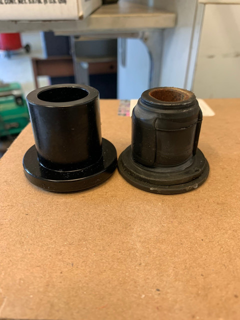

Thanks Wlpls430 ; Honestly kind of a pain! I had to use an air hammer - I would think using basic hand tools could be done, just be creative!
I have the same ones on my car. Basic tools. A good set of offset jaw pliers might be good for pulling them out as the OEM ones are stubborn. I also needed an alignment afterwards.
