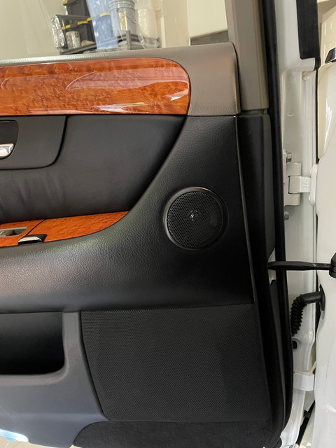

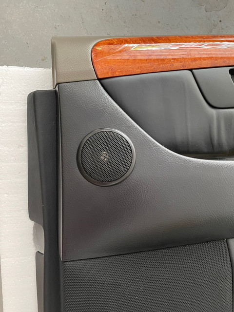

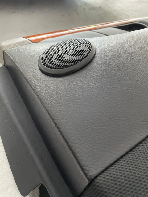

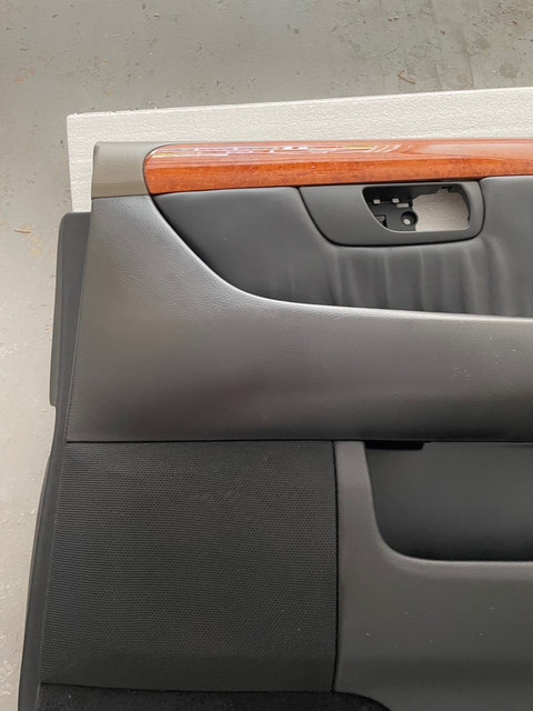

Default Update - Black Interior - Part 3
Hello Fellow Clublexus Members,

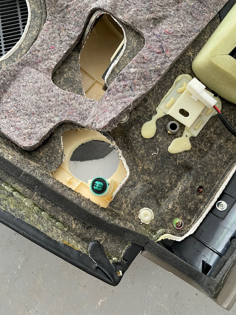

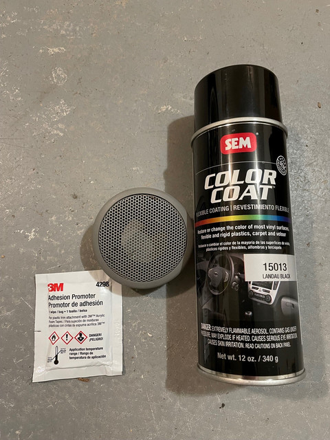

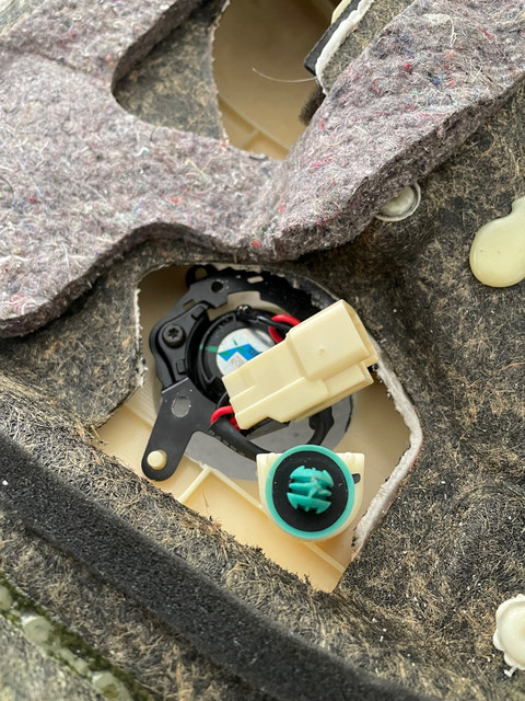

Update - The black doorcards I recently fitted came from an LS with no rear door tweeter covers. Turns out lexus have discontinued the part so I decided to buy a cheap doorcard from ebay solely for the tweeter cover, remove it and paint it black. Once the tweeter cover was painted I proceeded to drill a hole in the doorcard and fit the tweeters.
After thorough research on here I noticed Landau black was the SEM paint to go for, the color match is great!
You can see where I had to drill:

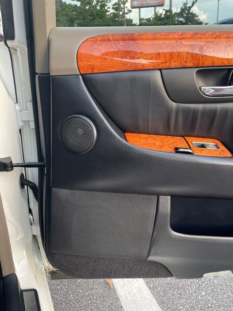

The end result:
As always, all comments welcomed.
(ps: I still have the other side to do)
Yann.

That looks factory, great job!

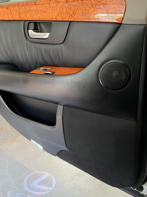

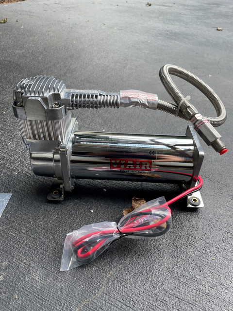

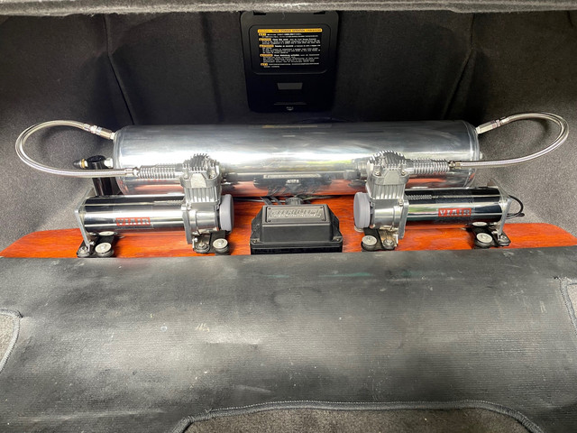

Default Update - Black Interior - Part 2.5
Hello folks,
Update - got the driver side rear tweeter cover painted/fitted - very happy with the outcome !
One of my compressors was on its way out so i replaced it with a new one:
Thanks,
Yann.
