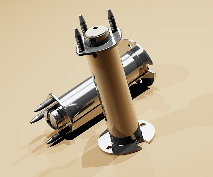

Speaking about billet brackets.. It sure would be nice if UAS would built some rear upper billet brackets for the GS
Made a render here..

RGARJR thats is sweet! What software did you make it with?
To the OP, I suggest you get the brackets, you don't want your bags to rub.
We are working on doing a fully fabricated upper mount, but we havn't finished it yet . I would love to do a mount that looks like that one, but i would be scared at the price tag on it...

That's good that you guys are working on some. You have any clue on the ETA on them.
