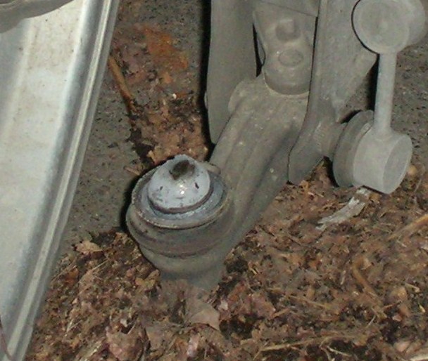

Originally Posted by kevin.tran
second picture
I have had several conversations about these failures. There is no doubt that they are occuring BUT what is it that is breaking? Are they truely breaking or are they wearing out I know that seems like an odd statement BUT. If they are breaking then that shows material problems. If they are wearing from being ackwardly binded then that would be a design issue.
The only theory me and my friends can come up with is that the joint is rubbing itself thin and then breaking. Can anyone come up with a mode of failure for these joints?
Kevin I would love to see a close close up picture shot of the broken peice of the ball joint.
I have replaced mine at 78k, I could not tell the difference before / after. I could not feel any slop in the joint I have the old ones and I am actually sorry I wasted my time and more so money replacing them.
I never heard any clunks or squeeks etc. I was just scared my wheel would end up 90 deg out of turn.

kevin.tran's Avatar
kevin.tran
Joined: Sep 2006
Posts: 574
From: CA/WA
j.tom:
I posted the link for the DIY ball joint replacement on page 4 please go look for it. It should have pictures on there.
bmpiazzola:
I attached a close up picture of the ball joint for you hope it helps if not let me know and I'll try to enlarge it if I can. Also let me know what you've come up with.
g4inrich:
This happend to you to? Where it accutually gave out like mines did? If so post some pictures and we'll take in acct. what happend because we're trying to bring it up to Lexus's attention.
If anyone know someone that this had happend to refer them to this post. Thanks.
