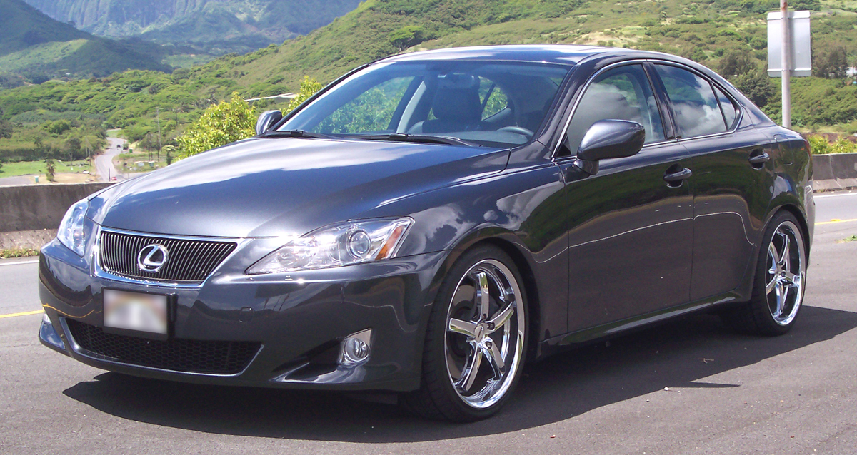

I just had my springs installed today from Eurosport in Honolulu they did a excellent job there are a couple of things with the install that were unexpected.
1.Test drove the car around the block and I heard noises coming from the rear.
I took the car back to Eurosport and they told me exactly what the problem was right off the bat, they said due to the way the springs are designed that they would have to wrap the coils with these rubber sleeves and that would eliminate the noise. That did the job and I dont have any noises at all from the rear .
2. AFS light.
The second thing that I noticed is that the AFS light blinks on the dash, I guess the car has a sensor or something that detects the ride height of course I dont know what that has to do with the lights but it is flashing and slightly anoyying but I can live with that. So to anybody out there considering dropping their car with AFS lights this is what you can expect. Personally I dont care for the AFS headlights when I first picked up my car I tried to disable it and even when you disable it through the system the AFS light still flashes red. I really wish that Lexus would design these things (( AFS,TPMS,VDIM etc. )) so that you can disable it with out anything flashing in the dash because its distracting when you are driving and something red is blinking on the dash. I really do like all the gadgets that the Lexus comes with but there should be an unobtrusive way do disable these things ((AFS TPMS VDIM etc. )).
To sum it up I am very happy with the ride quality and the way the car looks Eurosport also did an excellent job, they are very professional and curteous I highly recommend anybody on the Island of Oahu to pay them a visit if you are thinking of purchasing some rims or lowering your vehicle.

I hope I didnt turn you off with posting the problems with the install I just wanted to let people know what may happen with the spring installation. On a bright note the ride is really good and their are no noises at all after they put the sleeves on. Even with the AFS light flashing I am still very happy with the outcome, a couple guys with the GS 3 had the same problems with the AFS and all they had to do was do some type of adjustment they said it took their mechanic only 5 minutes to fix it.
