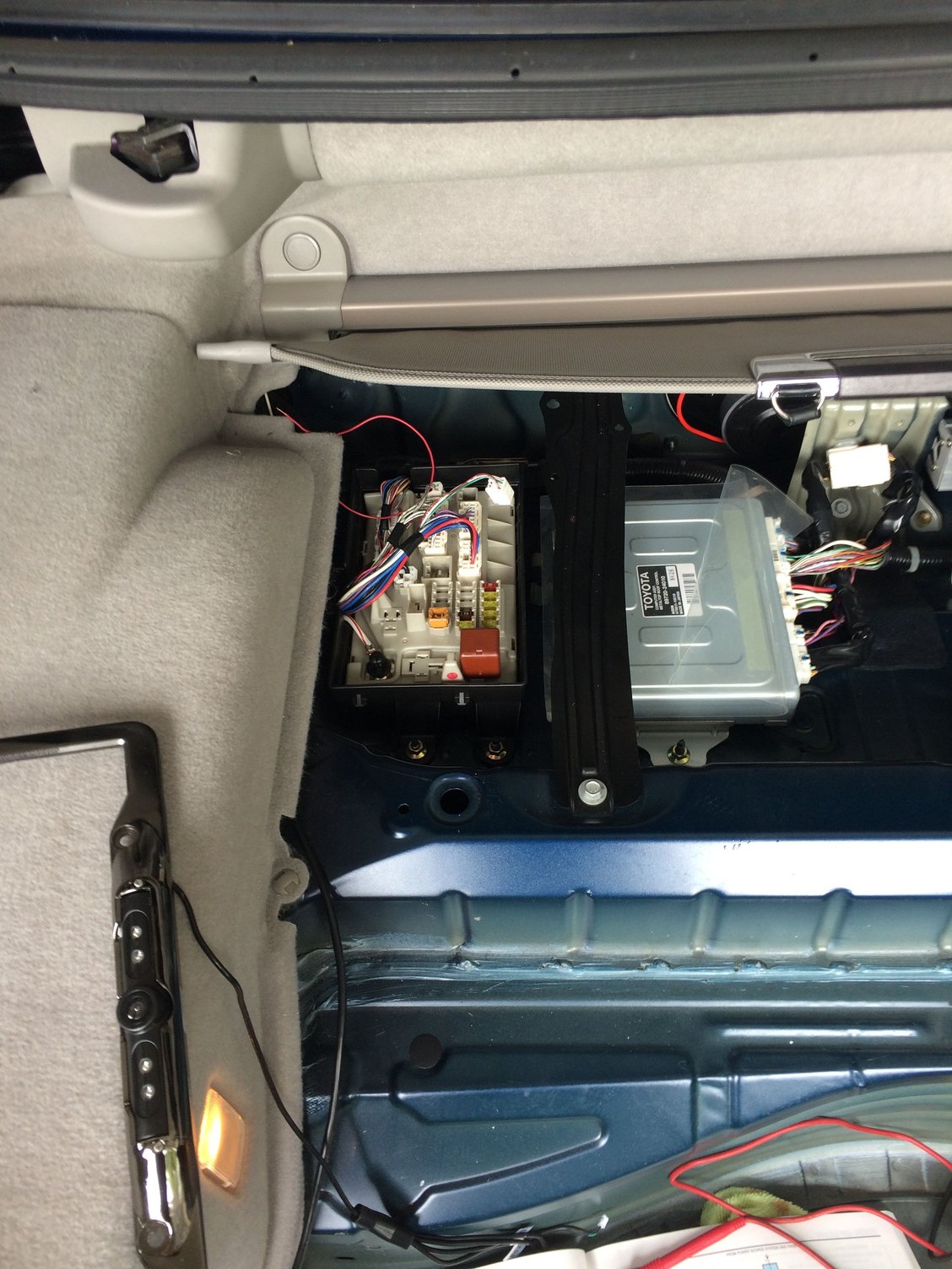

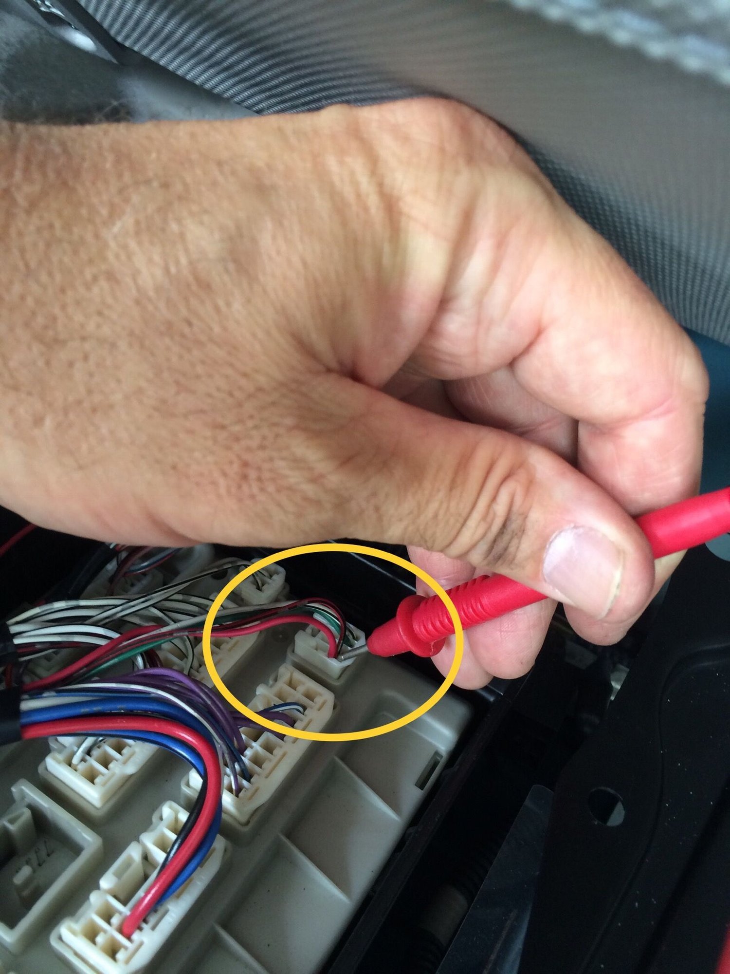

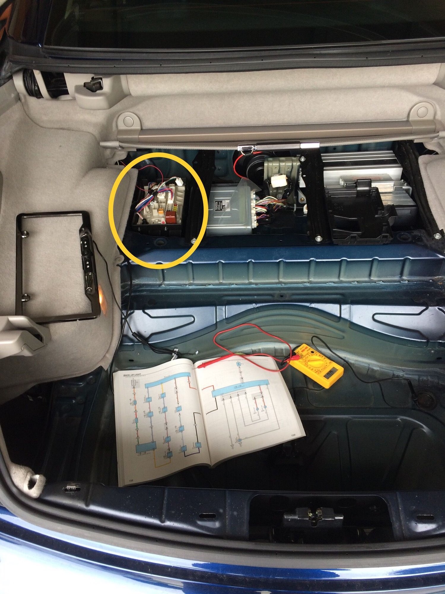

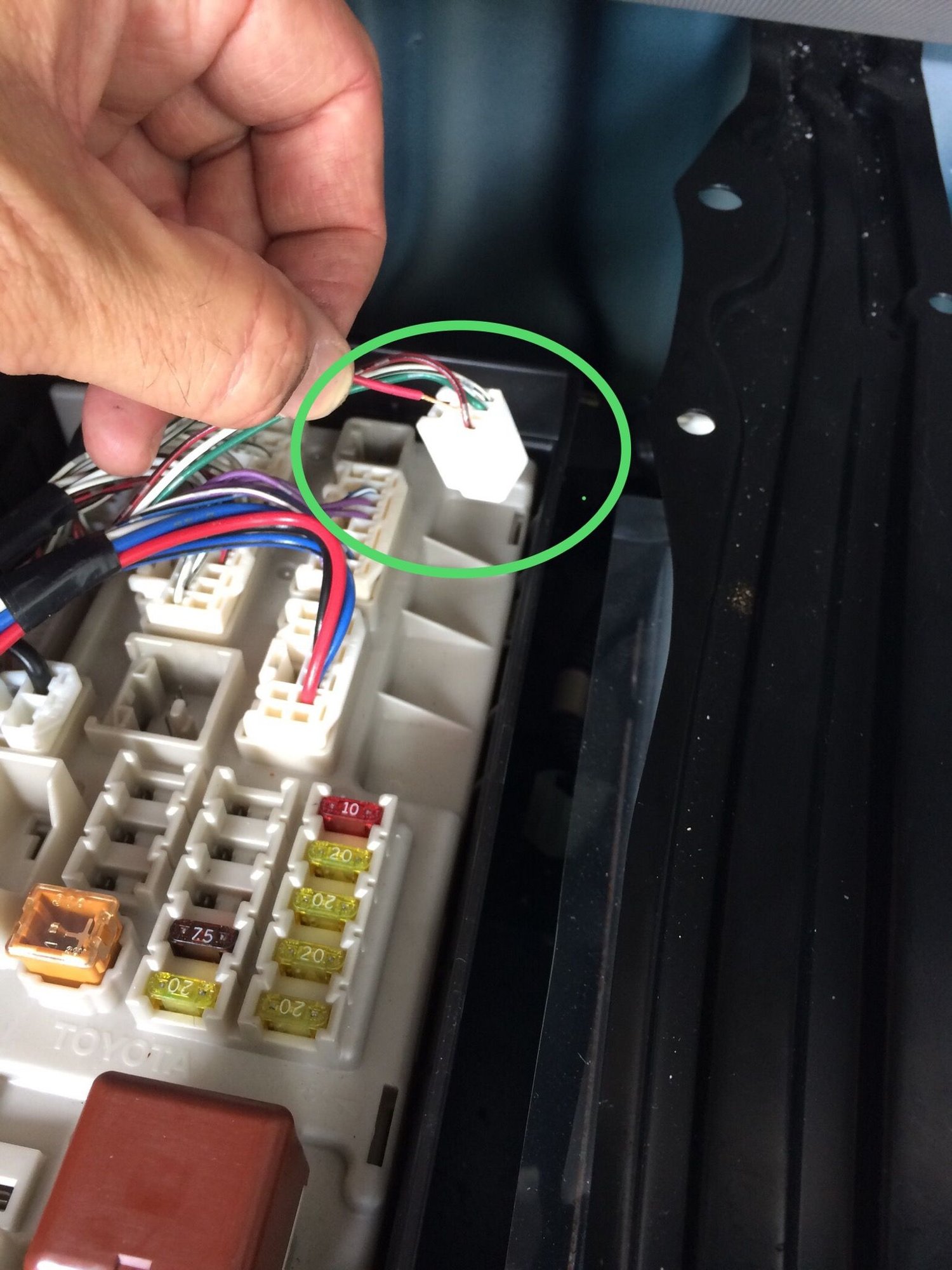

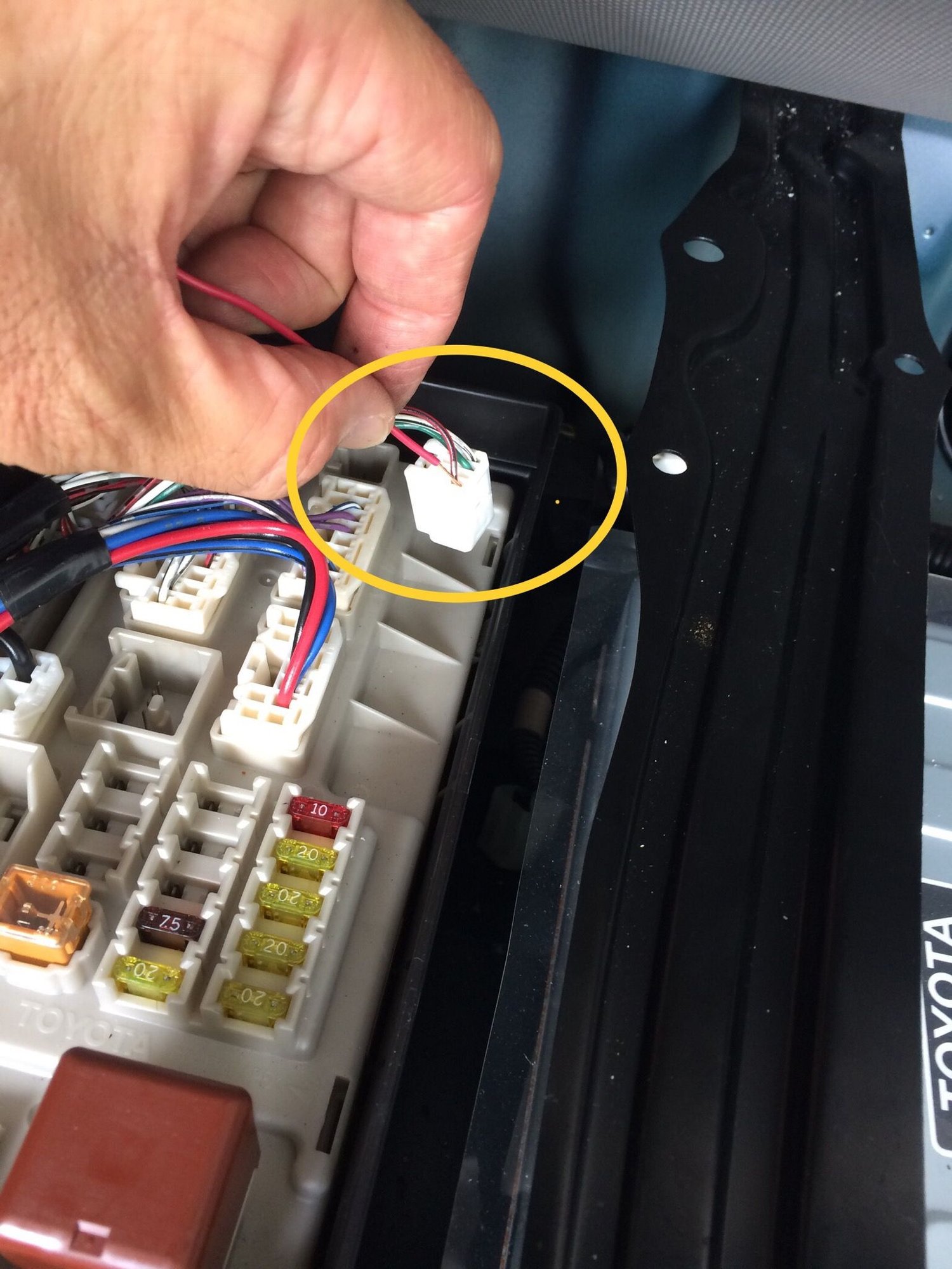

I just added my backup camera (power) trigger wire to the connector in the trunk, it was free and no Cut or spliced wires…has been working trouble free for years.
here is the installation thread with more information
https://www.clublexus.com/forums/sc4...ml#post9074215

I did Bgw70 install years ago with a $12 back up camera from Amazon and have had trouble free usage ever since

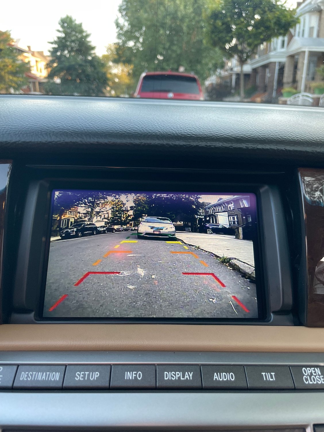

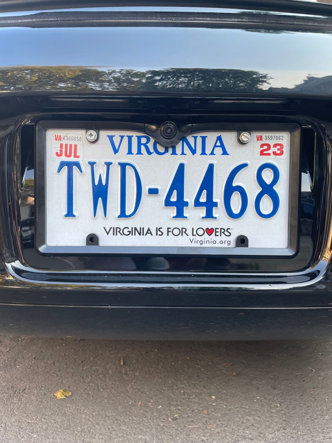

Update on my sojourn to add backup camera on my SC, Mike at NAVIKS thought he had a interface that would connect at the NAV ECU but he wanted to do the install to ensure it worked so I made the drive from MD to Brooklyn. It turned out after attempt that it would not work but after much troubleshooting he tech was able to find a compatible interface to connect at the NAV screen unit. I am super pleased to finally have the capability pic included , I went with the CS CAM 400 and the license plate frame mount that is designed for the camera.
the one issue is that I did not notice until I was back home that the tilt function is not working on the NAV unit, door works fine. I have done some research on it but not sure what could have caused this, if the mechanism arm became misaligned from being jostled around, or if the connectors did not seat properly? I would appreciate any thoughts or ideas before I take anything apart, I need to get a trim tool first and I have seen videos on how to take the NAV unit out, but a detailed diagram of it would really help, does anyone have one or a link?
