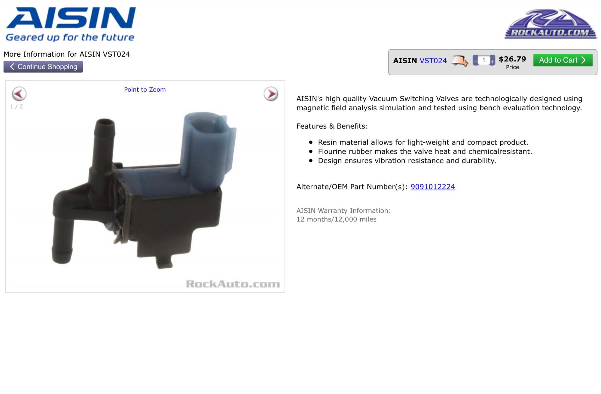

https://www.rockauto.com/en/moreinfo...sn=337&jsn=337
Bgw70, Can I assume the part you list does the same thing as the OEM part 90910-12223 (the number that was on my 2002 model - part also shows Denso part 184600-9140))?
As I searched, I saw the one you list, but it looked like it wouldn't mount up at the OEM location (lacking an integral two bolt hole bracket). I was afraid it was more like one of the other VSV's on the car and performed some other sort of function.
I searched the forum for 90910-12223 and got almost nothing zip back for an answer (except this post). Guess I should have asked, in addition to searching.

I see Rockauto looks to have the wrong parts.

That crazy part 90910-12223 is no longer made by Lexus/Toyota as far as I can find. Mine broke when replacing all the vacuum hoses (to get rid of 0442 engine check light). Someone on E-bay sold 6 of them used for $175, because they must have found this weak spot.
Use Dorman 911-606 for $28. The electrical connector fits perfectly but electrical connector is not in the ideal position but there should be enough slack.
Alternatively, you can modify the valve by loosening the crimp and the metal case and the connector will slide radially to a more favorable position. However, you will also have to modify the bracket that will slide with it. I ground my bracket off and made a removable bracket much like a pipe clamp.
