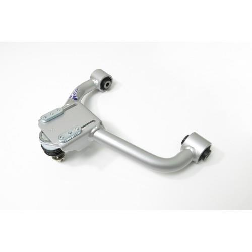

For the rear, you can adjust using your wonderful RCA. However, you need to make sure you change just enough (middle setting?) or your tires will rub the fender again. Check that.
For the front, if you want to adjust the camber, get the Mevotech set of upper control arms ($300). They are pretty much the SPC 72270 rebadge, and SPC sells for $600 (the guy from 2GS section confirmed this)
I think if you can get the technician try to adjust the front closer to -1.0 you should be good to go. You need some negative camber for this car. If not I wouldn't too worry about it. Check your tires every week for uneven wear. This is one of the reason I why I bought 2 expensive tires for the rear and 2 cheaper tires for the front

Mevotech Supreme Control Arms CMS861207
"This Adjustable Control Arm works as Left and Right side, it has to be flip to have it adjust to the side that is required more details on"

Ok, now I'm digging in and I have a few questions:
1) what does that bit about flipping it mean?
2) what increments can you adjust the camber in, or is it a set camber change of 2 degrees by installing it?
3) I notice the mevotech mentions castor adjustment, but none of the others do. Is that specific to that one?
Also, what design is better? The oem looking design of the spc/mevotech or the more square looking design of the godspeed and the manzo which came up in other CL threads? Is any one of them physically superior or is there an advantage?:

1. Both left and right of the control arm are the same, just flip them to install to either left or right.
2. You can go from 0 to +2 or -2 in small increment. You have -1.6 on the left, and -1.4 right now, you can make both 0. BGW70 had this installed on his 02 car.
3. Not sure about that one.
Megan/TruHart/Manzo/GodSpeed/.... they are all rebadge. It seems to me they all come from one manufacture in China or Taiwan.

So if I'm understanding you correctly, you think the SPC/Mevotech is a better made control arm than the megan racing style? Can I see if LCA#2 needs replacing with the car on the ground? What am I looking for exactly?
I'll ask them to get the fronts to -1 if they can, should I shoot for the same on the rear? How do you know what part of the range of "in spec" they should be?

btw, to further confirm that the SPC and the mevotech are the same... the picture on the mevotech website shows "SPC" engraved in the control arm:
https://partsonline.mevotech.com/details/CMS861207
Rock Auto has them for 140 each and a 5% coupon code, so $267.50 for the pair (plus $8 shipping).
