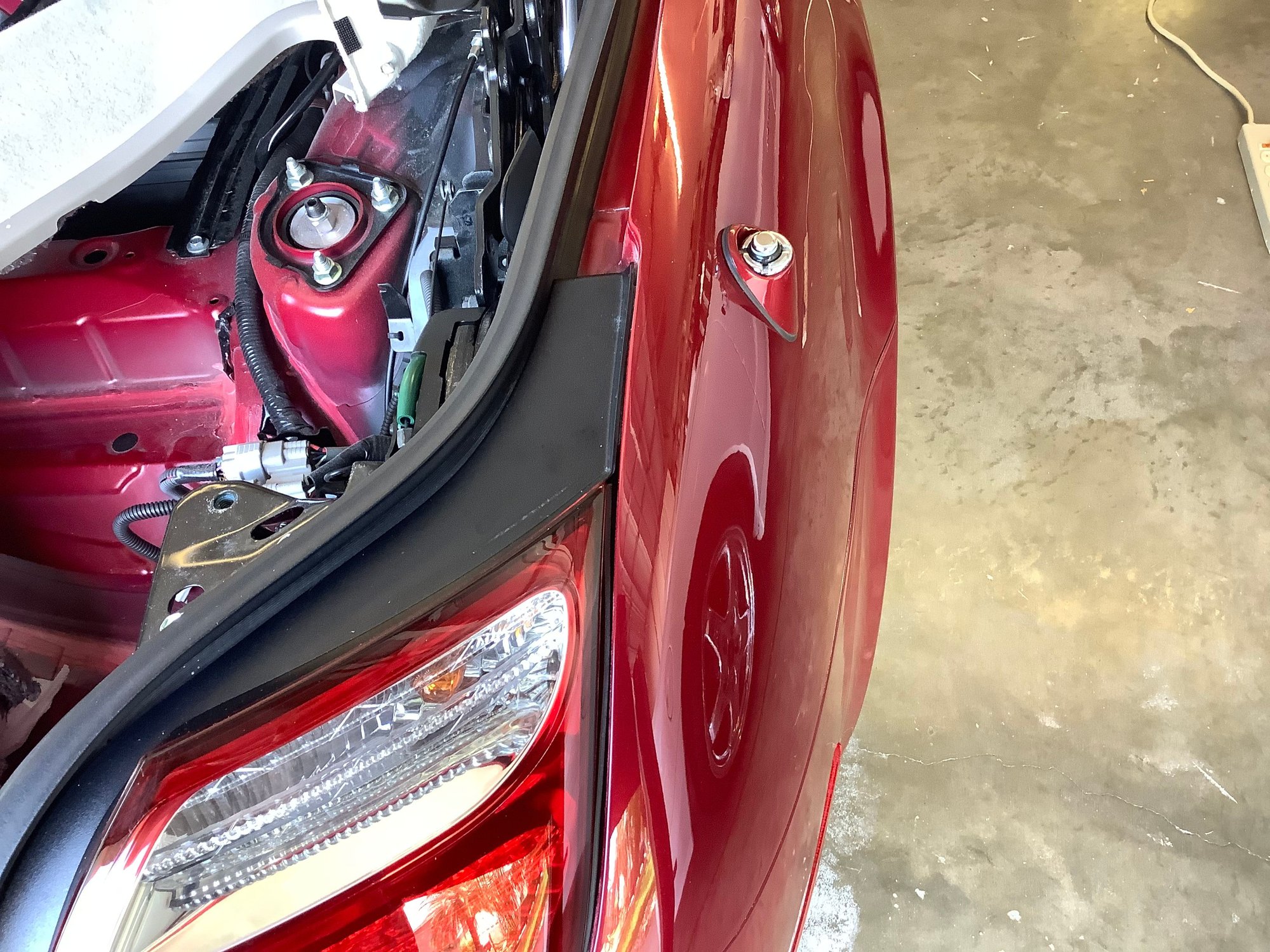

Originally Posted by MattInLex
Can anyone be more exact on the socket size that is used for the antenna mast nut? There are several sizes of these nut sockets available so I want to get the right one.
I'm not feeling particularly warm and fuzzy about taking a screwdriver and trying to tap the nut - slipping off could cost me a LOT more in paint than the $25 socket, assuming I get the right size.
just use a lot of masking tape on everything surrounding the antenna including the little nut. Then the screwdriver tap should work with no risk to your car

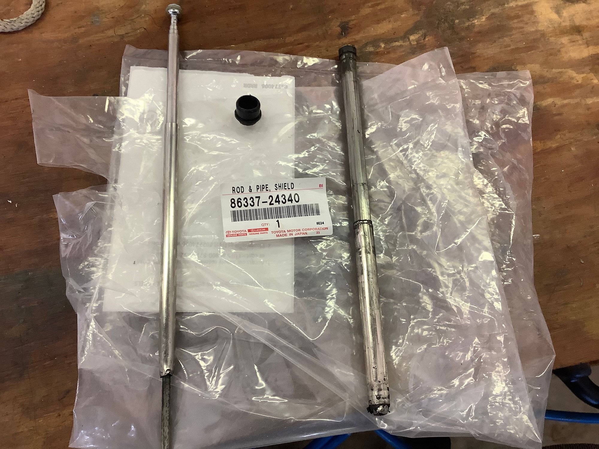

My wife came home from the car wash yesterday and guess what happened? LoL, yep, she left the antenna up, tried to bring it down, but it was too late…it had about a foot left when it got hit.
I planned for this day three years ago and had a spare antenna…it’s an easy task to replace the mast but I took the next step.

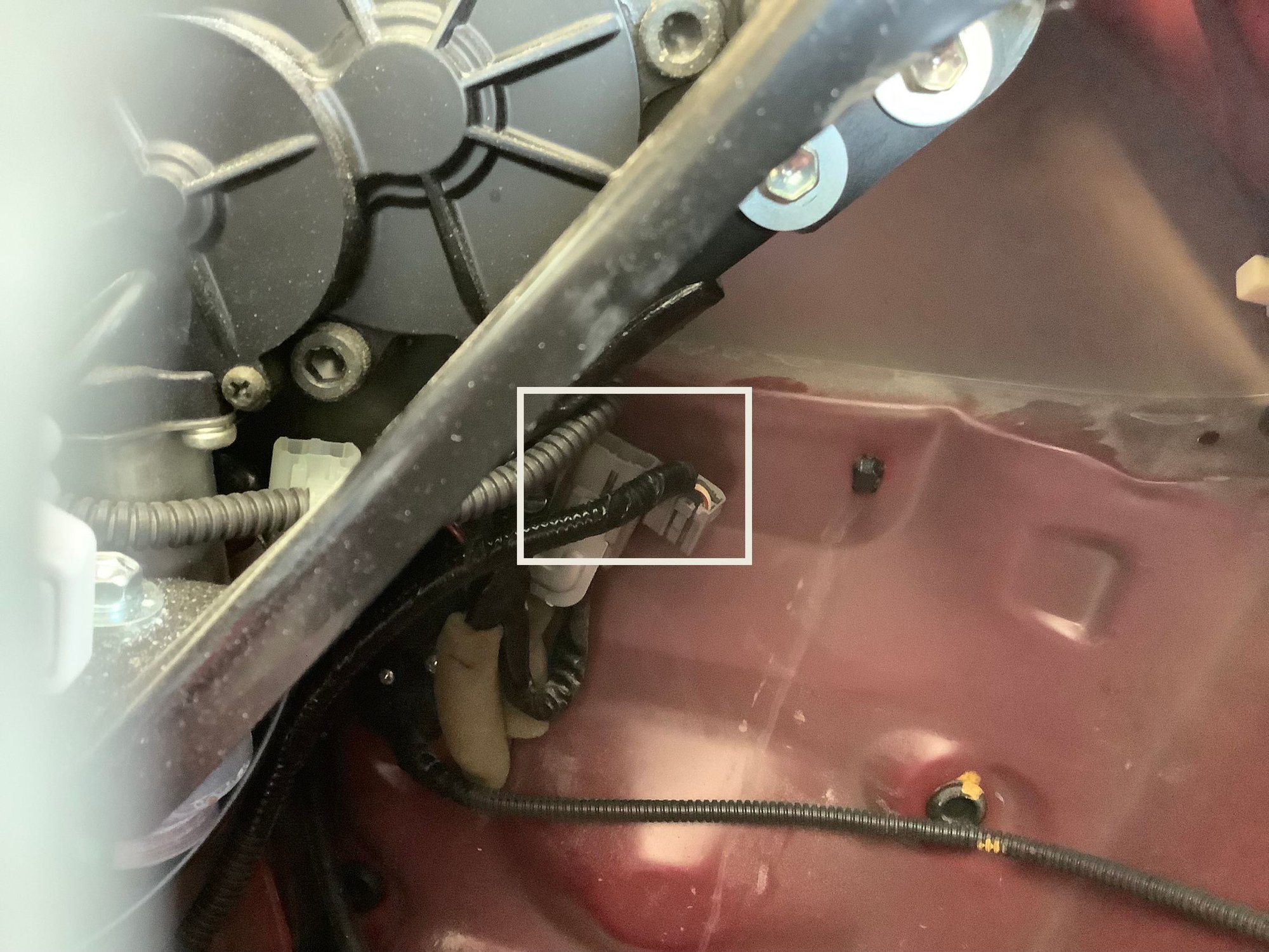

after I installed the new antenna, I unplugged the power connector.
we never listen to AM/FM radio, only XM, pandora etc.
I did test AM and FM with the Antenna up and down. AM really didn’t work with the antenna down but FM was the same, up or down. FM can use the windshield antenna.

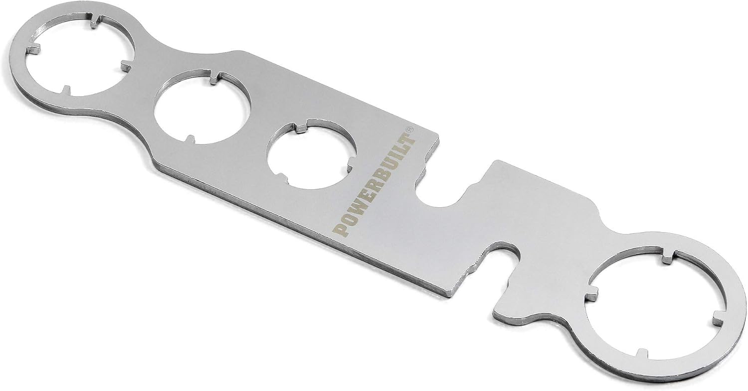

With all the talk about removing the nut without harming the paint...Shouldn't you all have one of these?...
I got one in a cheap car stereo tool kit decades ago. This one is available on Amazon for $13.
