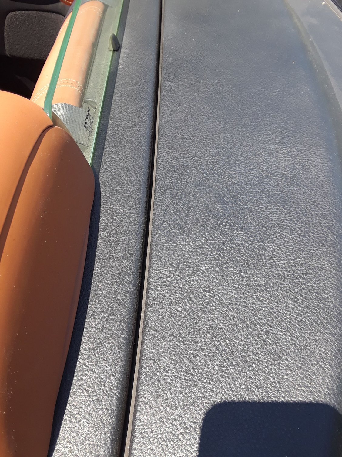

I finally got around to my package tray bubble fix. Came out excellent. And less than five bucks.
I went to the pharmacy and bought a package of diabetic syringes. Poked the needle at the end of the bubble and used it to suck the air out. Compared to the first photo, I'm over the moon in how well that simple solution worked out.
Paul

Nice job Paul. It looks much better. That was a big bubble!

you do great work Paul. Well done. Yours came out so much better than mine.

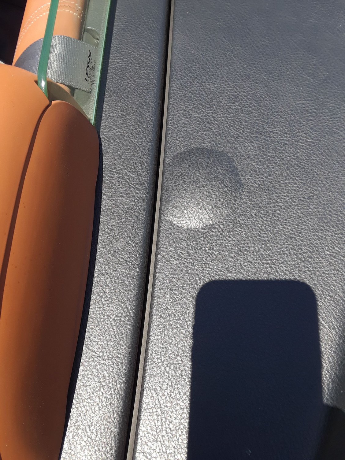

My bubble came up last summer or fall and I've been waiting for a day like today (fairly warm and I had a few spare moments) to try to remove it. So the pictures are the before and after. I used an old syringe to poke a hole and suck the air out. I tried to roll it flat but that didn't seem to go anywhere. So I put a piece of flat wood on top of it and a 2 1/2 lb weight to see if over time it will flatten out. I even tried rolling it flat with a 3" roll of tape and heating it up with a hair dryer but it never improved past what the picture below shows.
(I also disabled my top by retracting the "keep out" cover in the trunk hoping that will remind me to take the weight off before popping the top again.)
This is the bubble when I started.
This is the bubble when I finished. As you can see, the outline is still there with a slight raised area around the edge. I'm hoping that with time and a little weight the edge will flatten out.

My bubble came up last summer or fall and I've been waiting for a day like today to try to remove it. So the pictures are the before and after. I used an old syringe to poke a hole and suck the air out. I tried to roll it flat but that didn't seem to go anywhere. So I put a piece of flat wood on top of it and a 2 1/2 lb weight to see if over time it will flatten out. I even tried rolling it flat with a 3" roll of tape and heating it up with a hair dryer but it never improved past what the picture below shows.
mine actually looks just like yours...I have a spare package tray but it is a PIA to change...

I was thinking that maybe I should use adhesive like you did BGW but since your still shows the outline, I think that I'll see how this route goes first.
However, yours does look a little bit flatter than mine but maybe that is just the freshly stretched leather. I put some leather conditioner on it hoping that will help encourage it to go back to its original shape. Time will tell. I considered laying the 2 1/2 lb weight directly on the tray and in the sun but decided that the sun could iron an even larger circle on the tray from the weight (or worse). So I left the wood in between them.
It may be key to catch the bubble early in its rise to reduce stretched memory.
