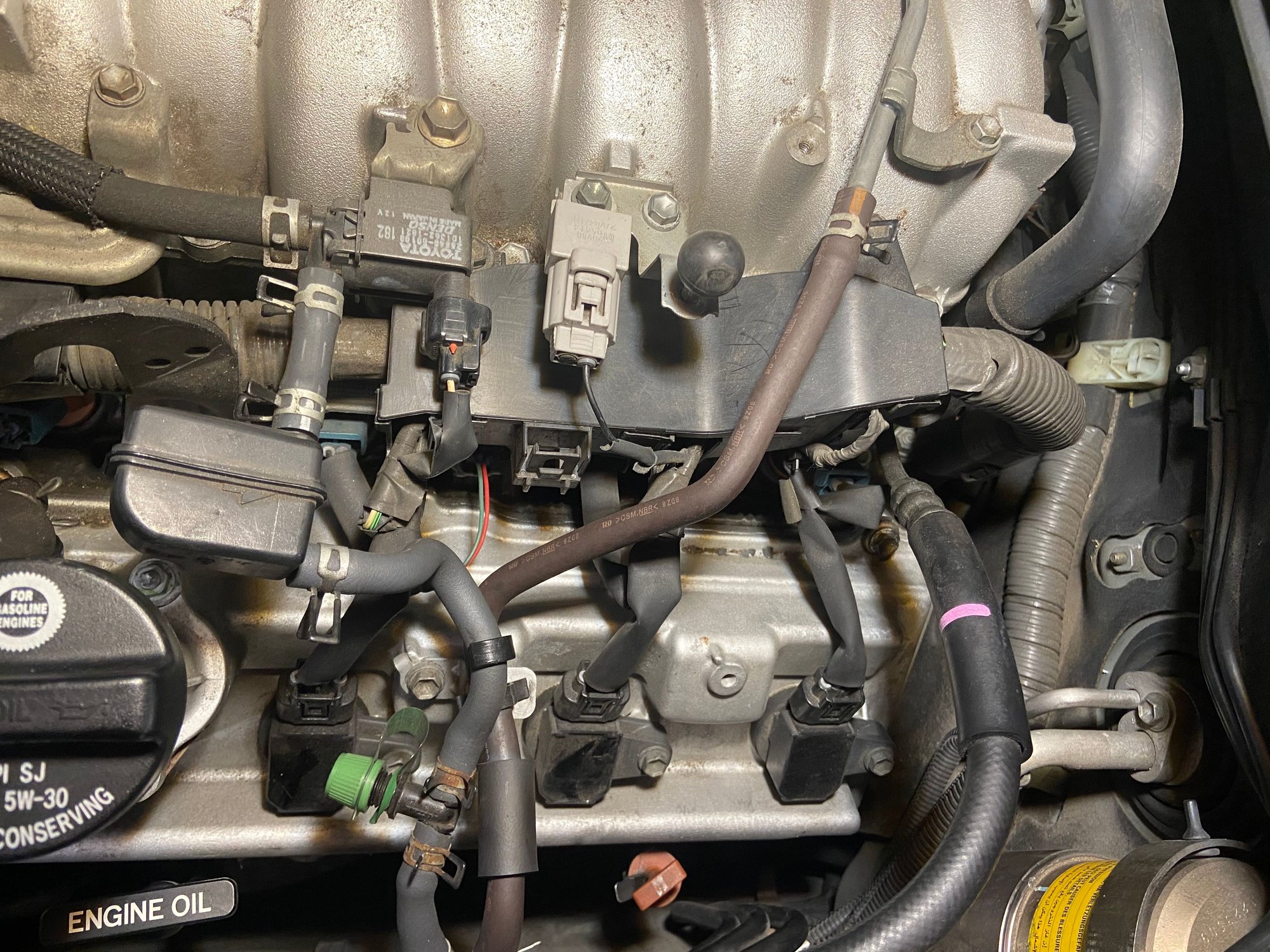

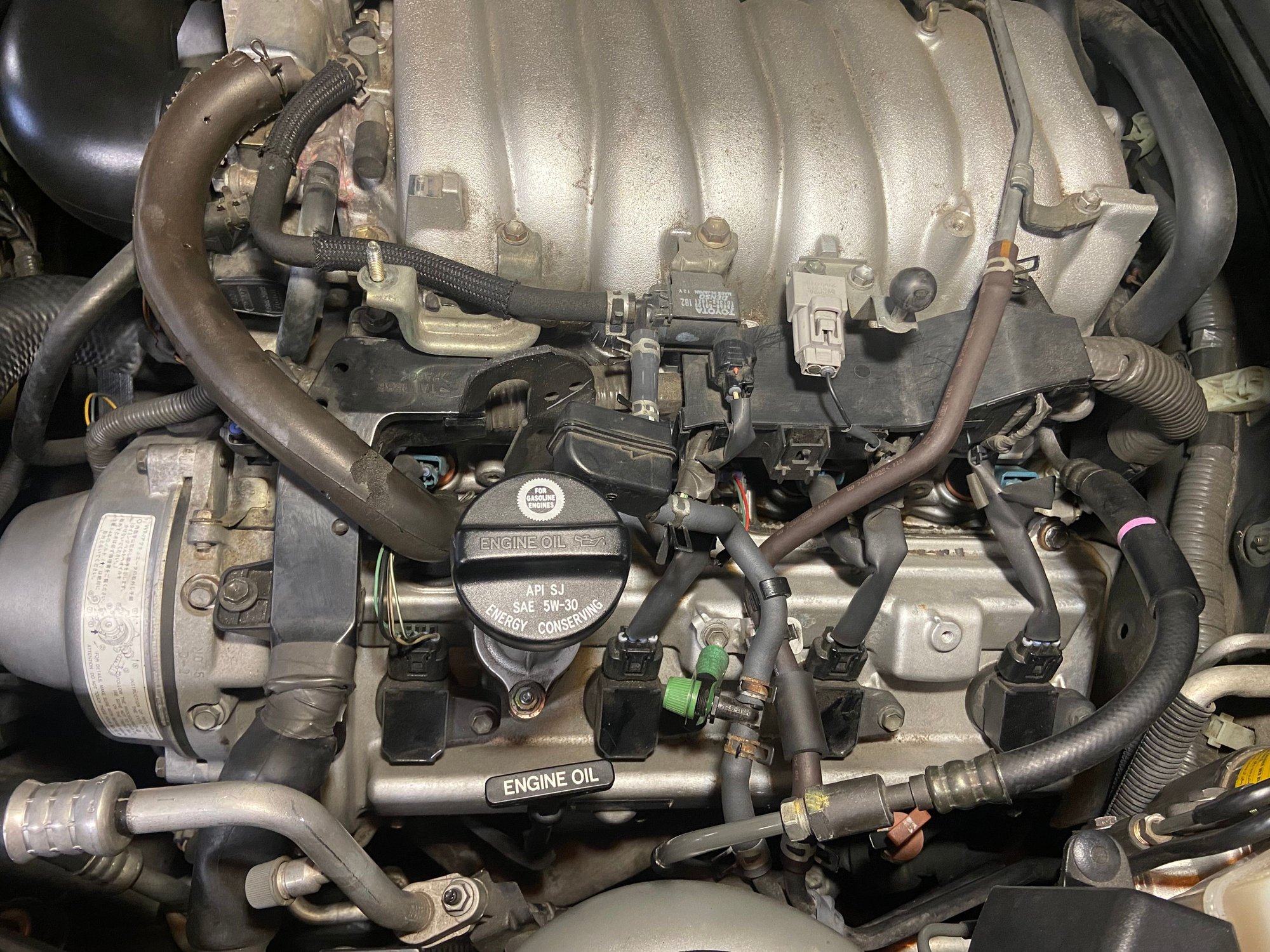

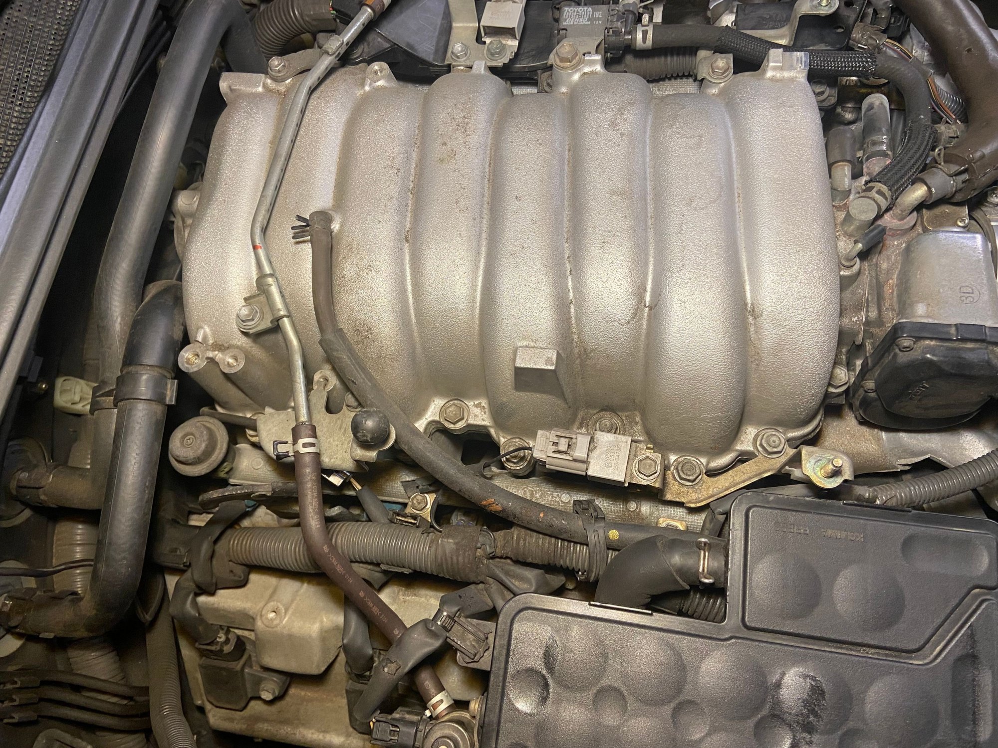

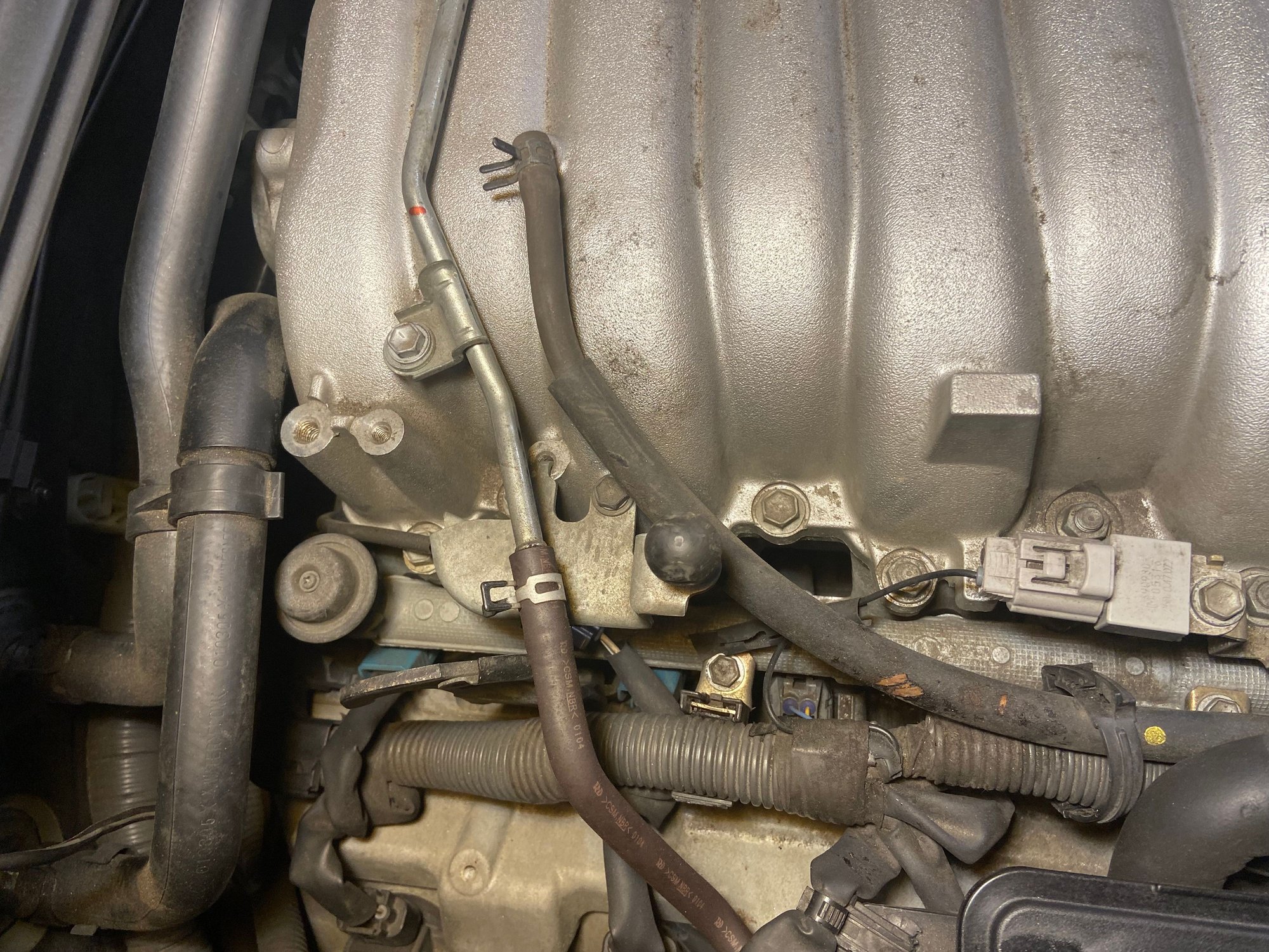

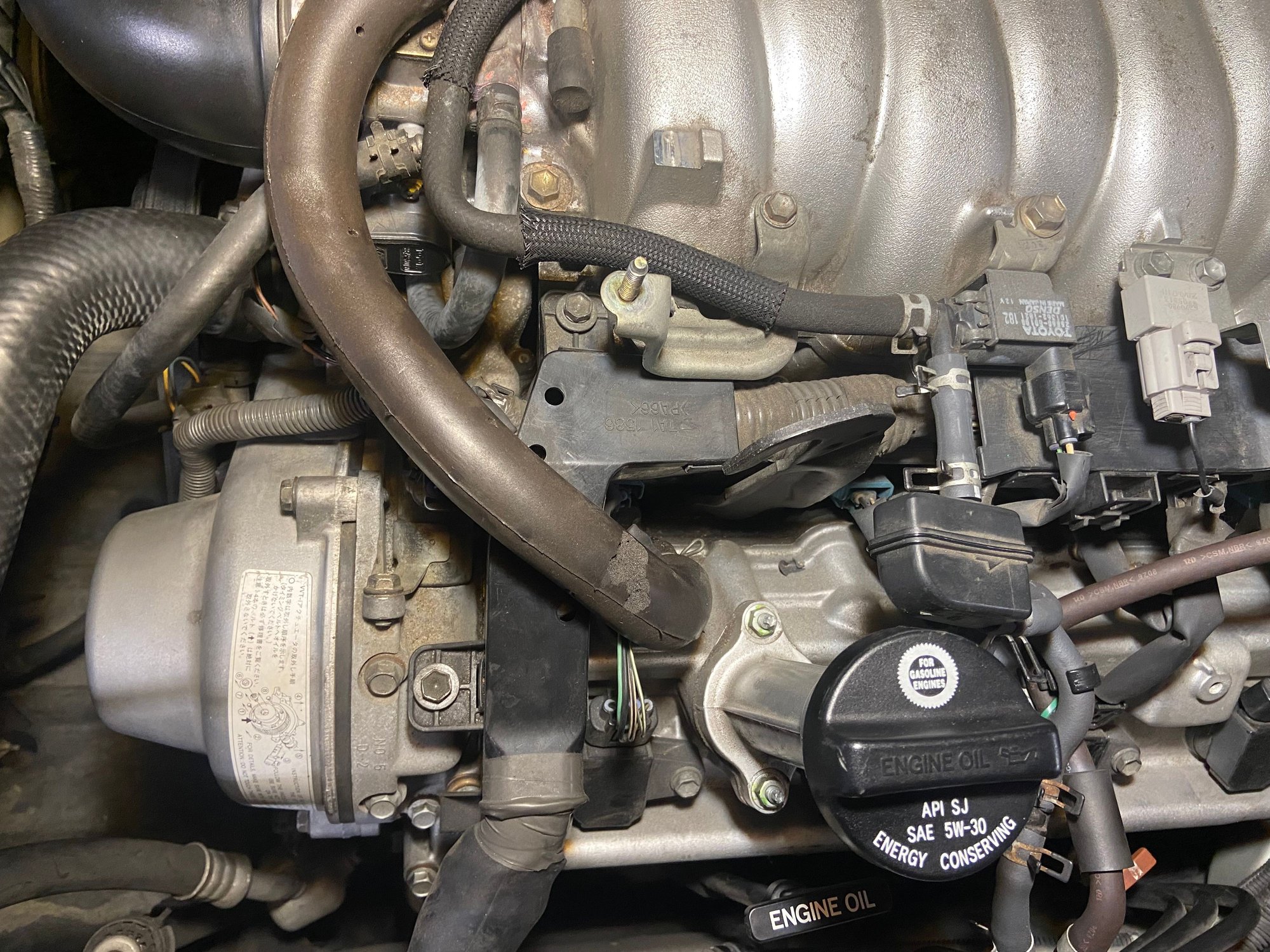

so i was finally starting to button stuff up, im pretty much working by myself here but i dont have any pictures without a giant hand in the way to see how things go. so i come to you guys humbly to see if you can snap me some pics of your 2002 sc430 under the hood the passenger side is mainly buttoned up but as for the drivers side i am definitely gonna need some pictures to see how things are supposed to go, btw, the starter is changed so are the knock sensors and they are rewired to the appropriate length. bolted the intake back on started plugging things in and my old phone broke with all the pics i took so if anyone has a stock setup under the hood it would be greatly appreciated. ANY HELP would be appreciated cause once this is all plugged back together she should start right up thanks and sorry for thee bother guys ive had 2 deaths in the family which kinda threw this project into i cant deal with right now pile.
drivers side im having issuses with lining up the wire loom.
same drivers side. need stock pic of.
same drivers side...
front of driver side im having trouble remembering where everything is supposed to go.
this is the passenger side where im having trouble figuring out where the 3 connectors go, the fuel injectors are all lugged in on this side.
these two elusive parts get bolted somewhere the one with the ball goes somewhere on the drivers side i think.

i hope these pics of my engine bay help. i’m not a wrencher, i change my oil and that’s about it, so hats off to you for doing all this. my stock 2002 just hit 281k on easter.
the elusive parts with the ***** go on top of the manifold and secure the back of the engine cover. the engine cover has clips that snap onto those *****. the front of the cover is secured with 10mm nuts.
driver’s side…
and passenger side …
good luck! i hope you get up and running soon.
