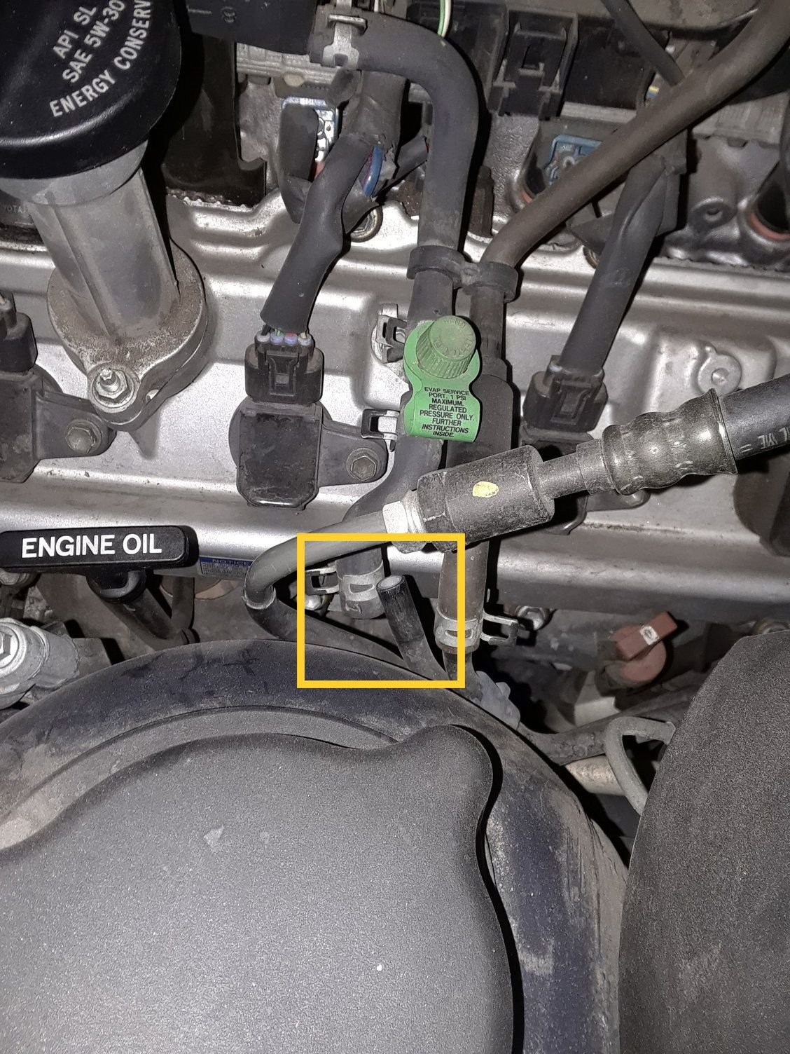

remove the cover and carefully look and touch each line starting on the drivers side.
those are the most common and don’t focus on the fuel tank until you’ve confirmed the vacuum lines in the engine area.
https://www.clublexus.com/forums/sc4...l#post10659592
Check the drivers side first.
