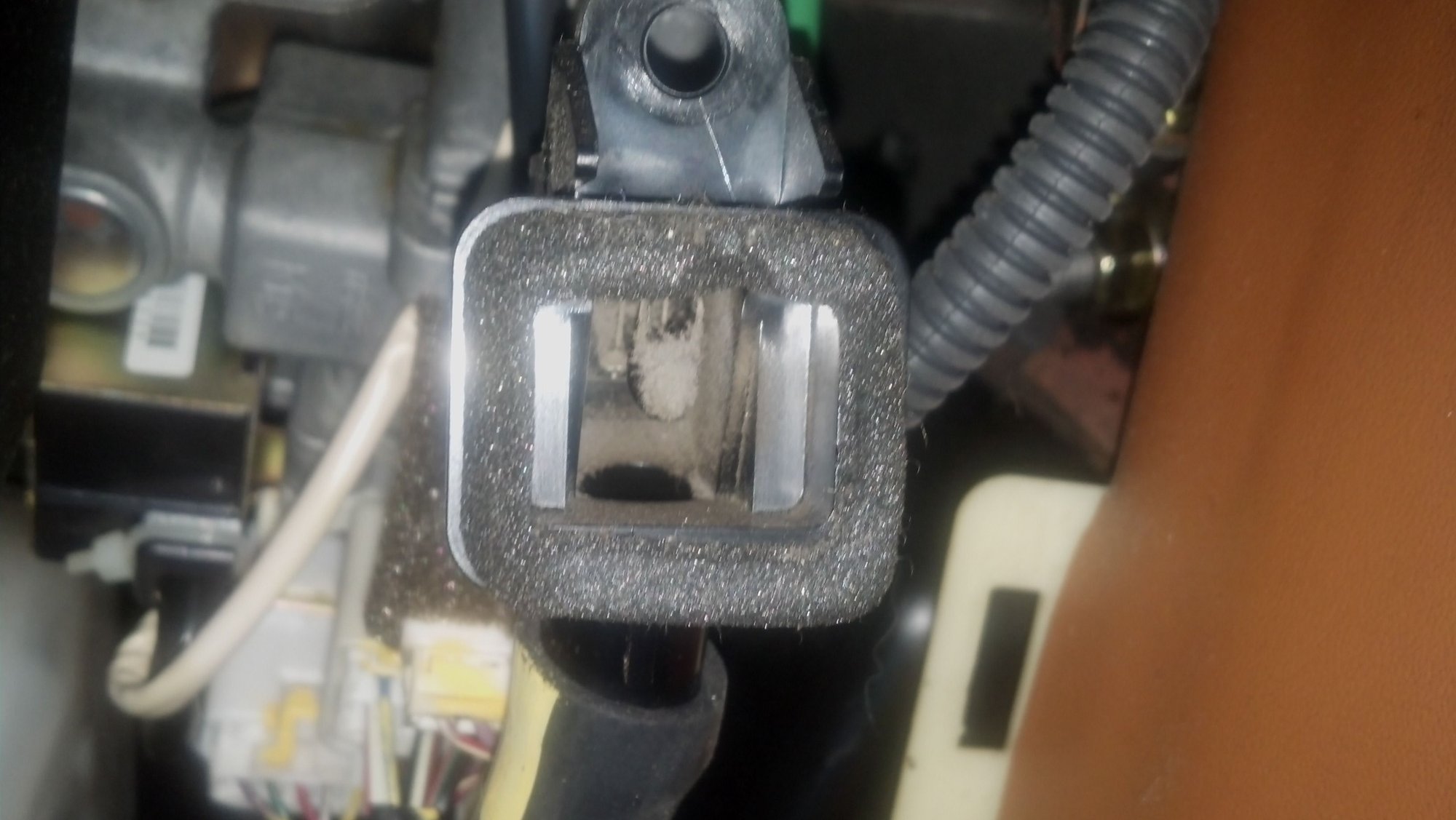

Check the interior temperature sensor…it’s right in front of your right knee on the lower dash…it gets full of debris…pull the lower dash for access. Very simple
i am not saying this IS the answer but it could contribute to the issue.

Good advice from Bgw70. I think Paul is probably right about the ambient air temperature sensor having an issue. If your temperature display isn't reading properly, that would be the likely cause. I believe this ambient air temperature control is the first product you referenced. The product from Coollex is a smog detector. Its purpose is to sense products of combustion. If you are sitting at a stop light and this device detects excessive "fumes" from adjacent vehicles, it will turn your ventilation system from fresh air intake to recirculated air. In that way, the system won't pull in the fumes to the passenger compartment.
The ambient air temperature sensor is located just in front of the radiator and at the bottom of the radiator. See the photo below. As you mentioned, this temperature sensor relays information to your temperature display and also affects the performance of the AC system. I'm not completely sure, but I think the engine management system also uses this input. It doesn't sound like your sensor is so far off it would cause an engine issue. I think the retractable roof system also uses this temperature control. I may be wrong, but if the outside air temperature is very cold, your retractable roof will not operate.
Before buying the sensor, you may want to check to see if this sensor is dirty or has some other issue.
