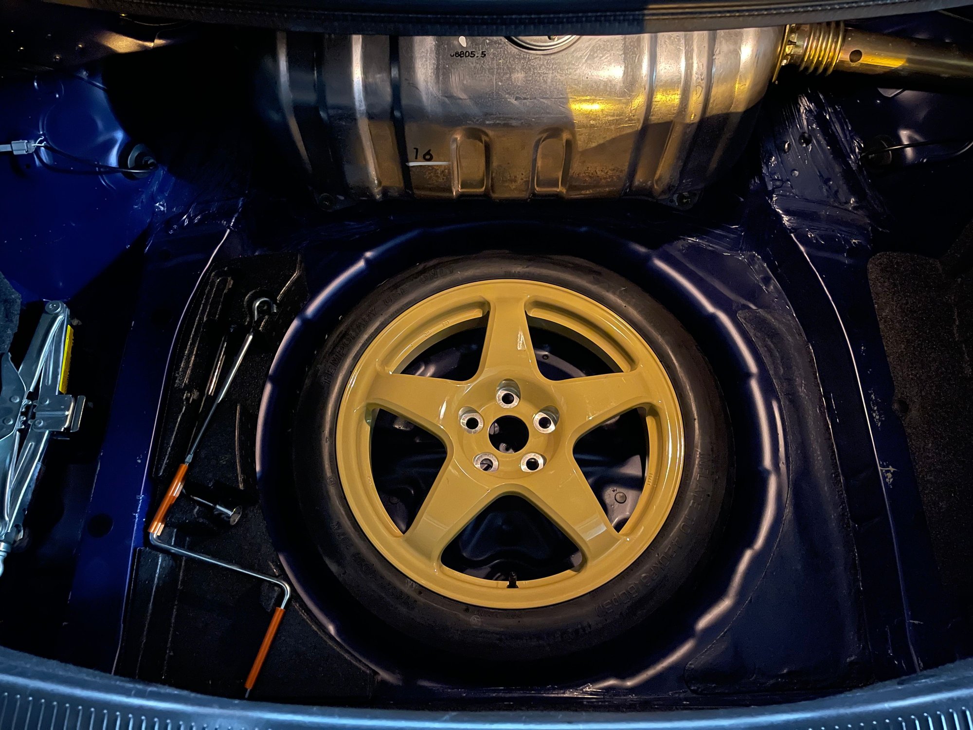

In preparation for my BBK I decided to pick up a suitable spare tire. I’m sure many people who install a BBK on their car don’t think about it until they’ve got a flat, so I wanted to avoid that egg on my face moment and swap out my spare for one that would fit over the larger calipers and rotors.
Enter this gem I found on eBay. I did a fair amount of research, looking for a lightweight, aluminum spare which would be large enough to clear the calipers. I decided on the factory RC spare which fits both RCs with F-Sport package and RC-F with their Brembos. It weighs about 32 pounds compared to the full-size spare which weighs nearly 50 pounds! And it looks kind of cool.
It’s sitting in there wedged for the moment. It JUST fits in that wheel well. I need to figure out a tie down solution, as the factory threaded cap doesn’t work. Because this is a skinny spare, there isn’t enough threads and the shaft is too long for it to reach low enough to tighten down on the wheel. I may cut it to size and have threads put onto it, or look for another car’s which is shorter. We’ll see.

Excellent find! Most people don't think about this, no. I bought a used Supra MKIV TT compact spare many years ago for just this purpose since the factory SC full size spare will not fit over the TT calipers. At this point I really need to get a new compact tire for it to replace the ancient old one that it came with. The same compact spare was also available on some model years of the SC430 that didn't originally get optioned with "Run-Flat" tires from the factory.
I'll have to make a note about this RC spare since it is proven to fit in the SC's trunk!

Craig, you can’t beat it man. I paid $180 plus shipping for this thing and it’s brand new. It was listed for $250 and I offered $150 and went back and forth a little. The other spares I found online were double this price.

That RC spare is a smart choice. You got a good price on it too. I’ve been thinking of what spare would fit in the trunk. I currently don’t keep one in my trunk and keep one of my LS430 18’s around as a spare. Would an OEM 1992 SC400 16 inch wheel and tire fit in the trunk space?
