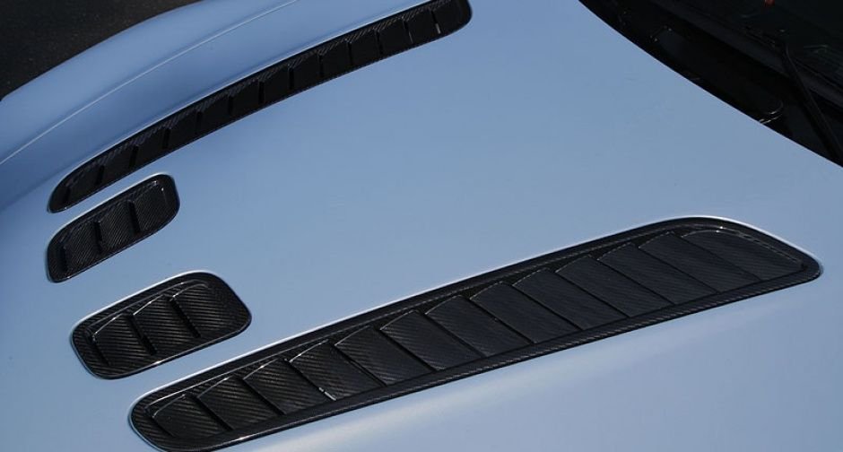

I was thinking of using this:
Advan Carbon modular hood vents
I found Advan Carbon while reading other threads here and found that they will do custom hoods for you. I was thinking of asking them to add these vents which they also make, into my hood with no rivets or screws for a cleaner look. I want them cut in and resin’d with the hood. I would then paint the hood RSP but leave the vents carbon fiber. Similar to this:
Aston Martin V12 Vantage S
You see where I’m going with this, right? Our hoods are nice and flat too, so it shouldn’t be difficult to fit those vents in there.
I plan to approach them on integrating some kind of power bulge as well, but I think that’s where they’ll tell me no. Too expensive and too difficult for a one off.

I have to respectfully disagree with you on NACA ducts The R34 Skyline GT-R's incorporated one into their hoods to cool the turbos and it was rather brutalist-elegant in my opinion like the rest of that car. Perhaps the entire R34 GT-R is an acquired taste but I've always liked how blunt they are aesthetically. The Lamborghini Espada also famously used NACA ducts as did the 1969-70 Shelby Mustang GT350/500. So did the rather cool looking 1991-1992 Isuzu Impulse RS (1.6L turbo AWD rally car) with its single offset NACA hood scoop feeding its top mount intercooler (aside, I almost bought one of those in pristine original condition with only 50k miles. I couldn't swing it at the time and I'm still kicking myself for missing that one).
I have long considered adding a single paint-matched NACA duct to my SC's hood on the turbo side. What has stopped me is not having a clear idea of how the R34 Skyline's hood ducting worked and how it diverted rainwater away from the engine or if it has any sort of removable block-off. If there is such a setup on the Nissan I would want to recreate it on the SC's hood.
However these cars do very well in general without any hood venting so it absolutely does come down to the aesthetic *you* are looking for
I'm very familiar with Advan's products. I think that's a good route to look into. The hood bulge as a one-off design shouldn't be so crazy. No more than adding carefully placed vents I'd think. Even so, what I'm seeing so far from the Motion.tv people is that they've managed to keep their new intake design well under the MKIV's stock hood limitations.

OK, let’s settle this NACA duct debate right here, right now
We agree, that it looks good on certain cars. I think the cars you’ve mentioned all had an aggressive look to them and generally sharper lines than the SC. I guess I question their aesthetic with out curvaceous bodies. Your R34 example was convincing though, cause I love me an R34 GT-R!
Having said that, I think we can agree that my idea to use those long and slender vents will fit and flow nicely on our long and sleek hoods.
