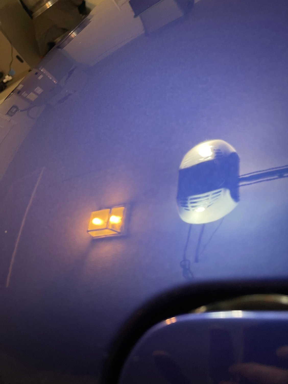

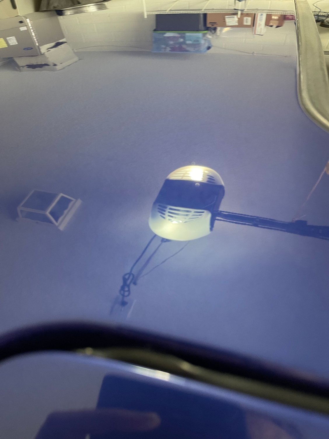

Yesterday I took a paint gauge to the car and verified that the hazy paint was only contaminated clear. I spent the evening compounding the car, but my foam pad didn’t remove all the swirls and other imperfections, so I’ve ordered a microfiber pad and will give it another go, soon. Here’s a couple photos after my detailing efforts:
In the morning light
Before
After

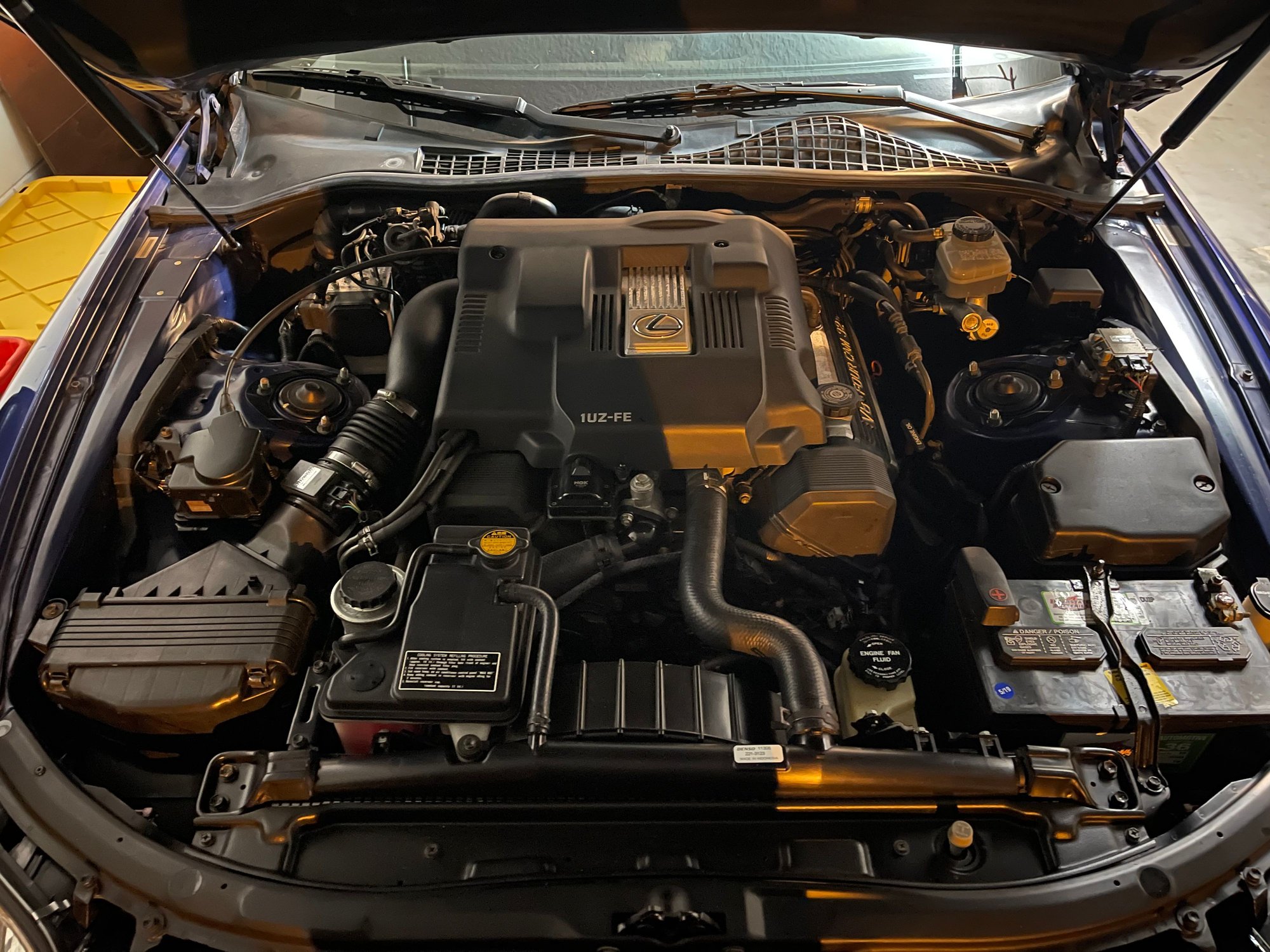

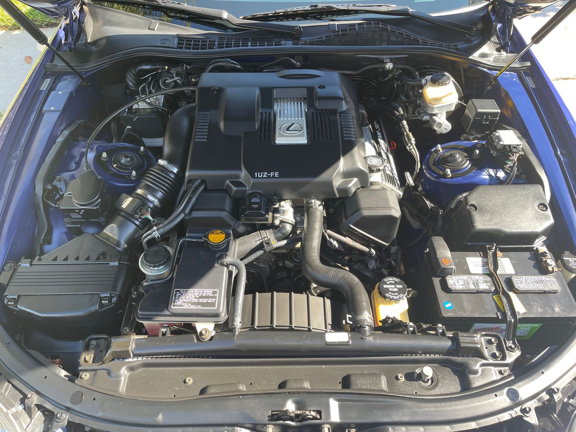

Just an update on my work. Had some time this weekend, so I decided to get the ball rolling on my maintenance/revival on the SC. Saturday I did an oil change to my daily — a 2012 Camry — and did two to the SC.
I first pulled the drain plug and took a sample of the oil to send to Blackstone. They suggest to take a sample from the middle of the change, but I needed to preserve the oil level so I let a couple seconds of oil go and then collected my sample.
Next, I poured in Engine Flush by Liqui Moly. I peeked into the heads through the oil fill cap when I first got the car and saw a little bit of deposits, so I wanted to try to clean that up. In the fluid goes and after 15 minutes at idle, it was time to drain the oil. The previous owner used Dino oil (yuk) so I’m making the switch to synthetic.
But, I wanted to make sure I got out as much of the Flush and old oil as possible, so I filled up with 0w20 — cheapest I could find at Walmart, called Supertech — and idled the car for another 15 minutes, with a couple 30 second intervals revved to 2,000 RPM, and a couple quick little 4,000 RPM revs, to make sure it was circulating everywhere. The logic with the 0w20 is that it would get into every little nook and cranny for the purposes of flushing the engine. Wear was not a concern for a super short interval/light load operation like I was doing.
After the 15 minutes, I drained that off and replaced the Fram filter I had just put on there for 15 minutes, with Liqui Moly 5w30 Top Tec 4200 synthetic and an OE Toyota filter. This was recommended to me after consultation with Liqui Moly themselves. Side note: it’s very annoying where Toyota decided to place that oil filter. It’s impossible to not make a mess with those power steering lines in the way! Not to mention the undercover, but I digress…
After the oil change, I drained the ATF and filled with, you guessed it, Liqui Moly. I used their recommended Toyota Type IV replacement; they call it 1200. Two, 1 liter bottles just about did it.
While I was down there, I also replaced the transmission mount. Every time I shifted into gear the car would lurch and make a loud clunking sound. After replacing the mount, it’s definitely been lessened, but it’s still there. I hear the diff kind of go ‘thump’.
While I was down there, I cleaned up as much of the two pans as possible, both of which were caked in oil. I know the car has a power steering leak, but it must have been leaking for years, or it’s also got an oil pan leak. We’ll see. For the time being, I added Liqui Moly power steering stop leak to the reservoir. Worth a shot.
Now for the big stuff…I decided Sunday would be a good day to knock out the plugs, wires and coils. I bought everything from Rock Auto; Denso wires and plugs (iridium) and NGK coils. I read about the job and it seemed easy enough. Not so. The driver’s side ignition coil is a nightmare. Doesn’t help that I am blind and couldn’t find the second bolt for the bracket, but nevermind. I ended up stripping one of the screw heads and created a whole lot more work for myself, but hey, that’s why I’m an amateur.
In the end, I got it all done…TODAY… hours and hours invested in it. Along the way I cleaned up every part I came into contact with. I’m convinced I’ve reduced the weight of the car by at least a pound, with all the dust, grease and grime I’ve removed.
While the intake was off I also cleaned the throttle body and the MAF.
I noticed when I first got the car that revving in neutral produced a shutter and vibration on deceleration which to me smacked of a misfire. After the work today, vibration is gone and she purrs like a kitten. Pleased with the outcome but it was very tedious and back breaking work, hunched over the car like I was.
Im realizing just how out of practice I am. I haven’t done serious car work since my RX7 a few years back and it showed. I’m getting back in the swing though. Best part is, despite it taking two days, probably about 10 hours total, I had no leftover bolts! Cheers to that!
I’m too ADD to take photos throughout the process so I’ll just show you a plain Jane engine bay photo when j was finished:
Nick

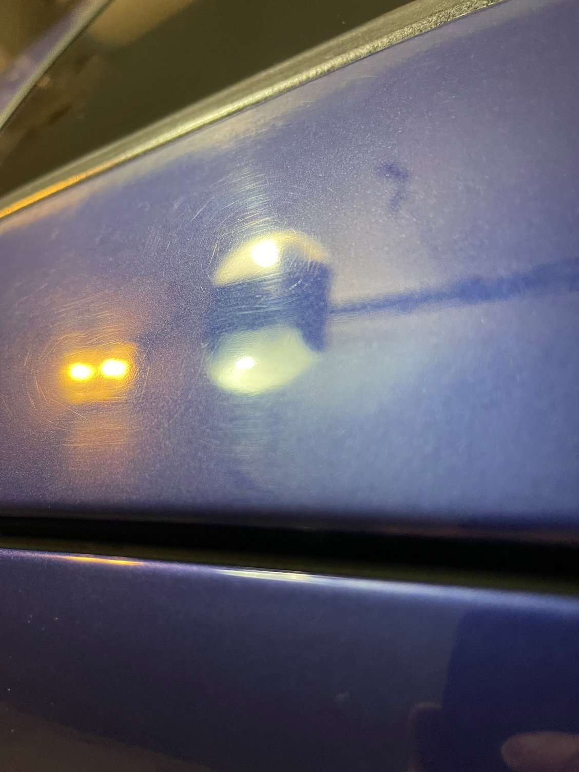

Well, I finally got around to the paint correction. Compounded with microfiber pads this time and it removed defects nicely without taking off too much clear. I’ve come to the conclusion that the RSP paint is very hard. It took considerable effort in certain spots and after testing with my paint gauge, barely removed clear. I am still averaging about 4.5-6 mils thick all over the car.
A few pictures for you guys:
Washed, right after purchase
After compounding with microfiber pad
This was after the compounding stage, before polishing. Lots of depth and clarity!
After that I polished and then ceramic coated with Avalon King’s Armor Shield IX ceramic. I used it on all painted surfaces and the black plastics like the windshield cowl. Huge difference there! But I didn’t take before/after shots.
